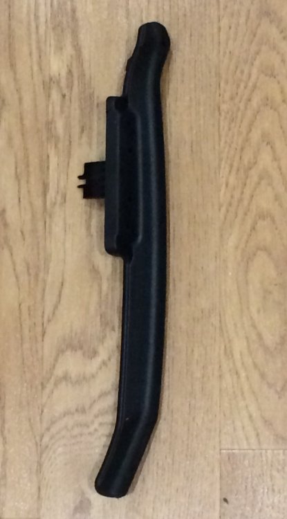

The 1.4 Kodiaqs passenger side rear, door protector has started falling off, when opening or closing the door.

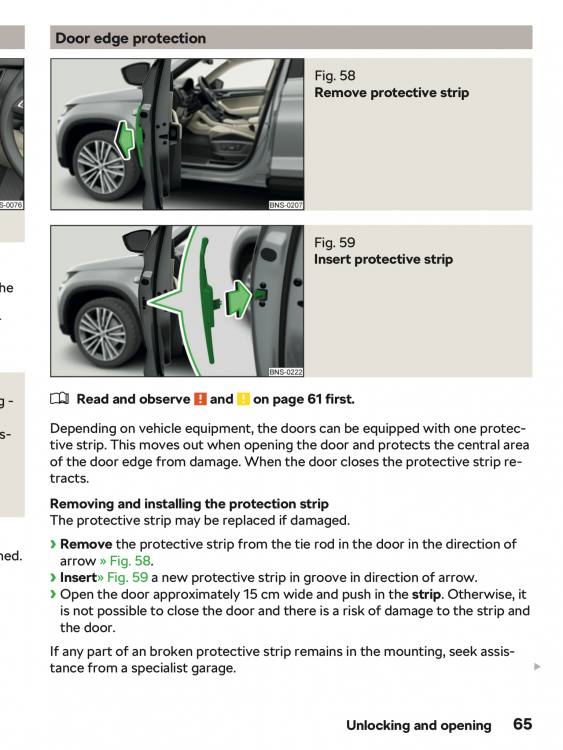

I’ve tried refitting it as per the manual and it then works ok for awhile, before either falling off, or not retracting properly.

Snagged the RH rear door thingy this evening on my jacket and ping - wouldn’t retract.
Tried numerous times to remount it, compared with working one on LH side, but no joy.
It seems to click into place and looks ok, but just refuses to retract when the door closes.
So I had to pull it off and throw it in the boot. The dealer can have a go at its first service.
I’ll have another look in daylight. I think my strip is still in one piece.
Nothing appears to be broken. The outer strip can be re-attached to the slider, but the internal mechanism just doesn’t actuate the way it should as the door reaches the almost closed position.
So the bump strip remains on the outside as the door is about to be slammed shut.
So I had to remove it for good.

The issue I experienced was very similar. They mechanism would not fully retract. I believe the plastic nut on the actuator on the door hinge side can be screwed in and out to tension the return spring. At least that is what my dealer did to try to remediate mine. It solved the issue for a day or two before the mechanism would not retract again. I considered pursuing remediation however the next step was to replace the mechanisms. The act of popping off 4 door trim cards to replace them concerned me more with possible damage/fit/rattles when putting it all back. I decided to remove and forget them for now. Appreciate Skoda should remediate and may pursue a fix at next service. For now with my kids potentially catching them and the potential for them to cause some damage or marks to the door frame I have chosen to remove.
Edited by jasoncmiles
It is true that the actuator near the doors hinges can be adjusted, which should determine at which point during the doors opening and closing sweep the protectors retract or eject.
But, get it wrong and I can imagine a situation where the protector gets wedged between the door and the body.
