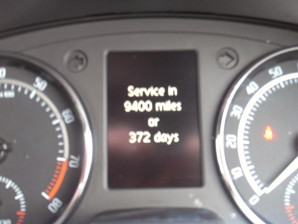

Just had the oil service required in 1400 miles warning pop up. The vehicle has done 8050 miles and i was wondering do i use this as one of my free services or do i just pay for the oil and filer and wait for the main service? I am leaning towards just paying for the oil and filter service, has anyone elses oil service come up yet?
So the Dealership changed the Variable Service that your car was on from the factory to Fixed Servicing, 9,400 miles / 372 days.

Pretty sure it is variable as I remember asking them several times if it was and we do we do about 10 to 14'000 a year in the main car.
Pretty sure it is not, you posted what it says.  Tell them to do this one free for being chancers.
How many days does it say until the service because when it was changed they put it to 9,400 miles / 372 days which ever comes first.

Variable Flexible servicing was what your car came with and long life oil and a fitter or technician changed it to fixed at the PDI.
So the 'Sensors' for oil condition was discussed in another section last week,
thing is your Karoq is on Fixed Servicing.

Update having spoken to my dealer they didn’t PDI the vehicle it was done by the original dealer  I new the vehicle was from group stock I bought it this way as I didn’t want to wait for a long delivery and the only thing I compromised on was the colour,
 My dealer has agreed to an oil and filter and will re set to variable servicing

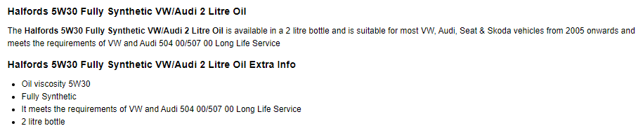

It was 5W/30 so ok I think.
5W30 is the right viscosity, you should just check it meets the VW 507.00 specification (mainly low ash content for use with diesel particulate filters).
The VW 507.00 will be printed on the container somewhere.
Don't worry if it isn't, for topping up it won't have any adverse affect.
If you bought the dedicated "VOLKSWAGEN AUDI" branded container, it will meet the VW 507.00 specification, so all good...

Yeah that's the one thanks.
