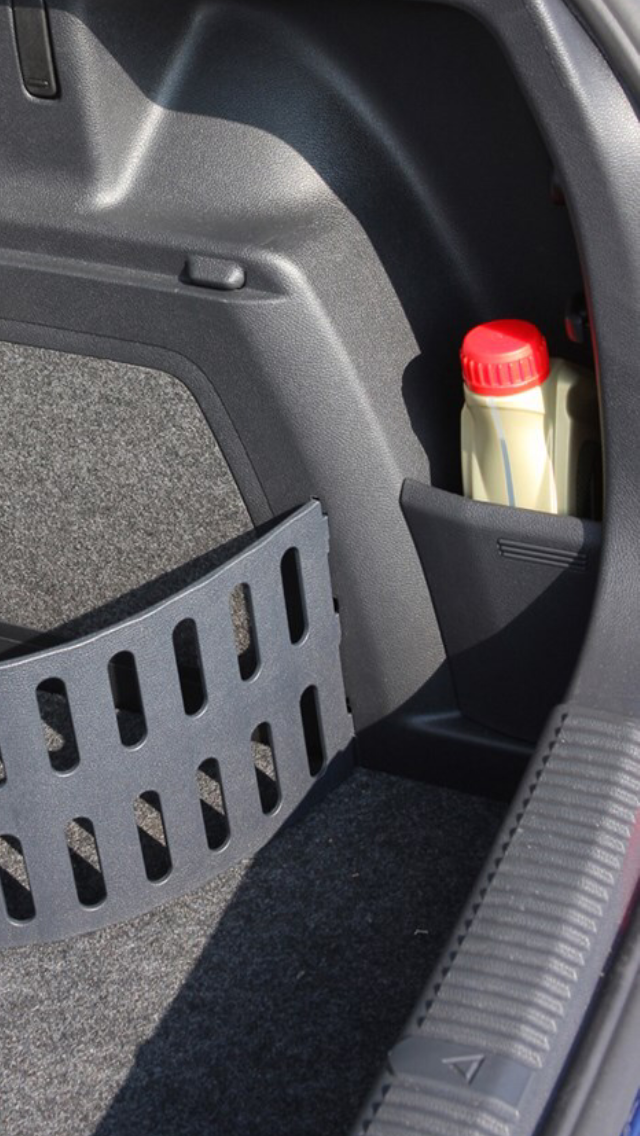

I have a mk2 5j 2011 Fabia and I am looking for some trim parts from the boot that are missing. They are the two pieces which slot in Left and right next to the wheel arch. Please see picture the piece holding the oil bottle in. Any ideas of the part numbers or where I can get two from Thanks.
Edited by MATT1
There's two different pieces for the left and right hand side, these are for the hatchback the estate will be different:
  • 5J6 867 145 for the bigger piece (LHS)
  • 5J6 867 146 for the smaller piece (RHS)
Part numbers may have been revised. Best get prices from your Skoda dealer, a lot of the time they're surprisingly much cheaper than a breakers yard for small items like these.
