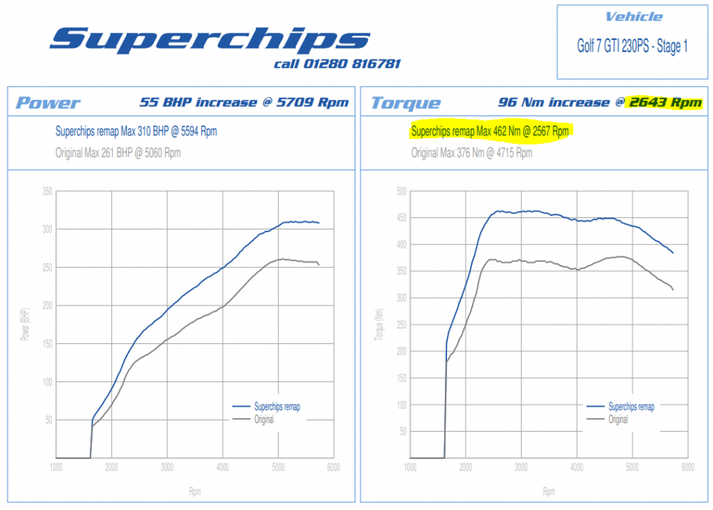

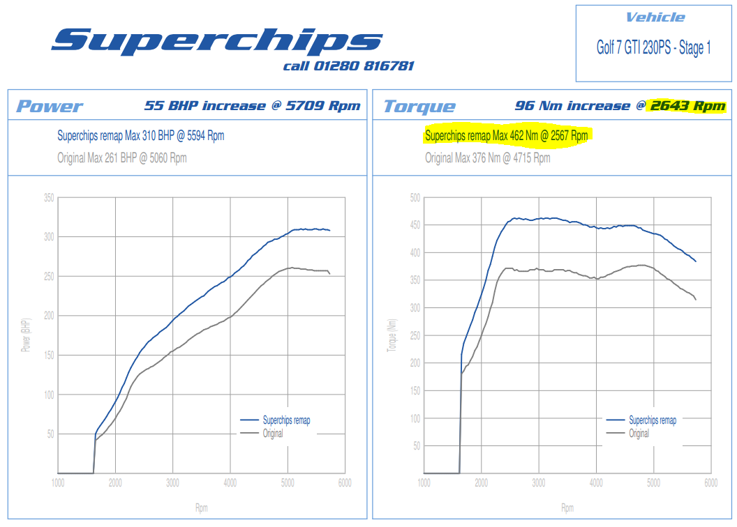

It would be interesting to see the torque curve of the new map to see where the peak is..... I wouldn't mind betting it's around 2700rpm ;)
As suspected ;)
The map is the bluefin one so power is less at around 280 and torque a little less at about 450nm

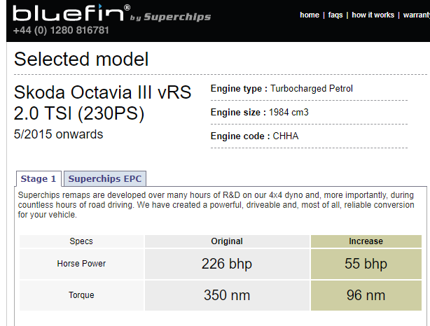

That's the chart from the Blufin/Superchips site
Sorry I missed the fact that the car dyno'd initially at 260bhp and not 230bhp
If that is a common think then it may well have a similar thing going on here so who knows what power it's running without having it tested. It seems strange that this only happens in 6th but In the wet I suppose it's hard to notice if it's being reined in by the traction control etc
