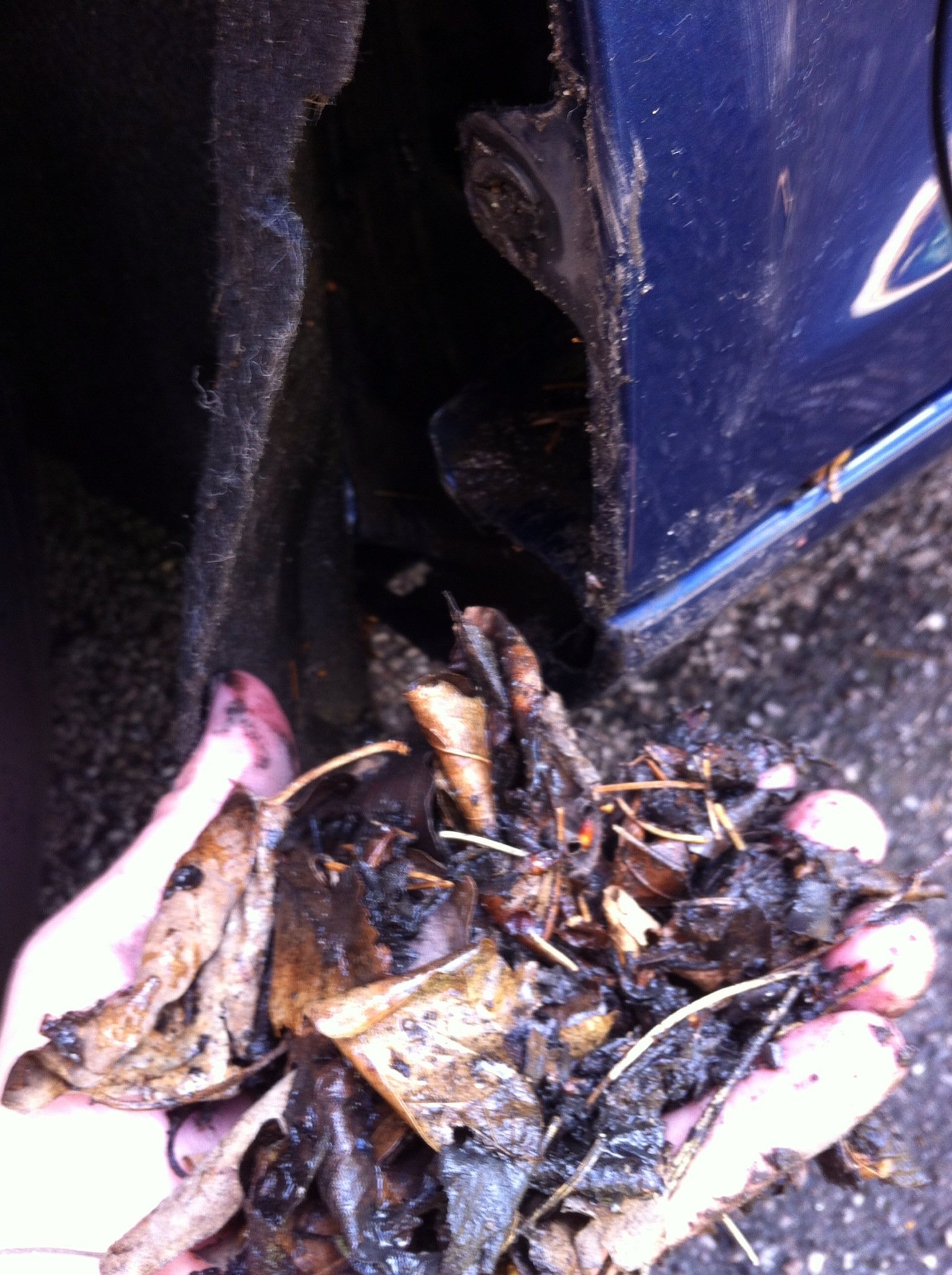

Try clearing out the drainage channels behind the wheel arch lining.
Its not a difficult job and only requires the removal of several torx screws.
Here’s what I found when I did mine.
