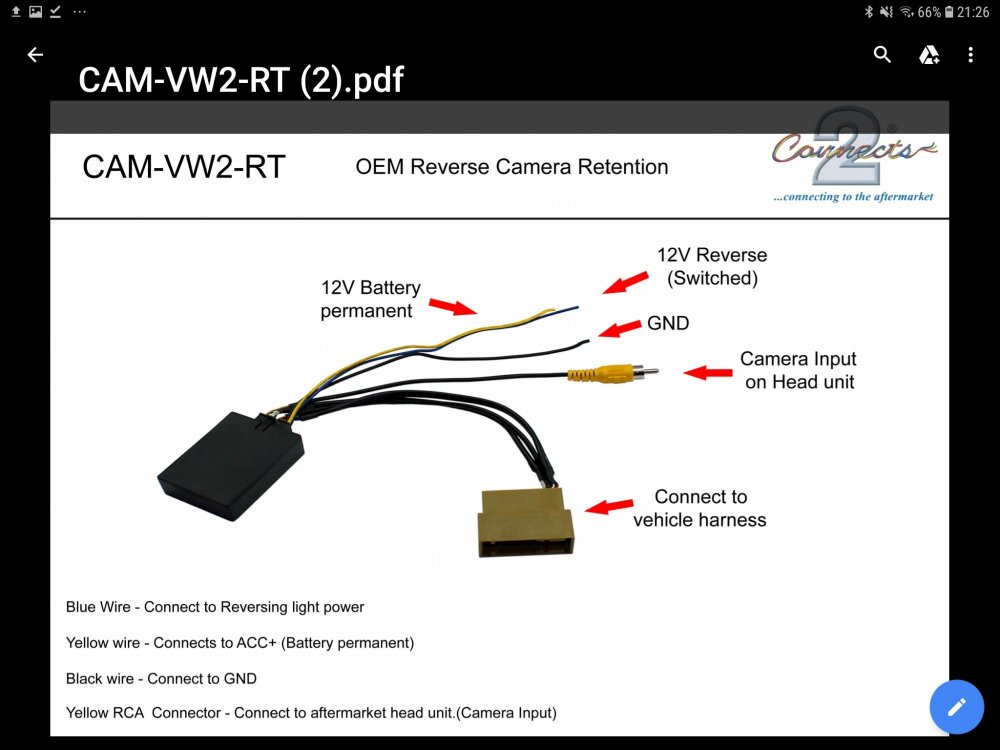

Has anyone fitted one of these listed bellow to the headunit,
Connects 2  CAM-VW2-RT Skoda Reverse Camera Retention Interface
It's ment to  add reversing camera,
it als say it's plug and play,??
Edited by craigandrew
This is interface to connect factory camera to aftermarket unit, not afterkamrket camera to factory Columbus.
Ok many thanks for your help.
Just trying to look for something that hasn't got to be coded to the columbus,

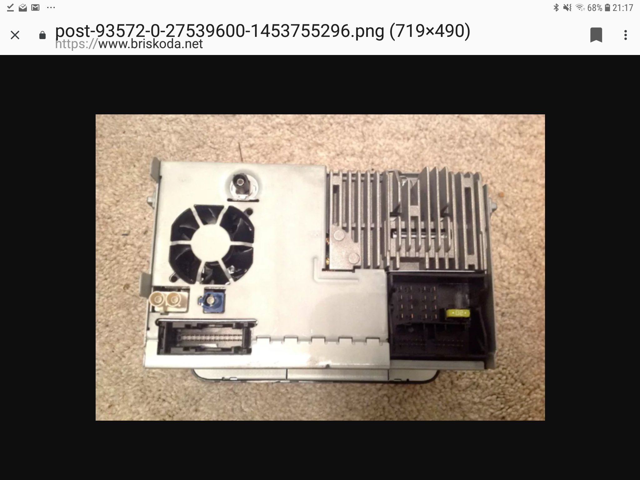

Unless you have the current situation that when you put the car in reverse the Columbus will show you a black screen (no input from the camera), you'll have to code it to expect the camera input ... what kind of camera you connect to it and how is irrelevant, it is the "reverse camera present" that you' re probably missing which can't be enabled any other way then by using the coding (VCDS, ODIS, whatever)
