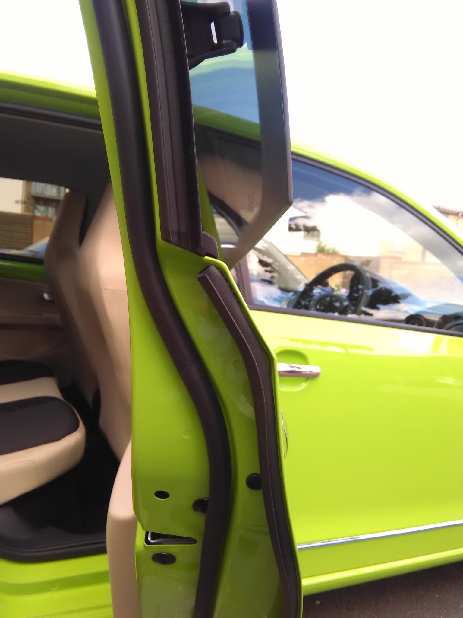

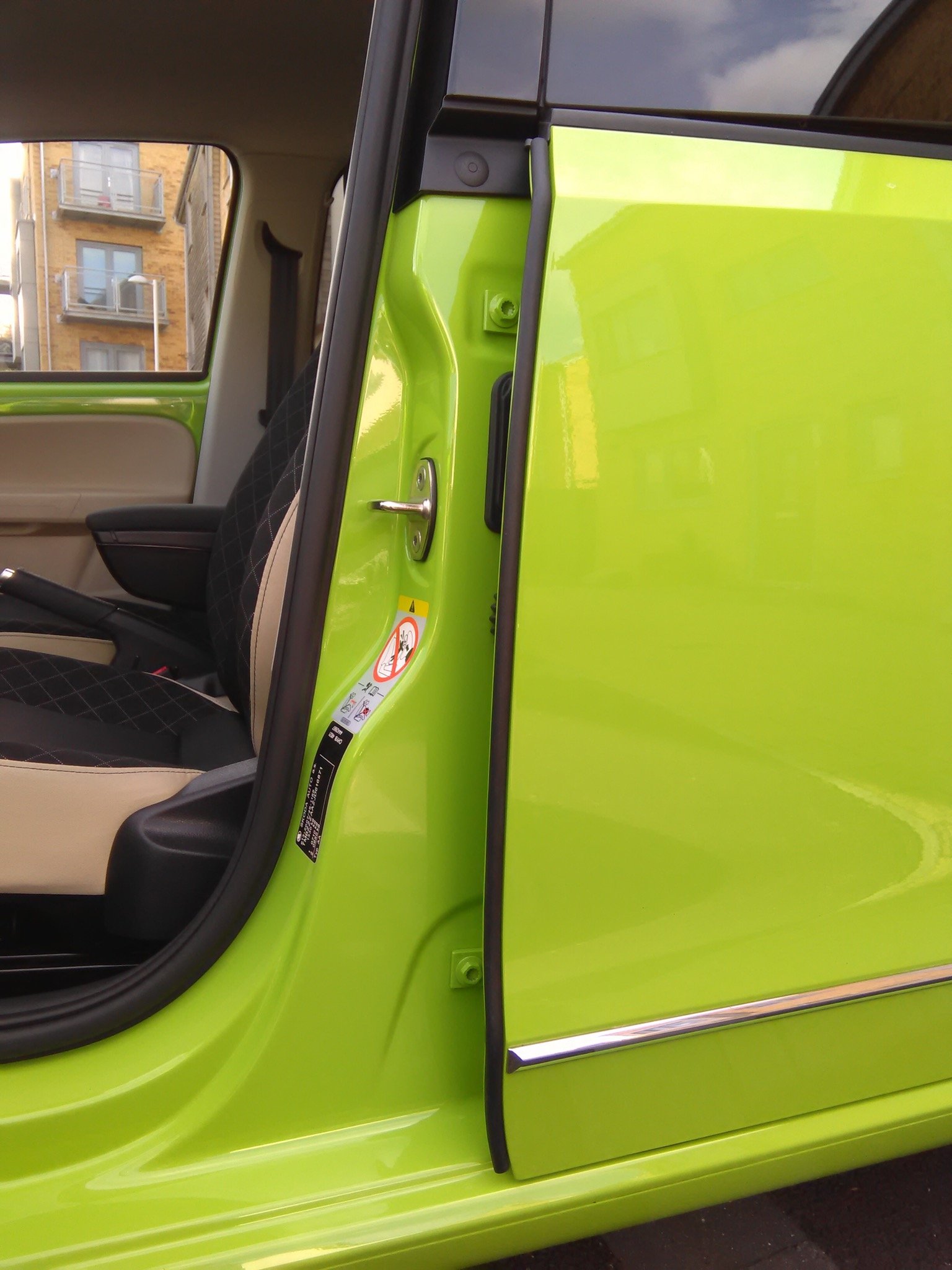

Hello Citigo lovers,
as I couldn’t find much help on adding extra door seals in this forum,so I was looking for some answers elsewhere.
This is how I ended up.

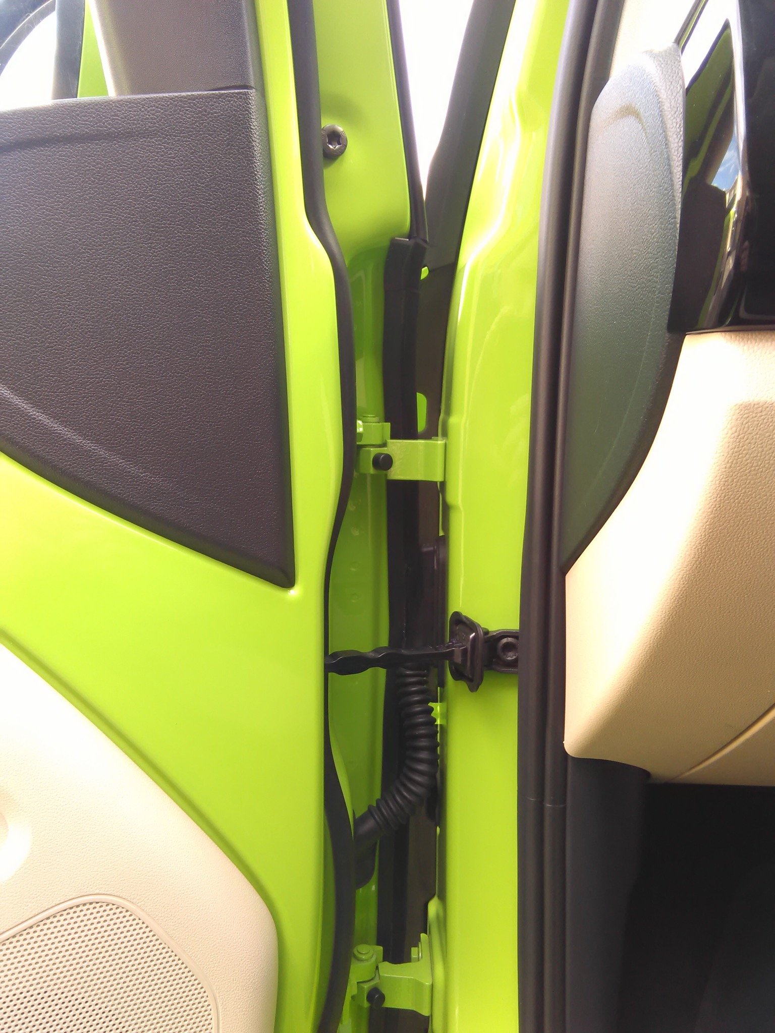

Front edge on front doors:
Z shape door rubber seal need less than 2 metres
Front edge on rear doors:
Small D-type rubber seal 9x10mm need less than 2 metres
Bottom edge front and rear doors:
P-type rubber seal about 5 metres (have to cut holes for drainage channels!)

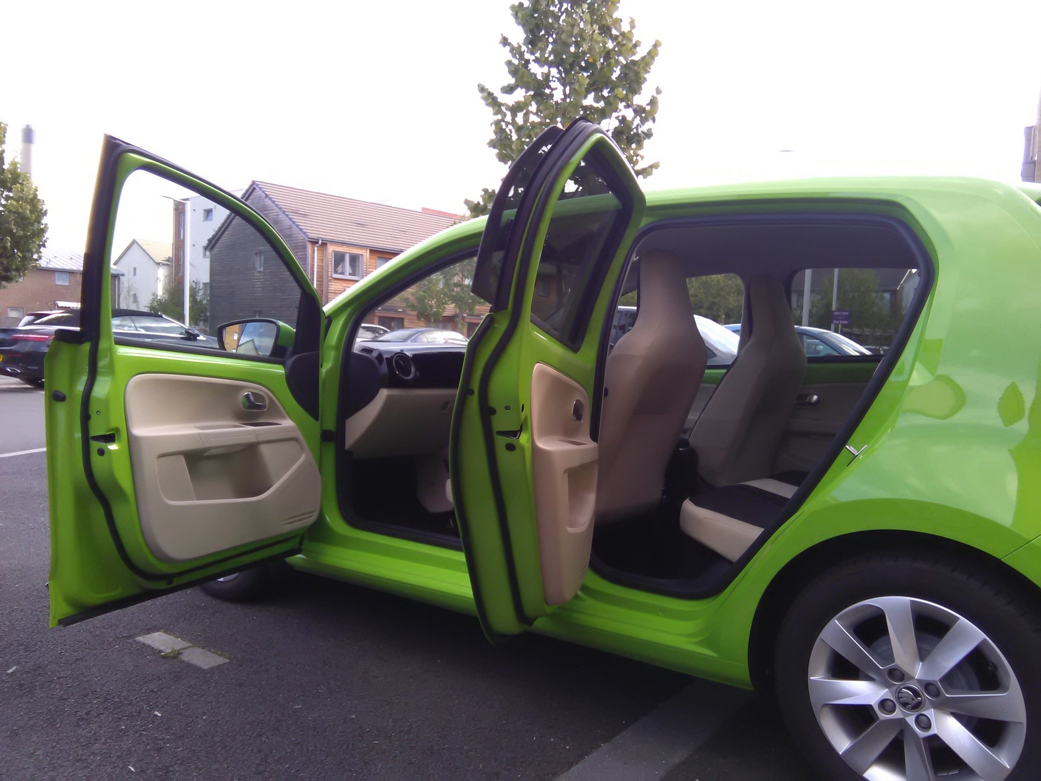

Around doors:
Big D-type rubber seal 12x14mm 4 metres each door

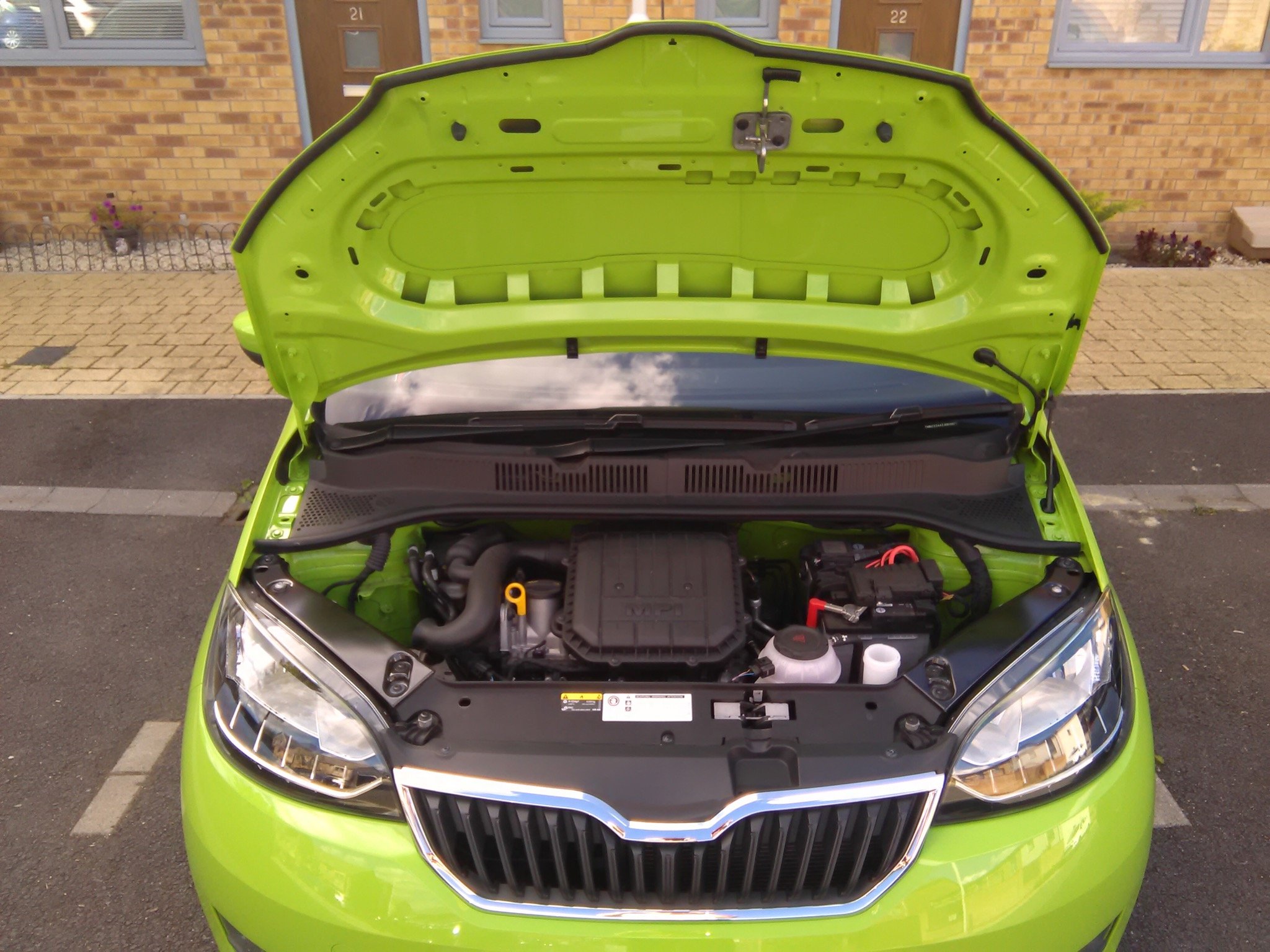

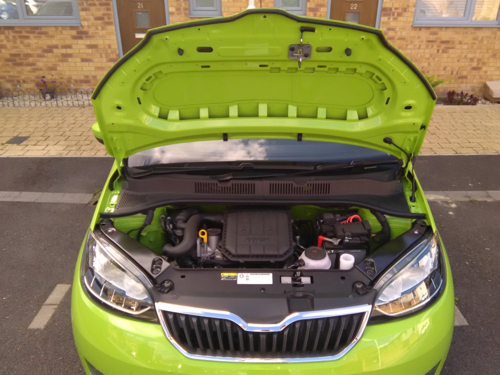

Front edge off a bonnet:
used rest of Big D-type seal
Say goodbye to dirty door steps!B)
