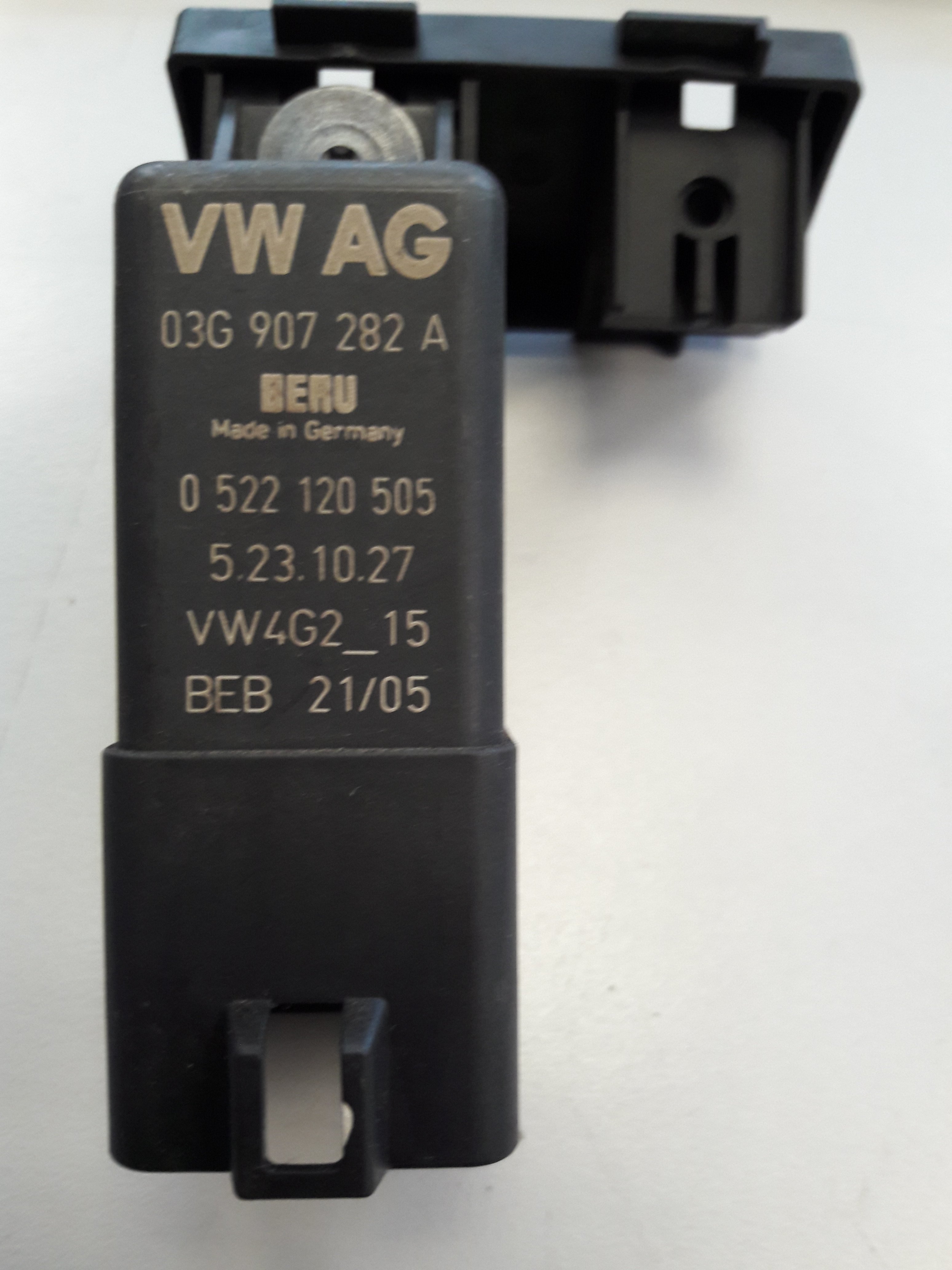

I mentioned the discussion about the Glowplug controller to my electroniky younger son and he has given me a link that goes into the techniques at some length. You can skip the maths and glean interesting information. Son says that the controller will be a "buck"  or "buck-boost" circuit. See https://en.m.wikipedia.org/wiki/Buck_converter if you have the time!  These techniques are used commonly in computers and mobile phones and more ore less everything else!

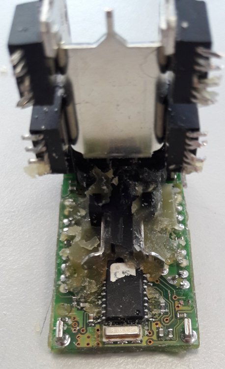

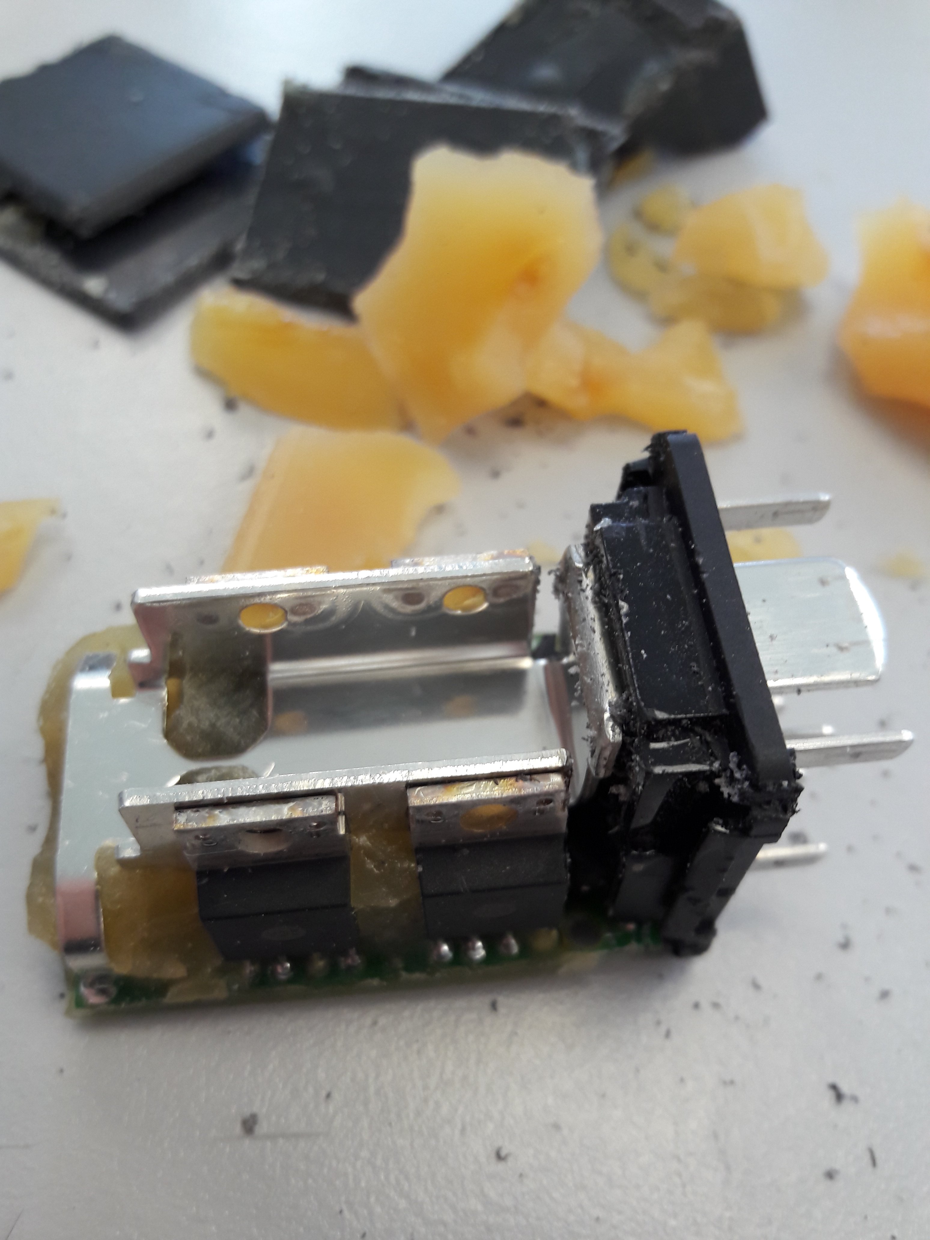

It's a good idea, but my cutdown which arrived this morning says that a PWM approach seems the more likely solution adopted here.  No moving parts like the electromechanical relay I originally thought, before the 6V/5V thing was confirmed.  The little circuit board is potted into the housing, but luckily with a rubbery compound rather than an epoxy, or I'd never have got in.

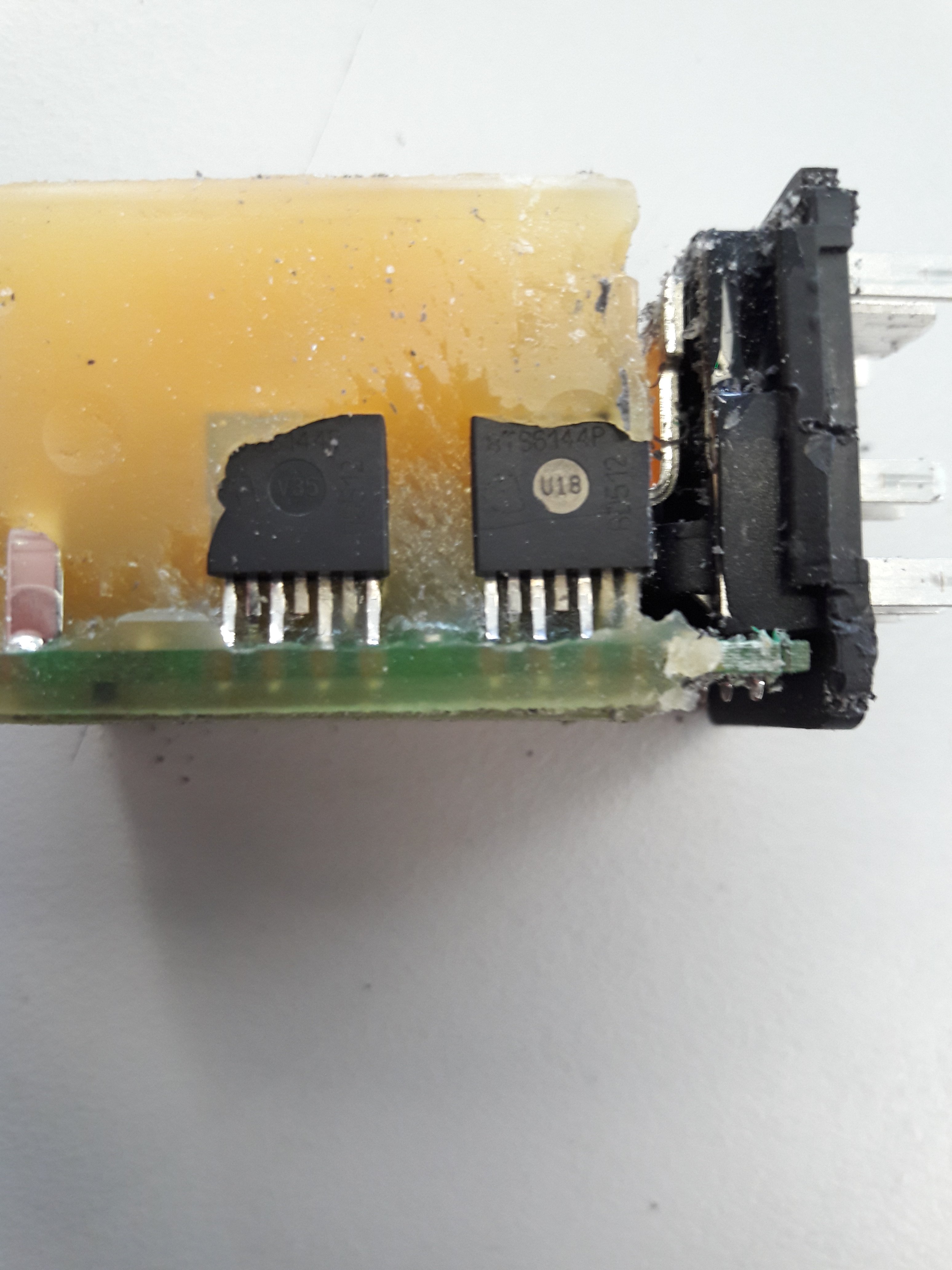

There are four BTS6144P "Smart Highside Power Switch" devices connected to the four glowplug outputs, and the main incoming 12V (wide pin forming a busbar and heatsink for the four devices), and a quick look at the datasheet makes me think that switching these on and off in a variable mark/space ratio will be how it works. This would give an average/effective lower voltage like 5 or 6  or lower, easily and efficiently, with the appropriate adjustments to on/off time ratios.
I'll add any more info that comes to light through further excavation of the potting compound.

Only thing to add is that it has its own local 'brain' in the form of an ST72254 microcontroller and an 8MHz crystal to keep it in time, hiding under the busbar:
Edited by Wino
Well done Wino. Evidently the ECU will tell this controller what to do and when, having gathered temperature data etc.  I intend doing some measurements when the new plugs arrive; I shall pass on anything that I find.

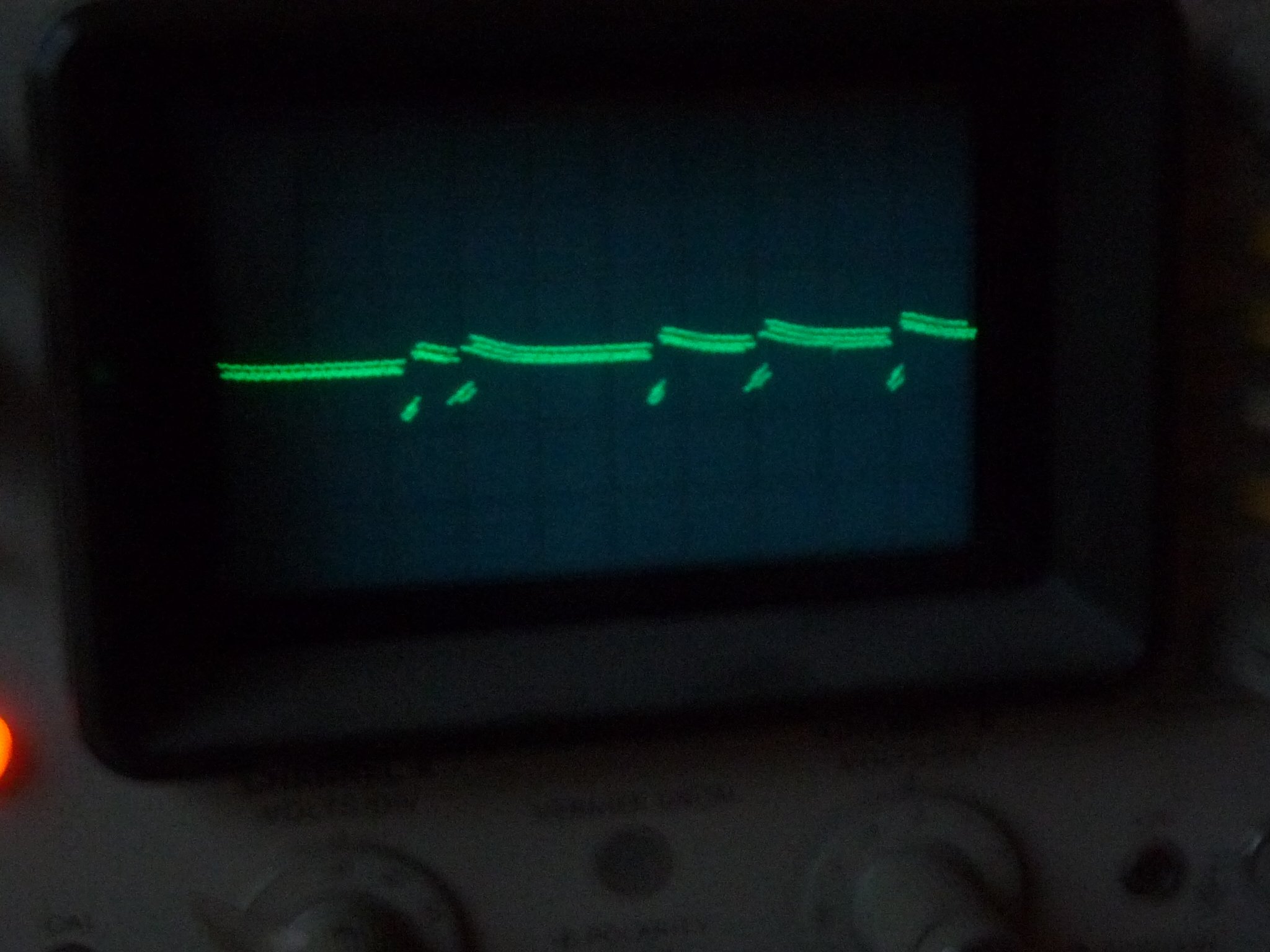

I connected the scope to No2 connector with Ign on, and with the scope on AC, the waveform shown appeared (No plug connected). The amplitude of the pulse is about -0.1V and the intervals are about 0.6, 1.2 and 2.6mS. (1mS/cm) Not very high frequency.  The scope would not sync very well because the waveform was not stable. With the scope on DC, the 6 volts appeared flat - no pulse, no apparent ripple.

It's not blindingly obvious to me what's going on from your testing with the scope. Are you proposing that there's some sort of  'glowplug presence' 6 volt sense signal separate from the FETs? It's entirely possible, but those FETs seem to have so much protection according to the datasheet that I don't see why that would be needed? Maybe it's there for diagnostic reasons? I nearly threw out my cutdown this afternoon but stuck it at the back of a drawer instead, Could be revisited tomorrow. :)
Hoping that you have plans to reconnect the scope when things are chillier to see what happens then?
Hi Wino, I too am clueless as to what is going on. Since I was able to clear the faults shown up by VCDS it must be so that the ECU is content with its sensor input. I do not know if the glowplug connector has 2 wires inside it. There might be a monitor connection - or not. But somehow the ECU learns that there is a satisfactory low resistance at the plug.  I had hoped to detect a mark/space ratio of half; the fact that I did not disproves nothing; it may well be that the output is sufficiently smoothed and actively controlled to be so. Since I did see the 1.4 Volts with ign off, I suppose it is possible that it is this value that the ECU considers to establish the plug condition, but equally it could be the 6 volts presence/absence when the ignition is on (More likely perhaps). The ECU has the opportunity all the time to assess the plug condition because most of the time the plug is not needed to glow. When it is required to glow by low temperature, the ECU does not need to assess, merely to drive the plug.

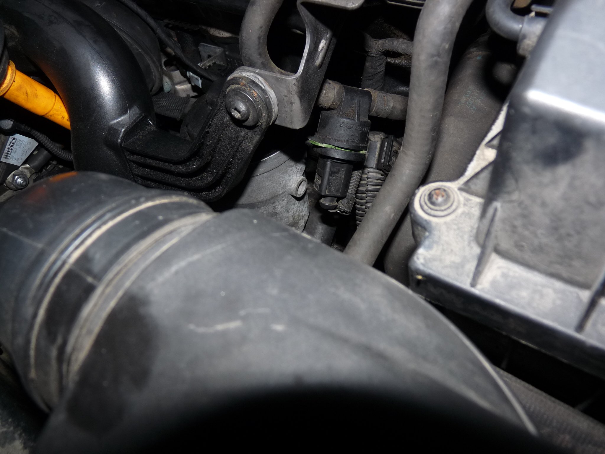

Nope. No help at all Superb. What the L is a tandem pump? Don't bother answering that query - just send a picture. I did remove a couple of sensor plugs and got told off by the ECU and VCDS.
There is a sensor above the radiator in a small tube, and that must be about temperature, but is it the right one?  I have seen no green plastic clips and I can't imagine a "sort of plastic coolant flange".  That sensor after the air filter box is a flow sensor isn't it?
I have a suspicion, given the ever-so-smooth DC voltage seen on the scope, that there may be nothing to observe with the scope attached to the plug controller output leads.
If we are interested in how the plugs are driven, under starting conditions and thereafter, it is probably current that we should be trying to measure; the resistance of the plugs will go up sharply as the element gets very hot and the voltage may probably be controlled lower - but that won't tell us much without knowing the instantaneous resistance.
We already know that 6 volt heavy current can be produced by the controller and that the plug elements will care little whether it is smooth or pulsed. We are unlikely to be able to fathom much about the designers intentions of intensity and timing from voltage measurements, though a scope or multimeter could tell us that the plugs are being fed.

I don't think it's possible for the FETs to produce a smooth 6 volt output, as to do so they would each have to be dissipating the same power as the glow plug they were driving.
There are no large capacitors or anything else that could smooth a 50/50 PWM 12V output, so I expect to find something else in that module that's generating the smooth 6V. It may be something as simple as a potential divider pair of resistors from the ignition 12V feed. That might be applied to the glow plug in order that the microcontroller can then 'see' by how much the voltage is pulled down by the glow plug. This would vary with the resistance/health of the plug.

Its the vacuum pump & fuel pump driven by the cam on the RHS of the engine. Under it is the coolant flange with the temp sensor in the back of it. see link from @Wino
Access isn't brilliant, you probably need to take the pipe off the airbox to get your hand anywhere near so its probably not worth the hassle, but its good to know if you ever need to replace it.

My engine is a BJB.  The diagram you found is for BKC, BXE. I can't see that Tee piece attached to the short cylinder at that end of my engine. I don't know much about these diesel engines; it looks as though there may be an injection pump (?) located where that temperature sensor is.
There is a castellated short cylinder under this pump with a bunch of leads coming out but it is nothing like your diagram and it is not obvious how the leads might be disconnected - doesn't appear to be a connector there. See pics

Somewhere under the convoluted airpipe in your last photo, I guess.

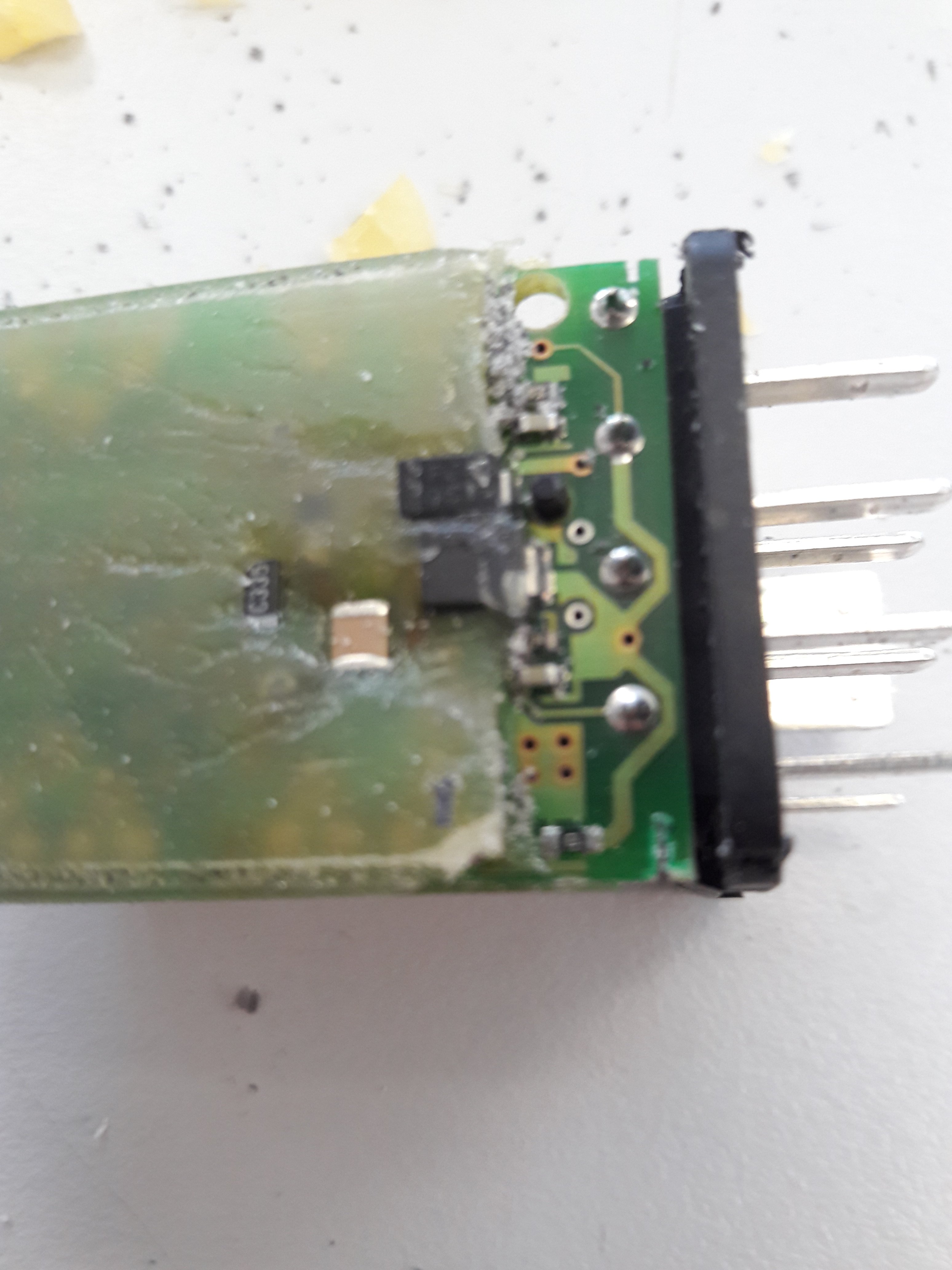

I've spent a while digging deeper into the rubbery potting and got the circuit board out from all the overlying stuff, but someone else is monopolising my microscope today so I'm not able to do much circuit figuring. I didn't get a peep out of the outputs by powering up the thing with permanent and ignition 12V equivalents in the appropriate places, though it took a sensible sort of quiescent current, so I guess it doesn't put out the 6V or anything else until the engine ECU tells it to, or else I've broken too much of it getting this far.

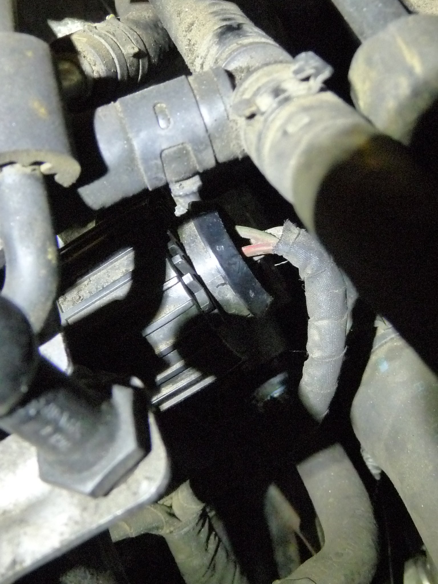

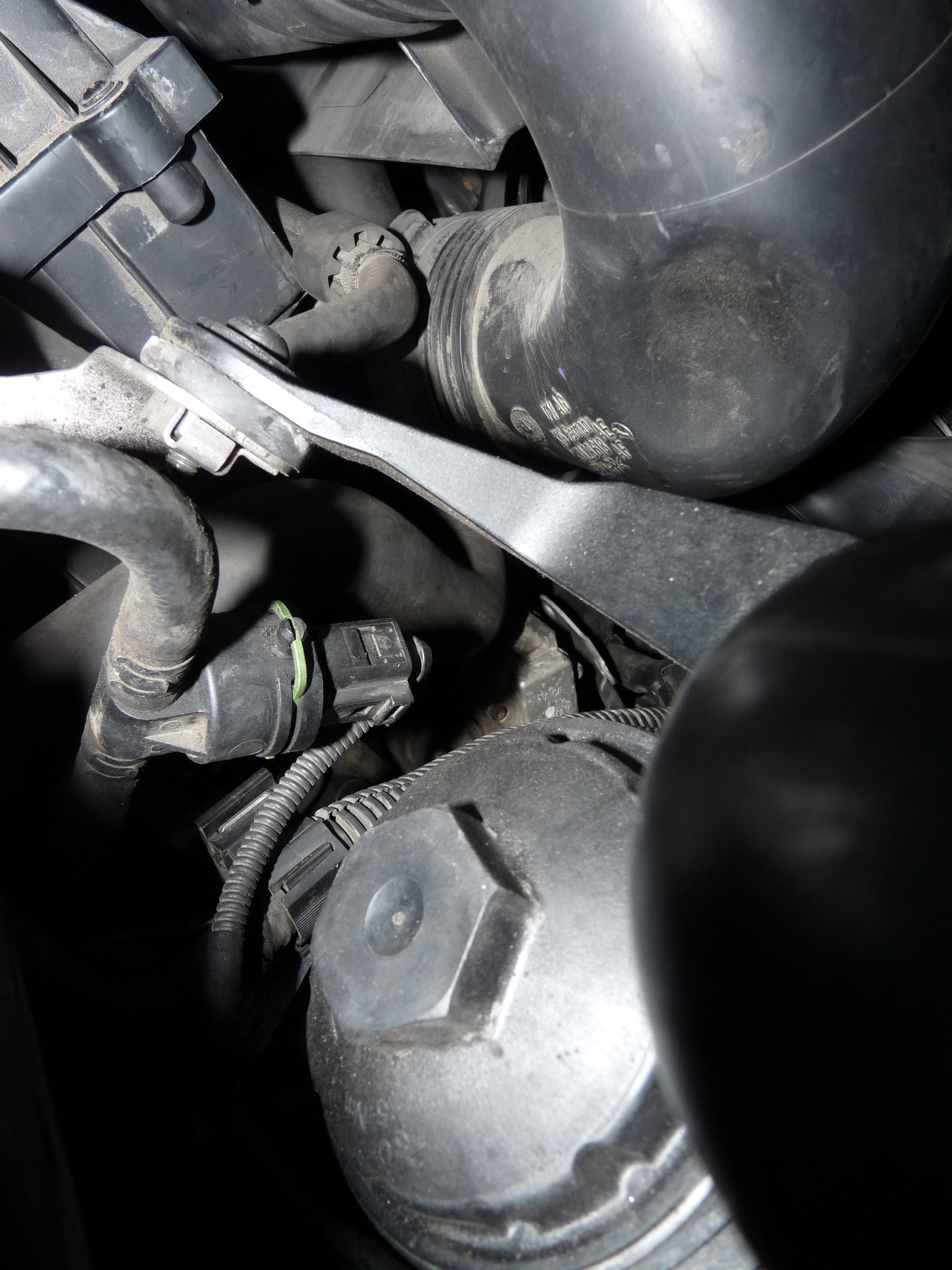

Found it at last - it might have bitten me! But it is nothing like the bit in the diagram. Trouble is, if I release that green clip and pull the sensor out I shall have coolant peeing out. It is not obvious if there is a connector, or if there is how to release it. (There must be!) I sussed how to release the other connectors last week but this one looks different. When the engine is cooler I shall try squeezing that lever with a pair of pliers.
  • Sponsor
Is that definitely a coolant hose?
I have a vague recollection of the fuel temperature sensor living in a fitting like that?

That is what I was picturing in my head before you posted the actual location, even got it down to the green clip :D
I do however fear that this is the fuel temp sensor also, probably on the return/supply leg of the tandem pump maybe? still not 100%
It won't hurt to unplug it and see with VCDS which reading you lose/what error code pops up
