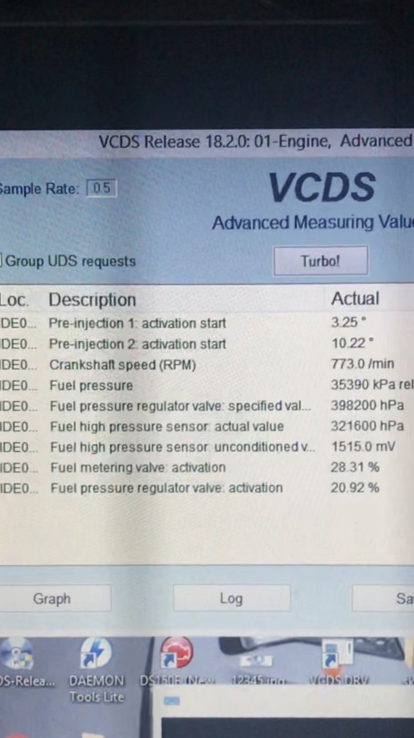

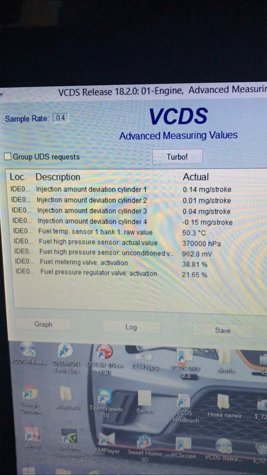

Fuel temperature sensor? Can you connect up VCDS to view realtime data?
47-50 c. Fuel temperature.
  • Sponsor

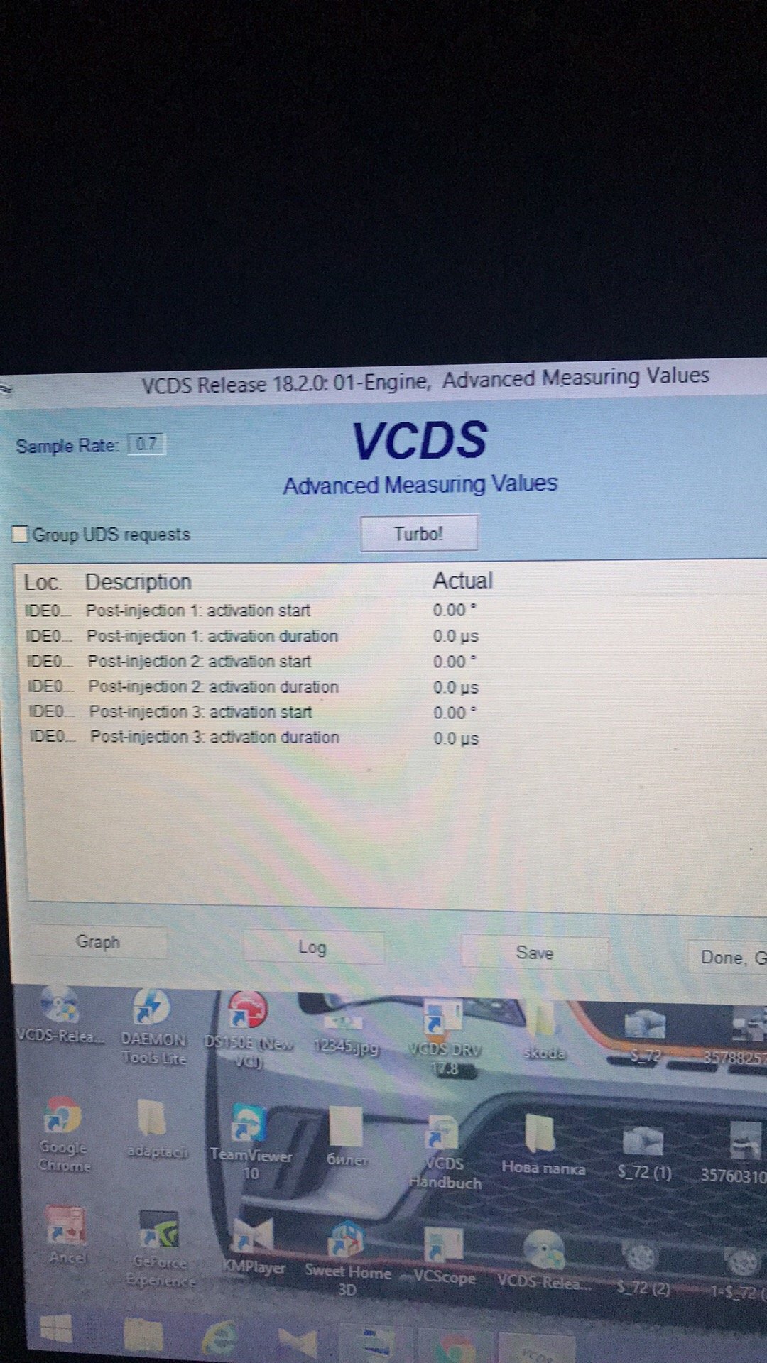

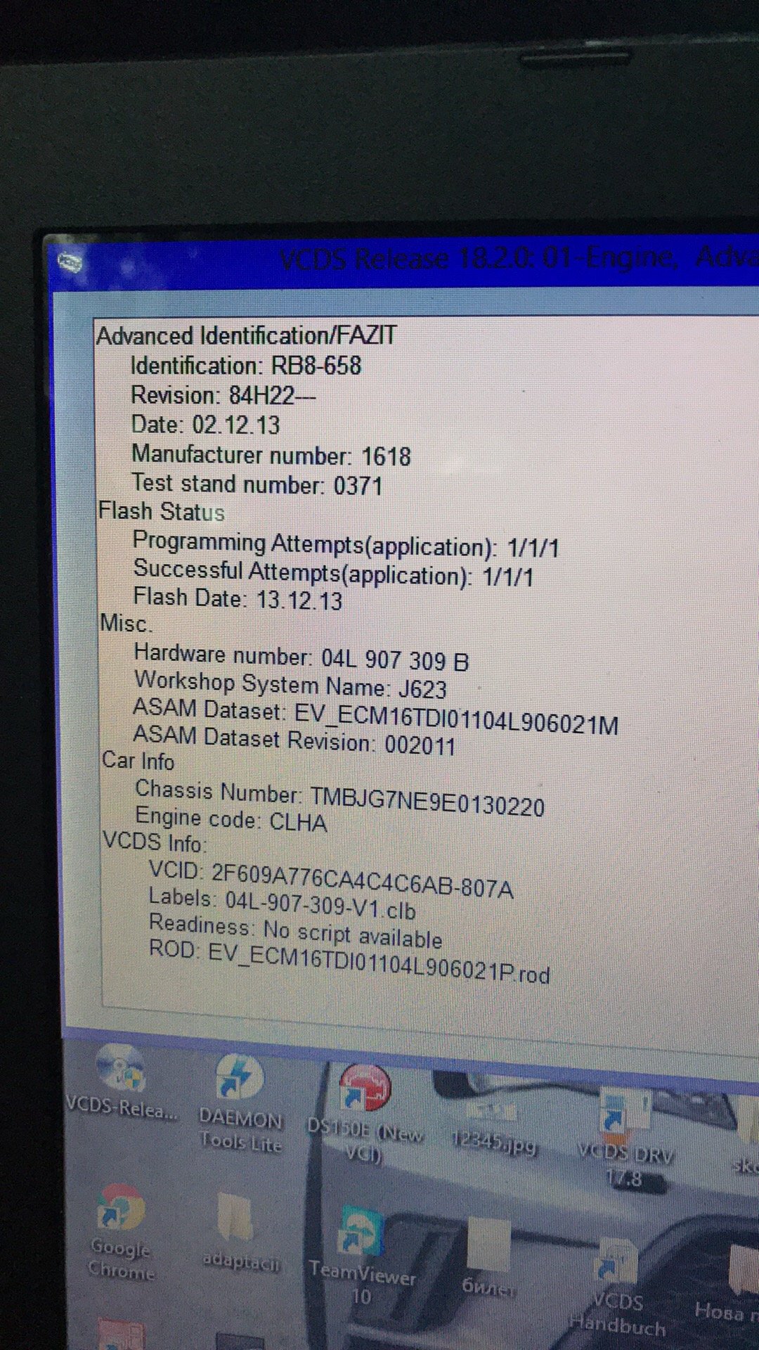

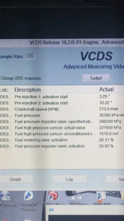

What conditions do those data represent? With or without engine cover fitted?
This pictures ist bad working engine . My version in engine software .
