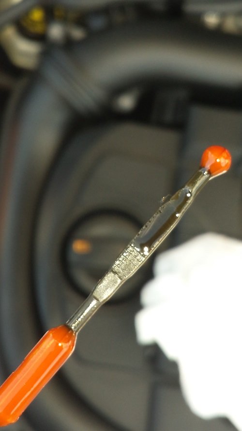

Genoa1893,  are you telling me that there are Engine oils for diesels that are not black after 5,000 km?
I am interested which is why when i started as an apprentice mechanic we changed oil in diesels every 30,000 miles. Over 4 decades ago.
Why do French Manufacturers recommend Total, or Japanese there own oil or Mobile.
Why have German Manufacturers of engines the worst reliability of engines out of Warranty and only give 2 or 3 year Warranties?

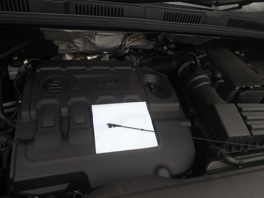

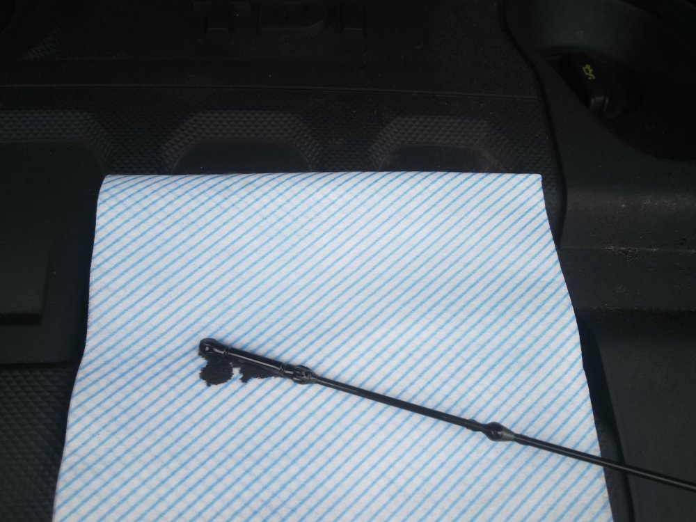

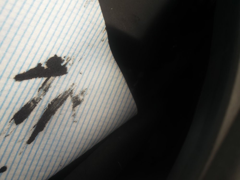

Here is what VW / SEAT's Factory oil looks like after a year and before a variable service when a Dealership says it is not getting changed yet under a Service Plan .
But then it looked like that after 500 miles, and the same after the Oil and Filter change 100 miles later.

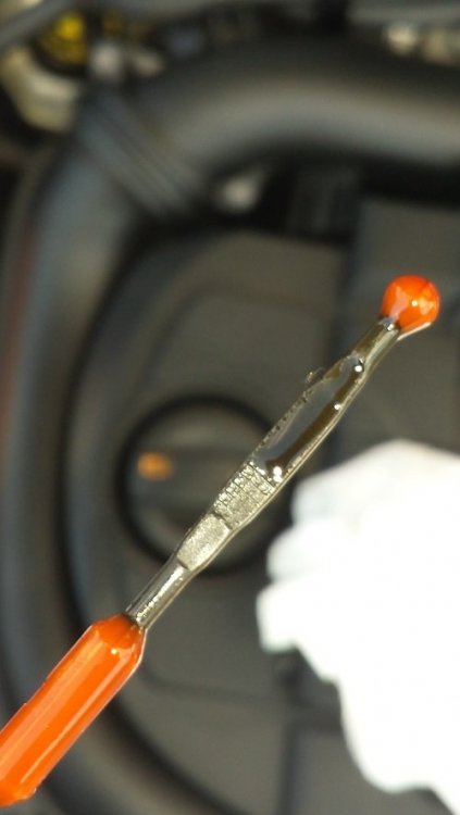

I haven't seen any warranty or engine fails on any vRS mk3 within or outside warranty? I ain’t seen any threads on here either! Maybe I’m missing something? Maybe I’m not looking in the right place, I’m not doubting what your saying Offski, I do understand what your explaining & it does make sense if that is the case but I use 5w-30 Castrol on my vRS 2.0T remapped stage 1 & I’ve seen my oil temps stay between 98-108 depending on driving conditions etc, which to me seems pretty decent.
My car does sometimes require a top up of oil during the 12 months but that’s me checking my oil & keeping it where I like the level to be on my dipstick.
Unless I had a car burning oil like mad or if I was doing pure race track days a lot then I would potentially look to use 5w-40 maybe even a Ester oil? But seeing that I drop the oil every year 6000-7000 (max) miles surely 5w-30 even if you was remapped to stage 2 would be fine? Unless oil consumption is an issue?
Are you kidding? No, I didn't say that. I told that since oil does get dirty black after jusy a few miles and since is the first oil put in the engine, I want to change it sooner AND I asked for first hand knowledge or experience with supposed better performing oils.
Don't see the reason why you posted all of that pictures since the point that oil gets black in diesels is well known and I bet it's pretty well known that oil in petrol is generally cleaner (at around the same mileage).
