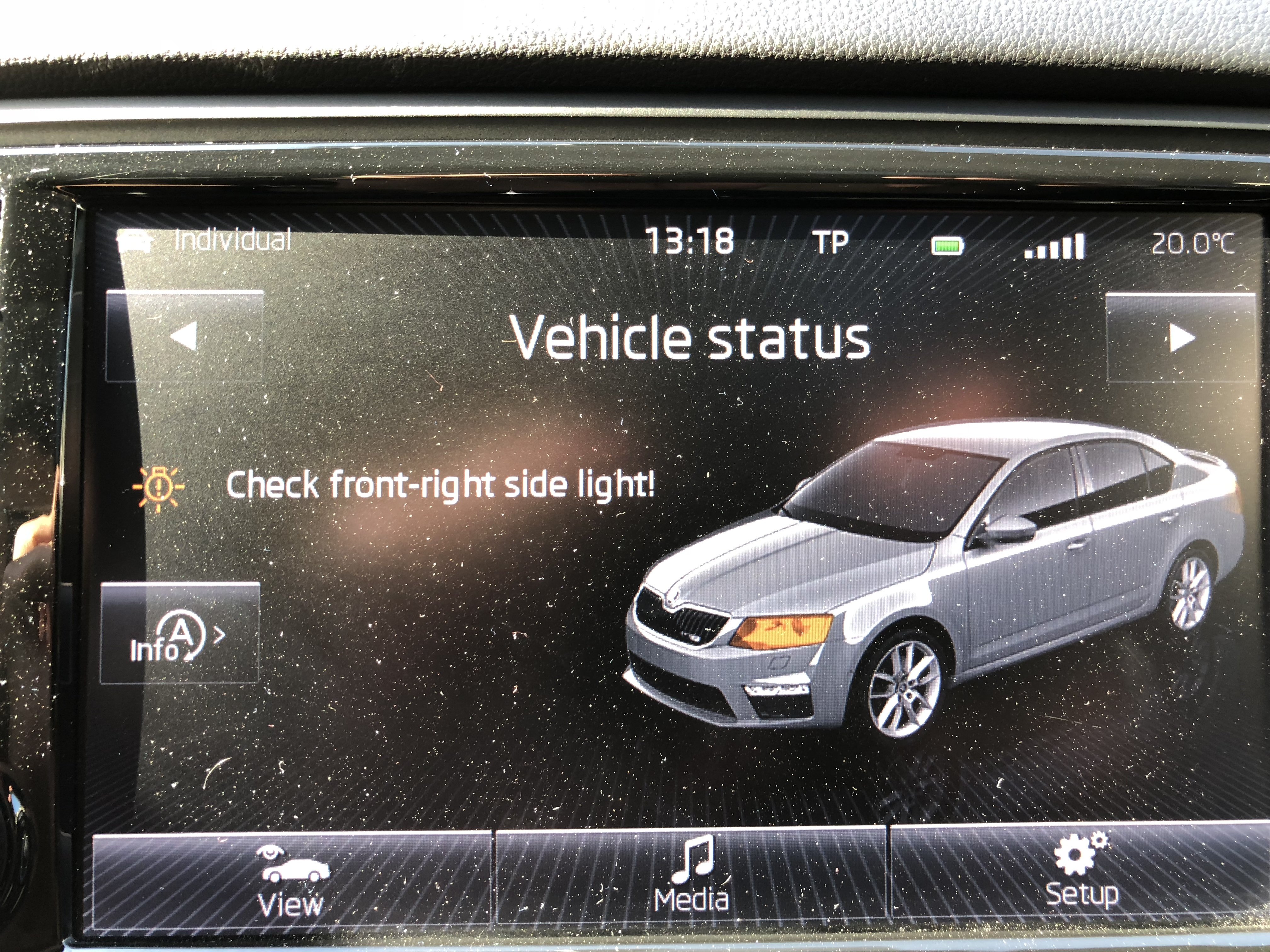

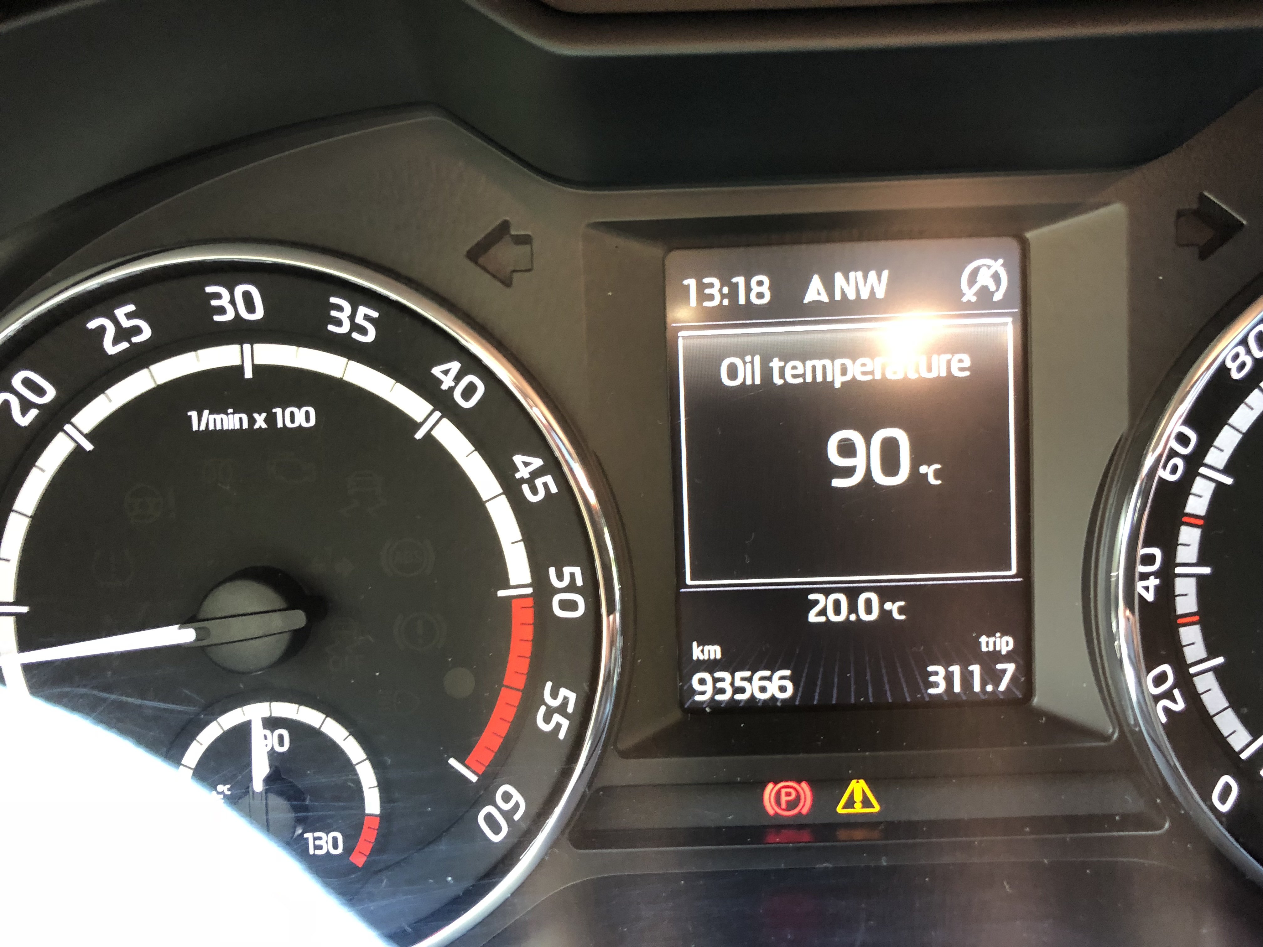

Hello guys,
Like the title sais, how can i get rid of the exclamation sign after changing the position halogen bulbs to LED ones? Is there a vcds or obdeleven mod to change that, or just erase the error?
Use good quality CANBUS LEDs and you will not get the error.
VCDS may get rid of the error but it doesn’t always work, good quality LEDs is the first thing to try (they will also last longer than cheap Chinese LEDs)
I solved the problem. I didn’t need to use any software. I’ve just restarted the engine and the error was gone :)
I just turned them off on my pre-fl vRS using OBDeleven.  The LED bar functions as a position light, parking light and side light so I’m not sure what the regular halogen side light is offering.
I am of course assuming its a vrs you have based on the picture.
