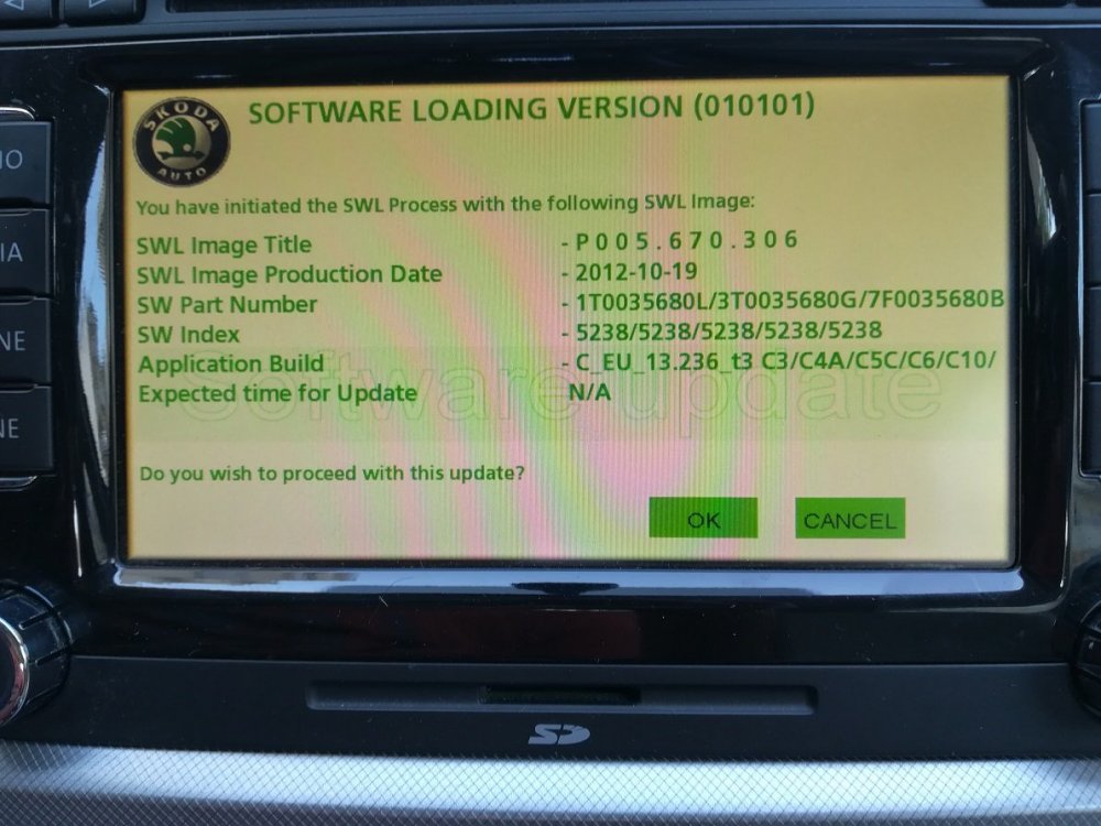

As Rustynuts confirm in another topic I should go for firmware 5238 this is common for skoda and VW.
I give more info when I do it.
All good no harm is done.
I download the firmware   FW_5238_ORIG from hear   and I burn it in CD-R.

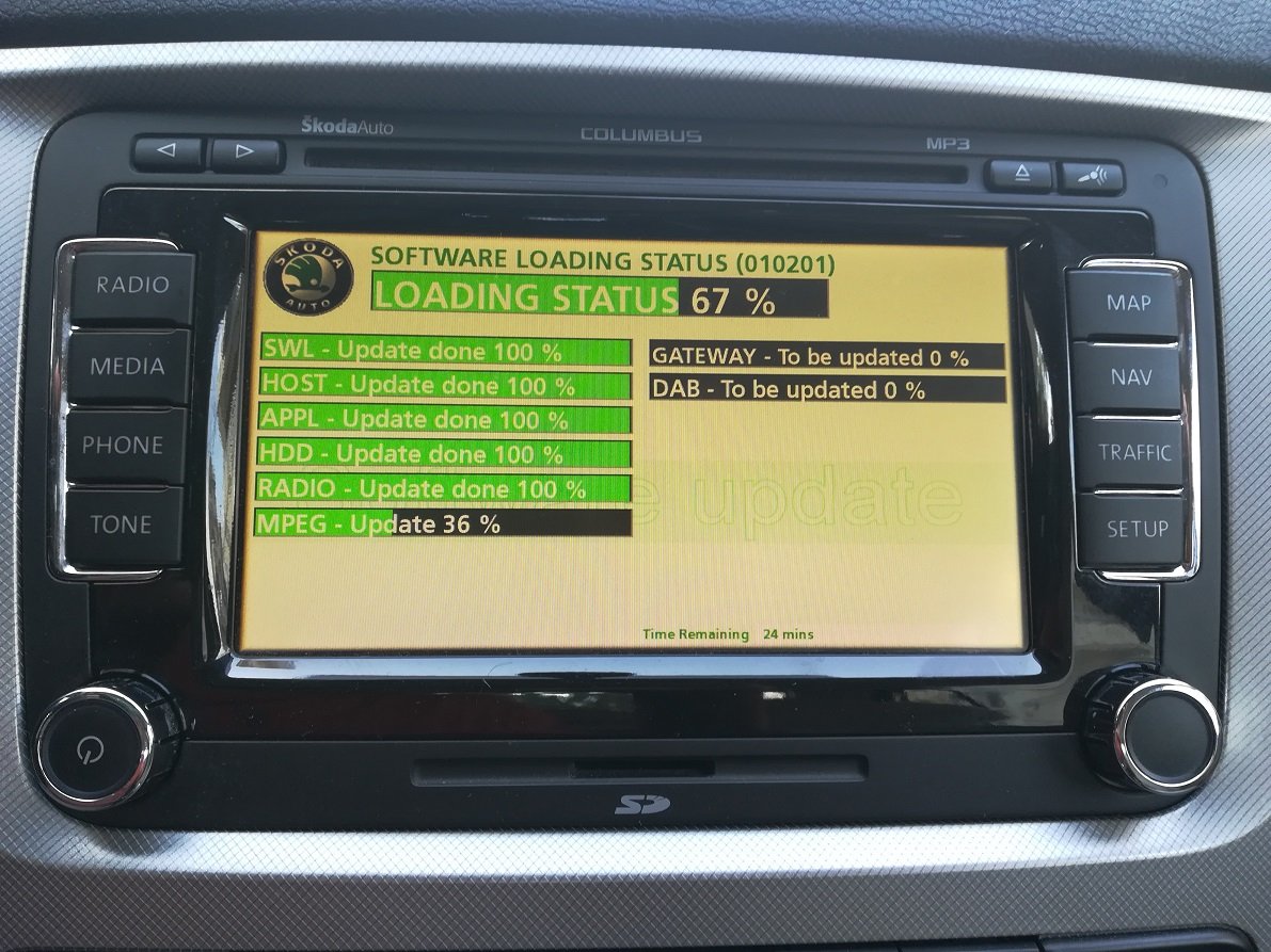

·         With the key out of ignition start the Colombus and insert the firmware cd-r.
·         You have to confirm the firmware installation.
·         when installation starts (bars run from 0% to 100%) you don't need to be present any more you can come back after 45 minutes.
·          The installation will restart the unit a few times and will hard restart at getaway installation.
·          when the installation finishes the cd-r, will be ejected. At this point, the firmware is installed but no maps exist.
·          if you press the navigation button the system will ask for maps DVD.
·         Insert the map DVD+R DL with the V15 maps. the installation can be monitoring by one bar at the bottom of the screen.
·          The installation duration keeps about 45-50 minutes. When finish the system ask to remove the DVD.

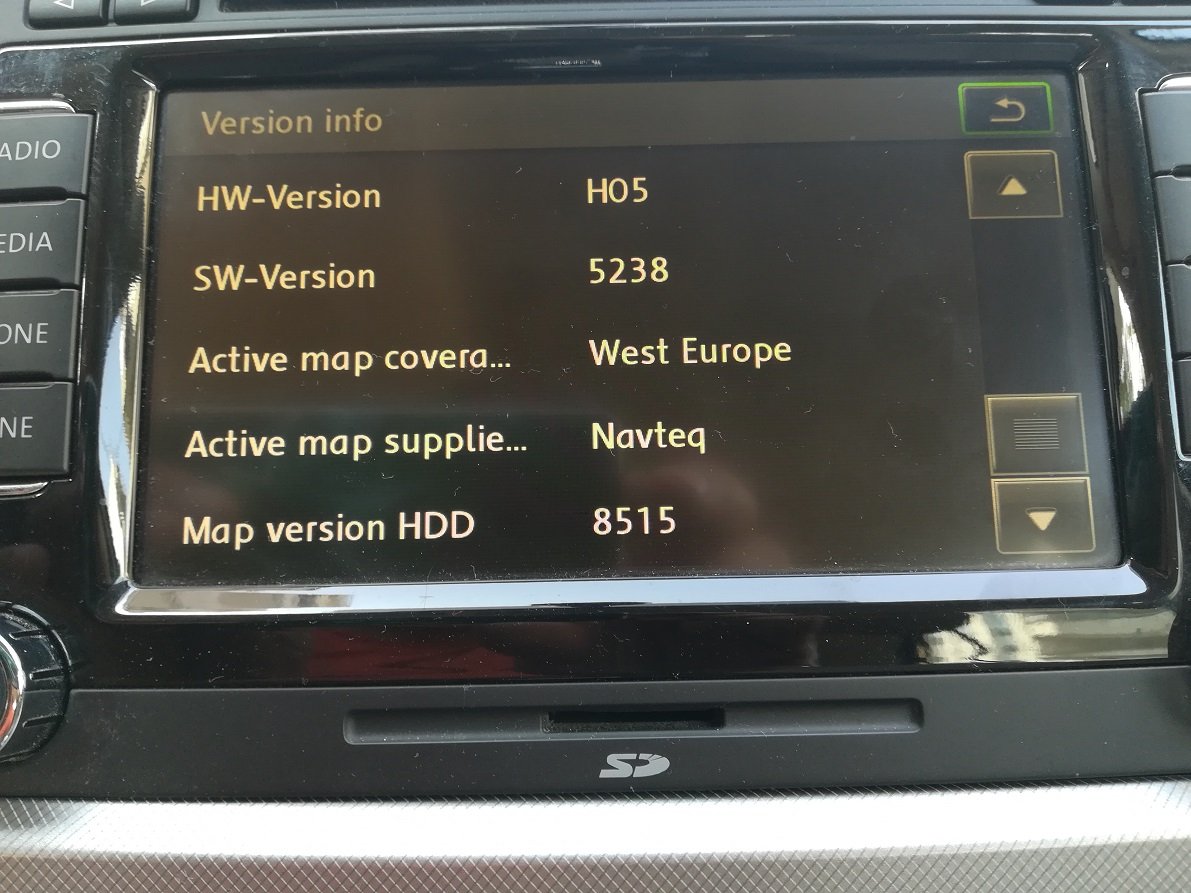

·         After this, you can go to SETUP button and keep it pressed for 30 seconds. In the info window, you can confirm the system and map installation.

Did you noticed any functionality changes after update?
Not really, except:
·         Faster boot with more responsive to touch.
·         Ability to have the map version by holding the “set up” for 30 seconds.
·         Ability to search the map by postcode. (Not sure if I have this before).
The rest set up continue to work fine. (Parking sensors, voice commands, steering wheel buttons)
