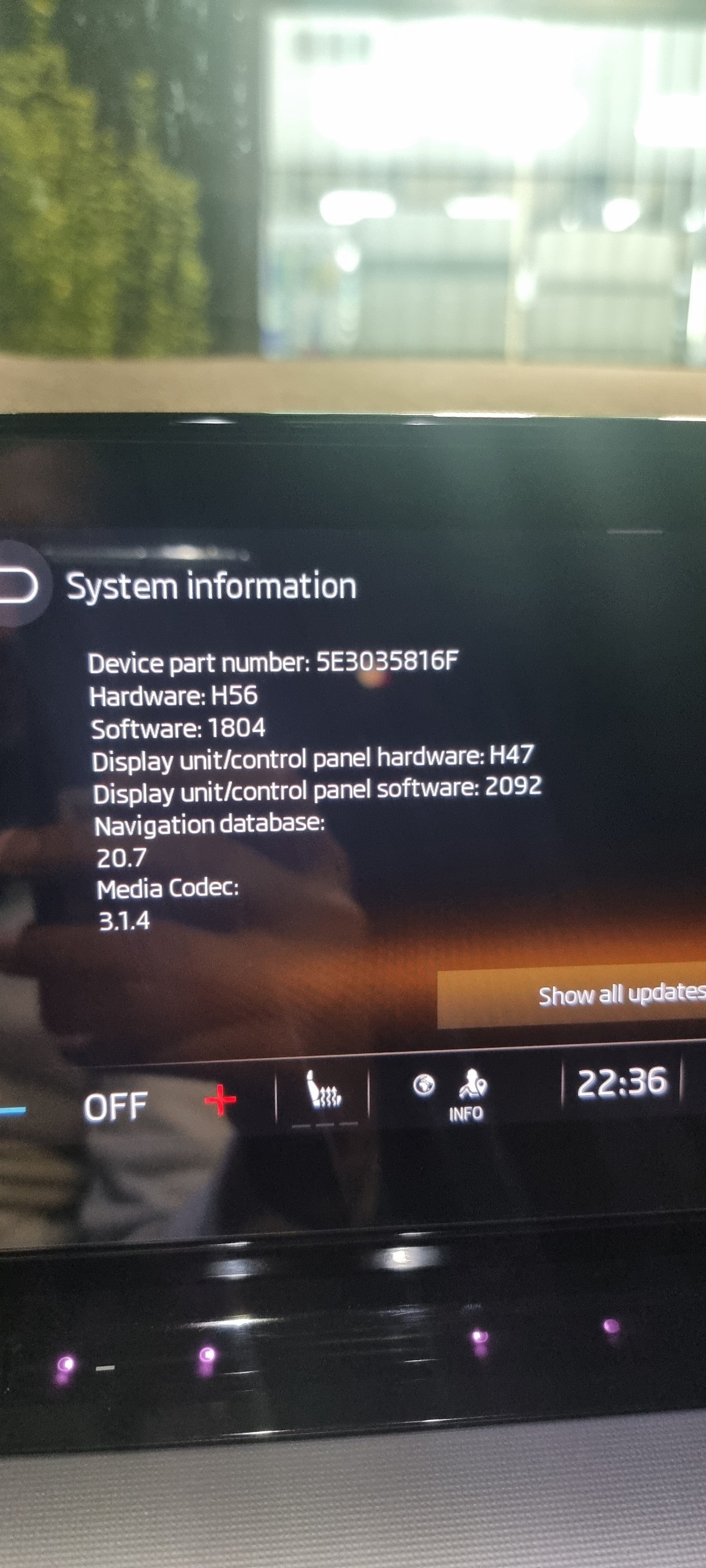

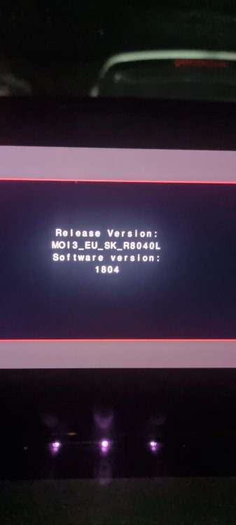

Skoda octavia 2021 i wil Update software and maps i have problem
I have a problem to update offline with my skoda octavia 2021 its not detected usbc, usbc its open files, but not open "started" tu update... i have usb 64gb i formated usb and file exfeta i uplod file tu usb .. all files download to skoda

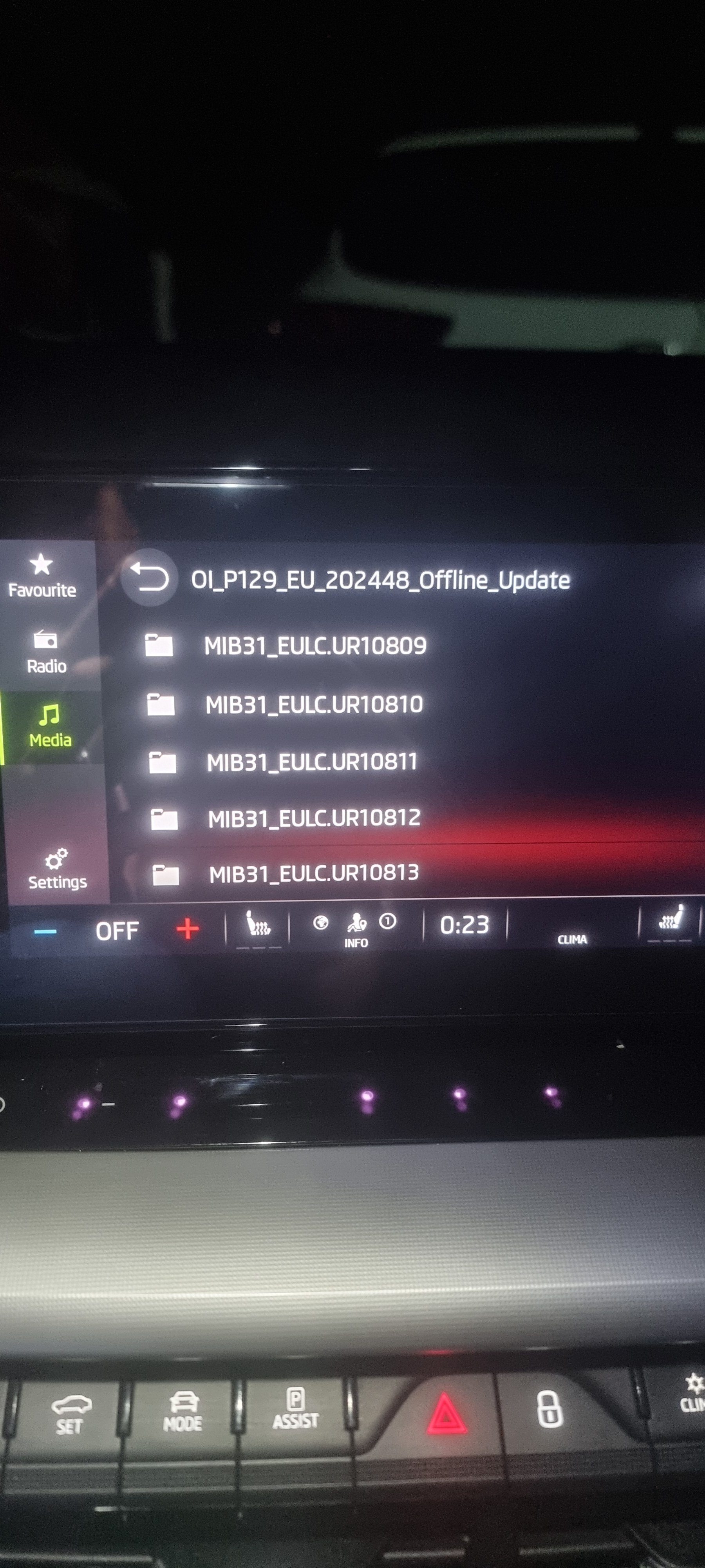

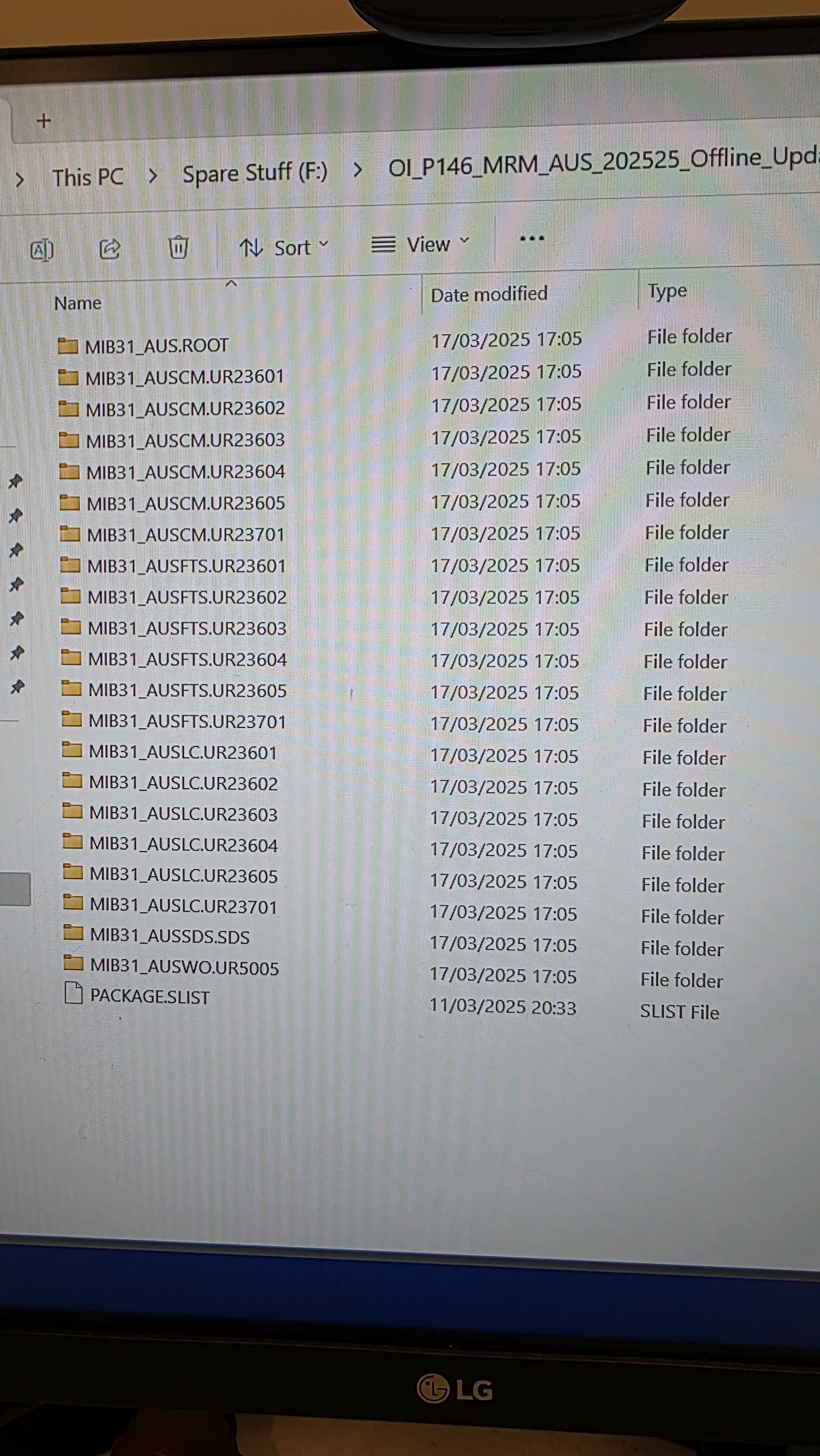

Yes instructions for MIB3 say only the contents and here is a pic of what I mean Folder name is at the top Contents in list and is what you copy to the stick Go for a drive It wont tell you anything so check your map version first and afterwards It works Did mine last week

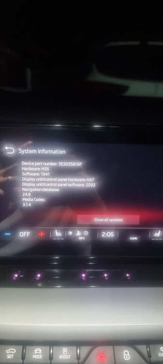

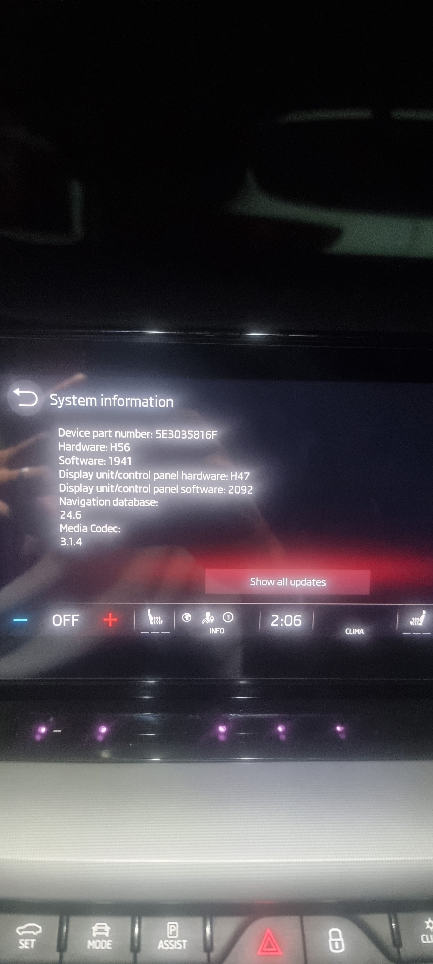

Yes this ok, i dont now what's happening i update maps and software 😀 is this new version of map and update or not?
Well did you look to see what it had before you started We dont know so you should have looked so you would know
4 hours ago, Exkiwi said:
EDITED
I see you had an earlier version in your first photo so I guess this is either the latest or second latest as there is a 25.2 out a couple of weeks ago
Thank you, i thing so software MOI3_EU_SK_R9850L 1985 and maps update 25.2
