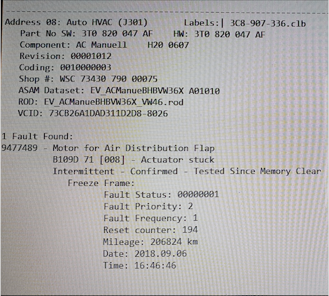

the ventilation through my dashboard has never been great so i scanned the car for faults and found one
motor for air distribution flap      actuator stuck
what issues does this cause and anyone know how to rectify it, thanks

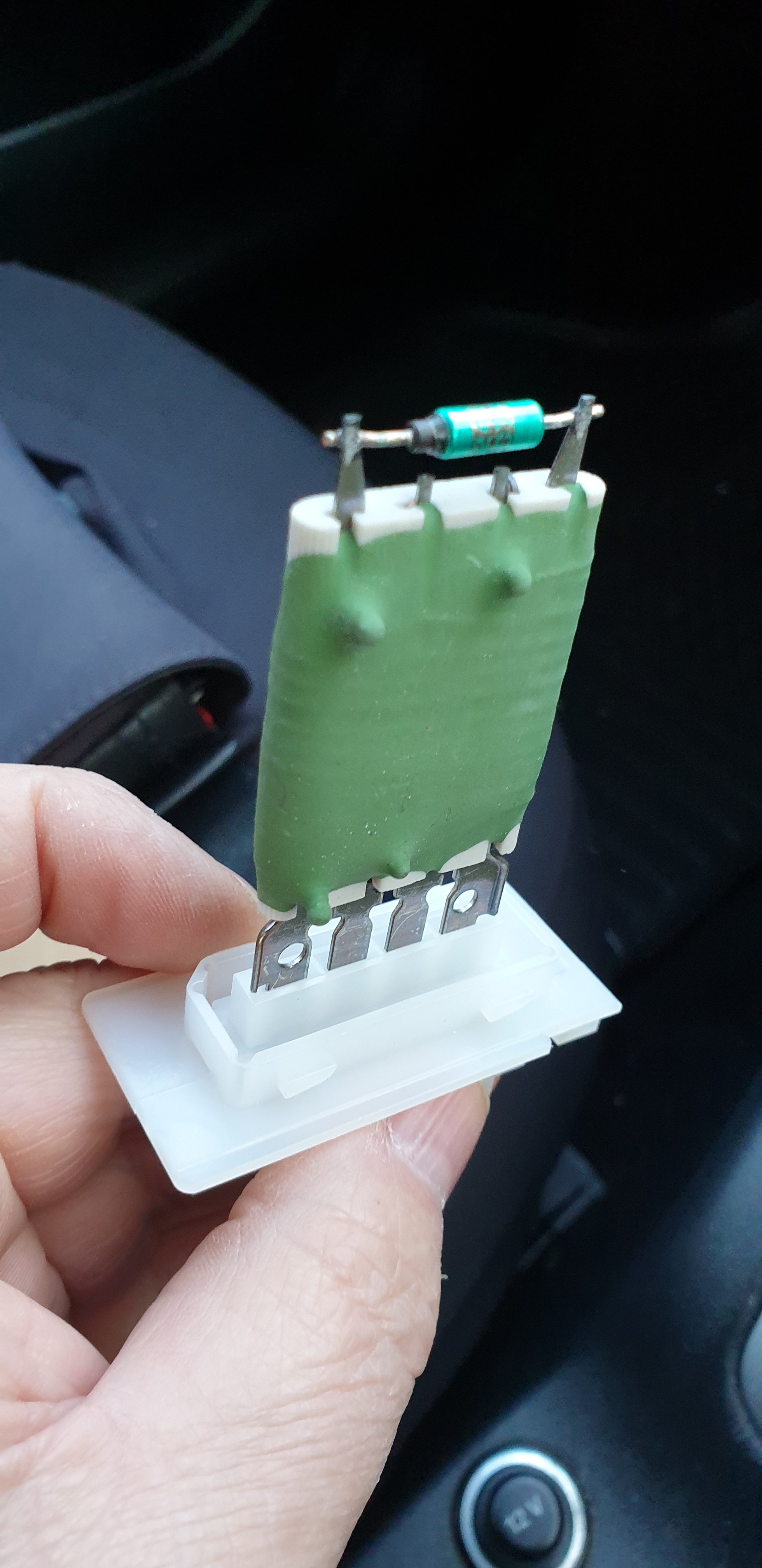

Believe the fault was the rheostat that controls the fan speeds. The motor wasnt working on speeds 1 and 2 and this was the reason the car wasnt demisting

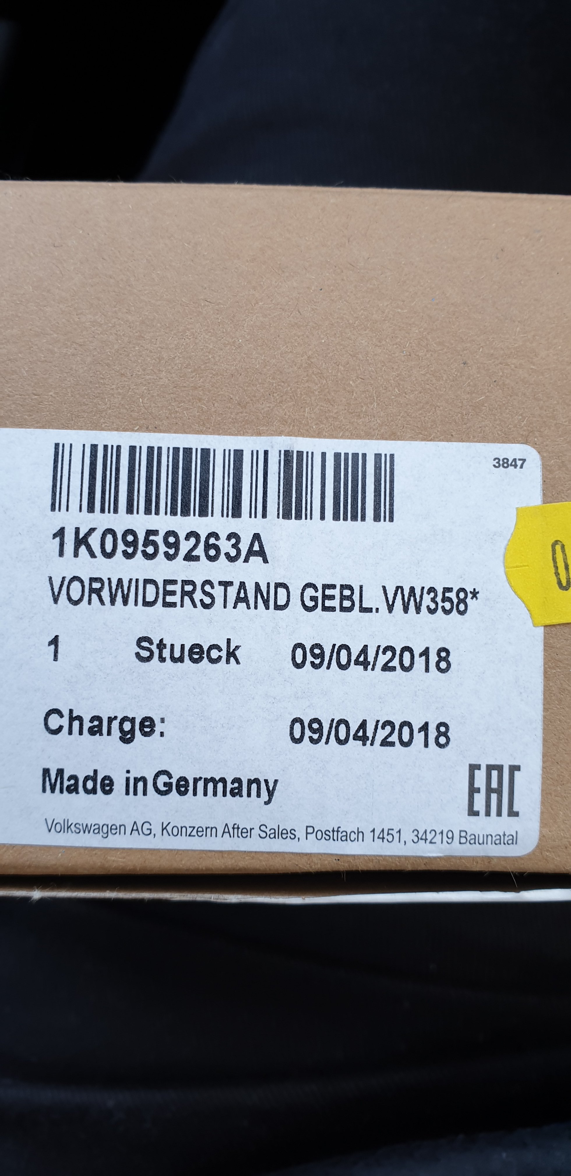

Part number 1K0959263A  £41.63 from pts
