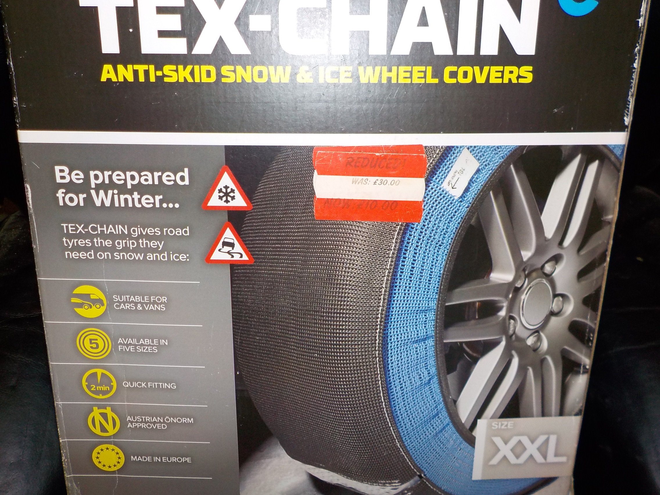

To get down ice there are better things to put on and off over the winter tyres if needs must just until taking off again.
Even Snow (****) socks can work until back on Black Top or gritted / salted roads.
Easy on and off if needs must.
