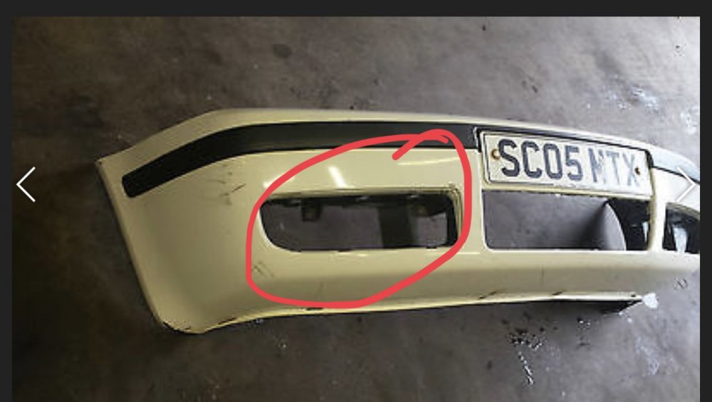

I intend on having someone tow me hone with a solid bar, but I'm not sure where the tow hitch is on the front. I'm led to believe it should be a screw in one, and the eye would be located in the spare wheel toolkit however I don't think it's in there from memory - if that is the case, are they fairly easy to acquire?
Thanks in advance
It’s behind the left hand bumper grill when looking from the front.
Cool thanks for that. Is it a screw in one or is it welded in place?
It’s a welded in loop.
