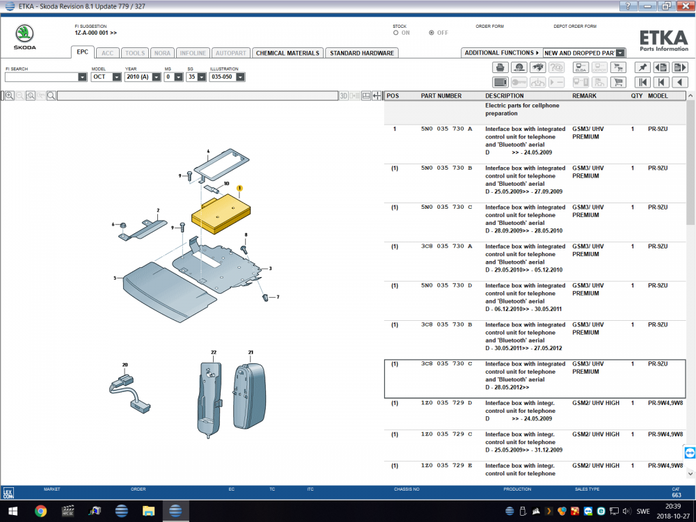

Correct, a 5N0 035 730 B  module only supports rSAP which is why your iPhone is sad.
5N0 035 730 D looks a good option, you also have 3C8 035 730 B/C/D/E which are slightly newer.
The BT module *might* be plug and play, it'll depend how the new module is coded. For best results, I'd suggest finding a local member with VCDS to do an autoscan prior to fitting the new module and to make sure the new one is correctly coded.
Finally, if you only get audio on one channel, you might need to add an extra wire from the BT module to headunit.
Thanks very much langers2k
If I use the later 3C8 module, do these have the same connectors and would this likely be plug and play?
Same connectors and pinout. Still might need coding :)

Hey @Moodilic, do you have a maxidot fitted?
Premium BT modules need a maxidot cluster to work properly. The 3C8 035 730 E was the last premium BT module released so it's the latest/most fully featured module available.
If you haven't got a maxidot cluster, you probably want something like 7P6 035 730 L. I'm sure some BT modules have compatibility issues with some Bolero headunits but I can never remember the details.
As for looms, they are readily available on eBay and various online stores. They just need connecting between the headunit and the car, it'll have connections for the BT module and mic included. Couple of examples:
- https://www.carsystems.eu/bluetooth-installation-kit-plug-play-for-premium-module-5n0-and-3c8-foam-cover,id117.html
- https://www.carsystems.eu/bluetooth-installation-kit-plug-play-for-7p6-and-5k0-module-foam-cover,id125.html
Edited by langers2k

In which case, 3C8 035 730 E is as good as it gets :)
Depending on your maxidot software version, some icons may appear as empty squares but it's purely cosmetic.

That's SW: 0110 so the oldest version. I don't know if the hardware can support anything newer..
Okay. So last question. Would 3C8 /E rev. work?
