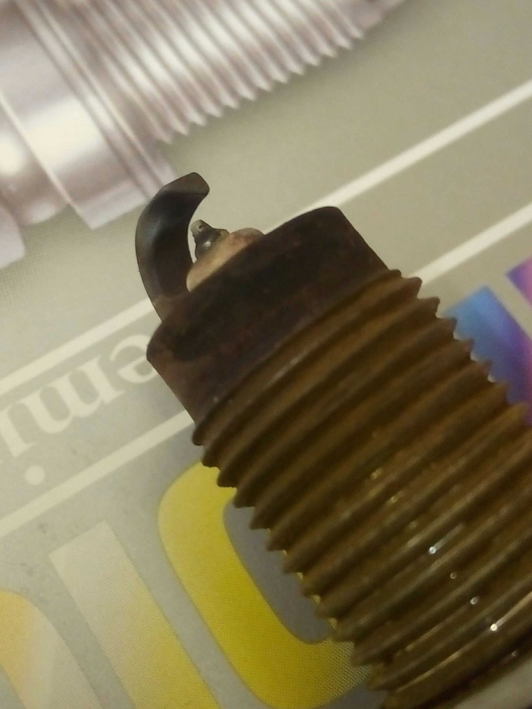

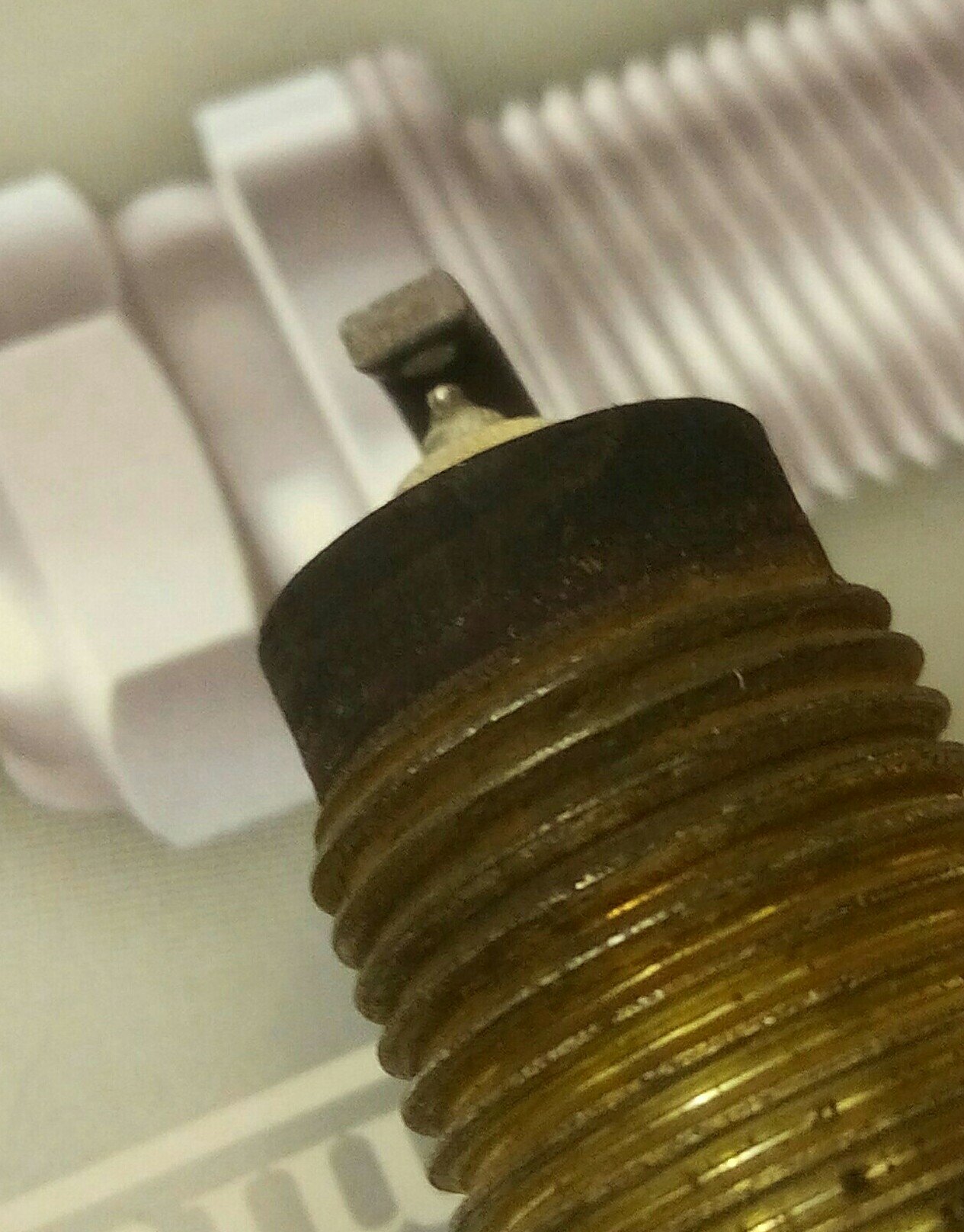

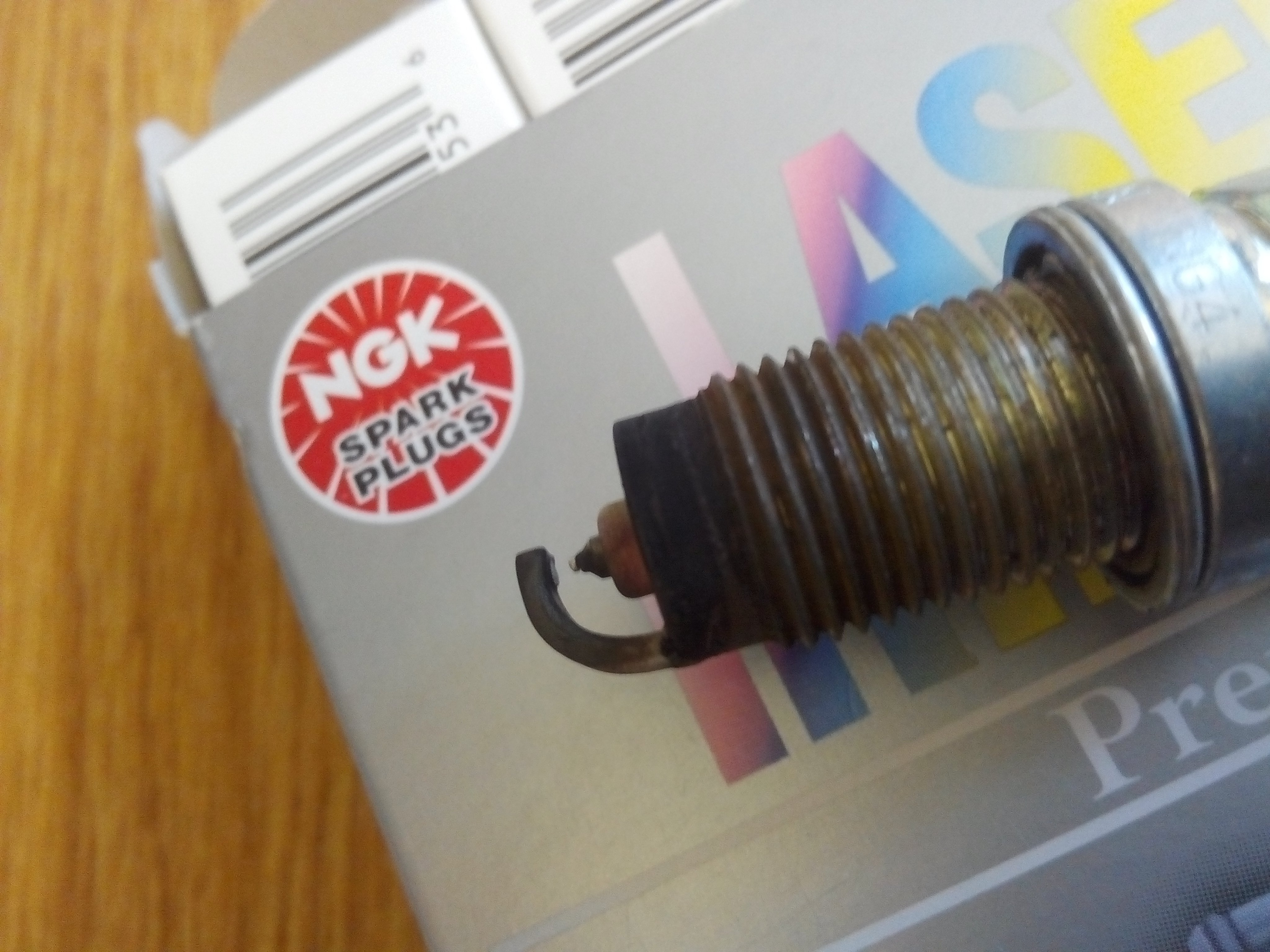

Photos of 3 spark plugs (can't find the 4th photo) taken out of Fabia CBZA engine at 85630 miles. Original never changed. These are the OE NGK plugs as supplied with the car new. 2 are perfect, the 3rd and 4th (similar to 3rd) has a softly worn ground electrode. The one shown had lost its platinum disc on the ground electrode. But still ran perfectly.

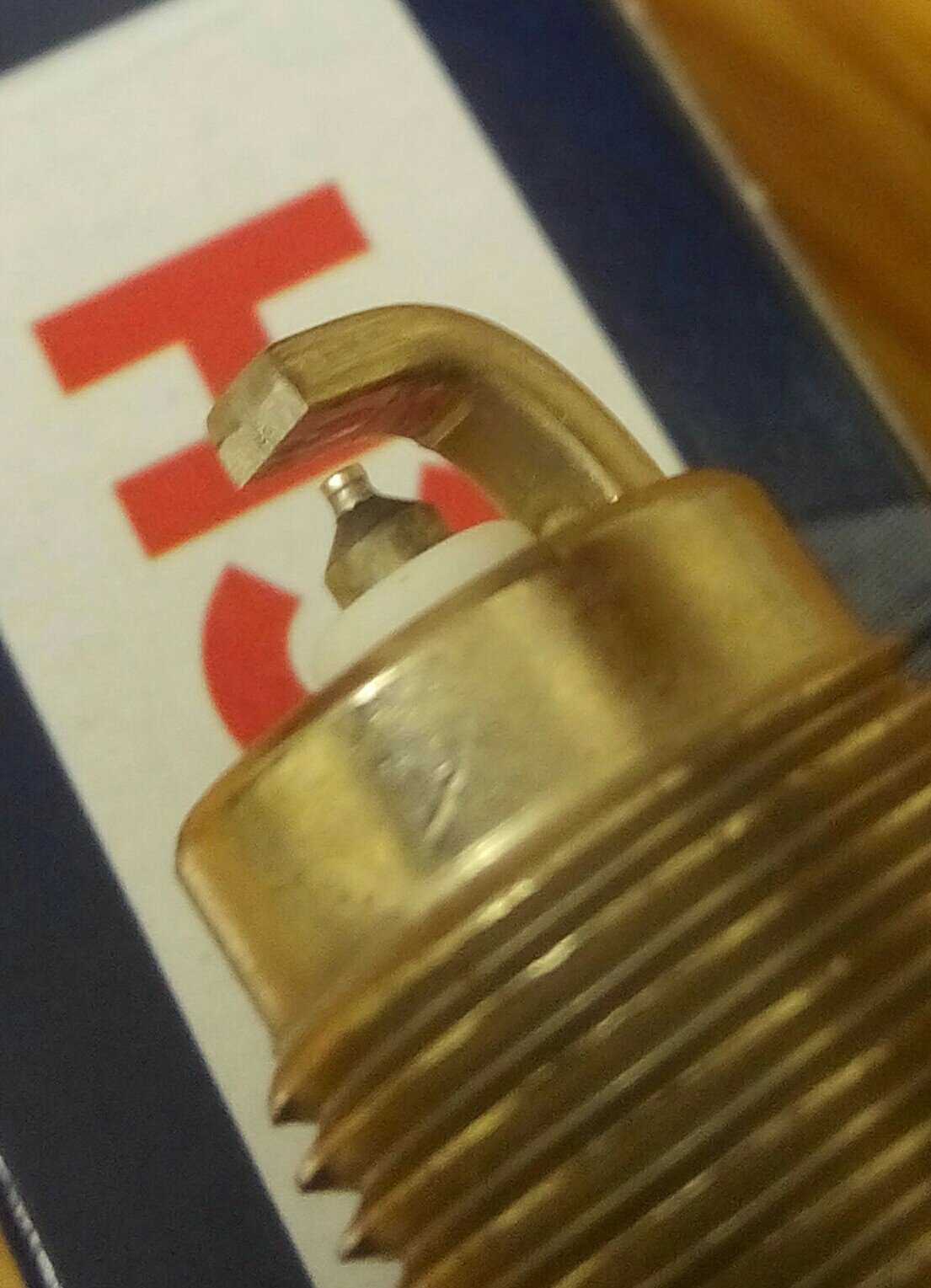

A set of NGK IZFR6P7 came in about £45, the alternative BOSCH Iridium Spark Plug 0242240665 at about £26 for 4, going to try them next time. Here's what they look like, the platinum is inset into the ground electrode unlike the NGK which is a welded add on disc
