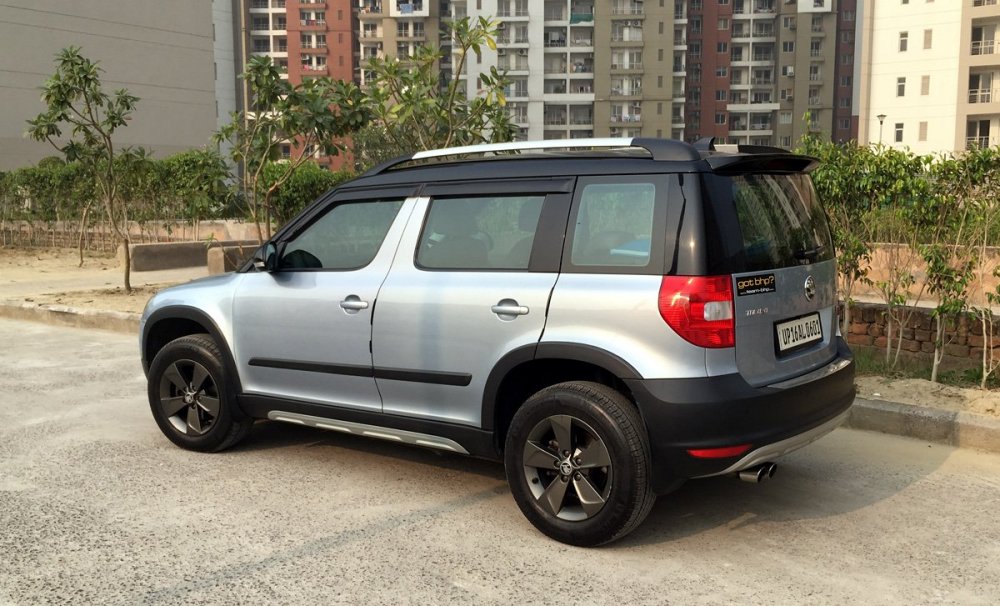

I have 215/65 R16 (Michelin Latitude Tour HP) on my Skoda Yeti 2012 Elegance 4x4 (TDi) for the last 3 years and have no issues at all and the clearance in the wheel arcs is abundant even after 2 cms increased in diameter. It is very hard to get a good tyre at the OEM size (215/60 R16) in my country (India) and hence, I and other Yeti owners have switched to 215/65 R16 (which is available widely as it is OEM tyre size for many other crossovers in our region e.g., Duster).
Thanks everyone for your replies.Bahrur your long term (3 years ) was very relevant to my query  and that solved the problem.Thank you again and that car looks good.Noticed the BHP sticker :)
Speedo must be reading a bit low compared to the actual speed though? I suppose it may have just cancelled out the deliberate built in error?
