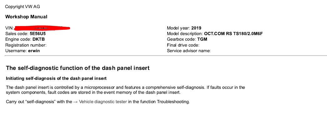

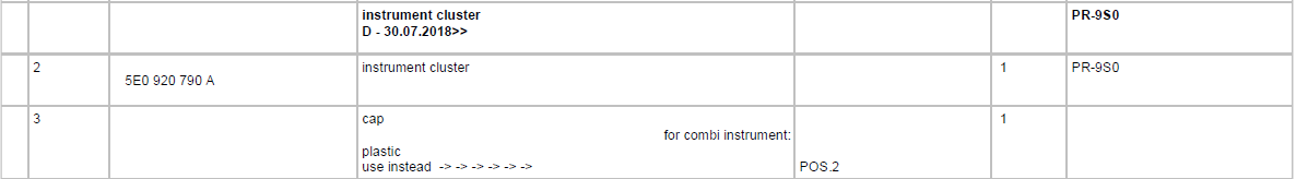

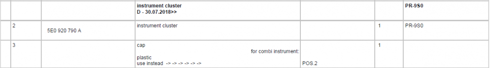

I have managed to dig into the details on erWIN and Partslink to find the exact part as well as ensuring the pre-requisites are in place (eg. Columbus Nav etc.)

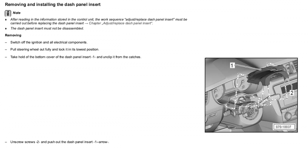

So the part I will need is the 5G1 920 791 A; no problem I have been able to source a new one. The fitment as per the erWIN Manuals is pretty straight forward. The major issues now are:

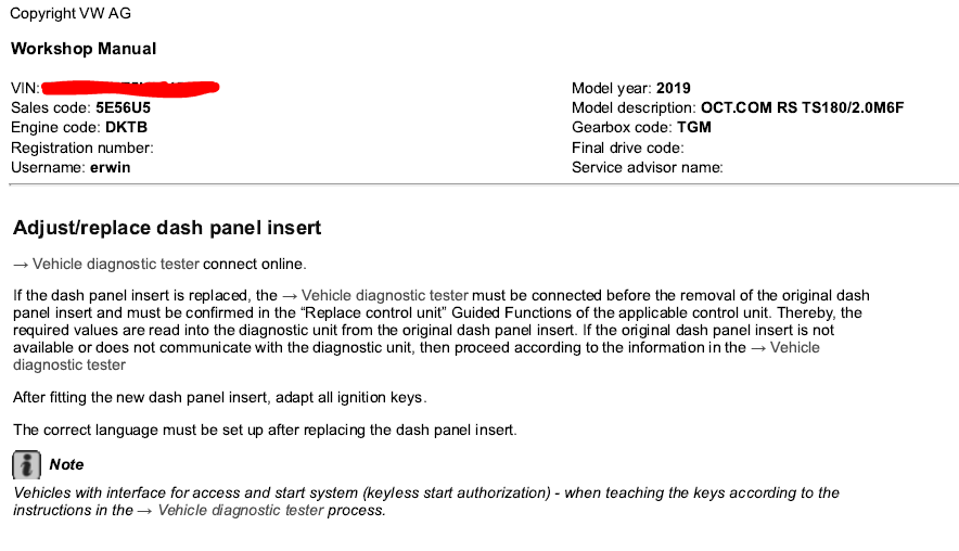

2) From the repair manual there is a note about the immobiliser and key matching; has anyone had any experience with this? Of course no point in having a new Instrument Cluster and not being able to pair the keys
It's been done on the MK7 Golf but it's not trivial and may require other modules coding, updating or even replacing.
The immo will be hard as I doubt many tools support it, you might need to upload datasets to certain modules too. Neither of these can be done with VCDS.
