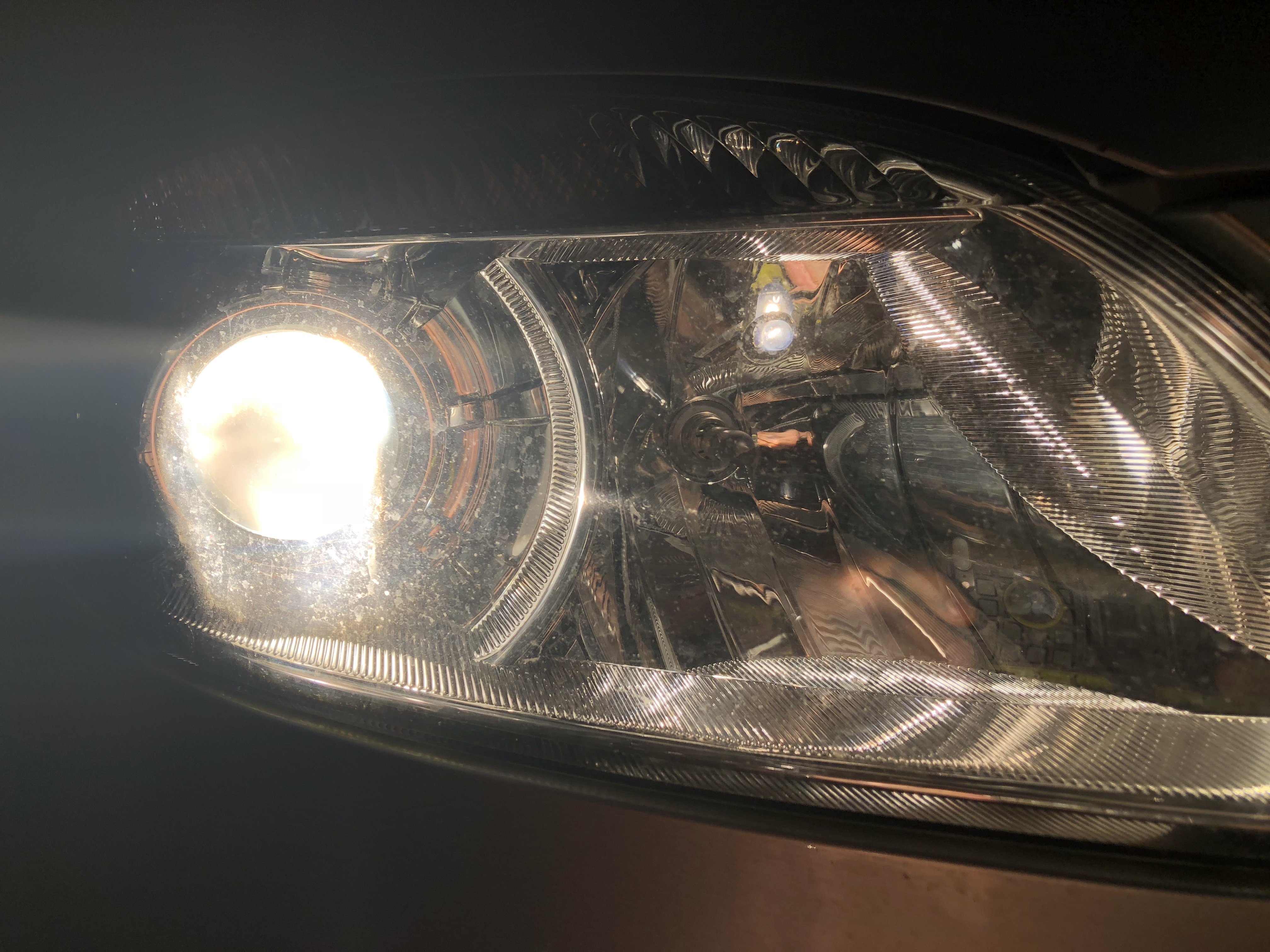

It’s a 2014 1.6tdi,cr105 no dlr or any in bumper and has wedge pilot bulbs

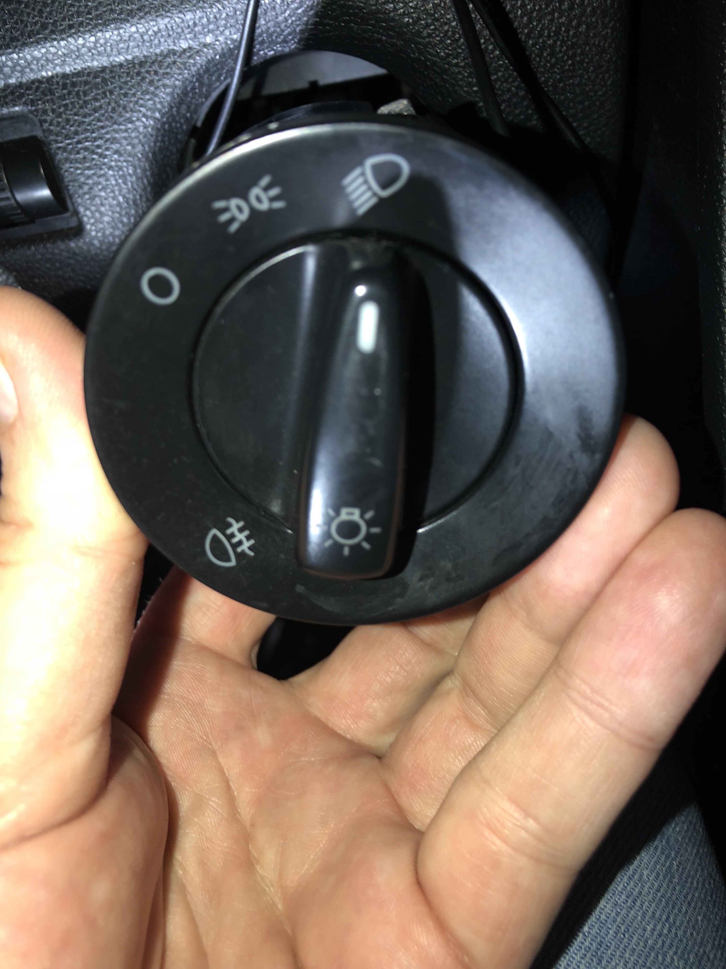

To me i would think if on with headlight, low and full beam it is the switch as the issue.

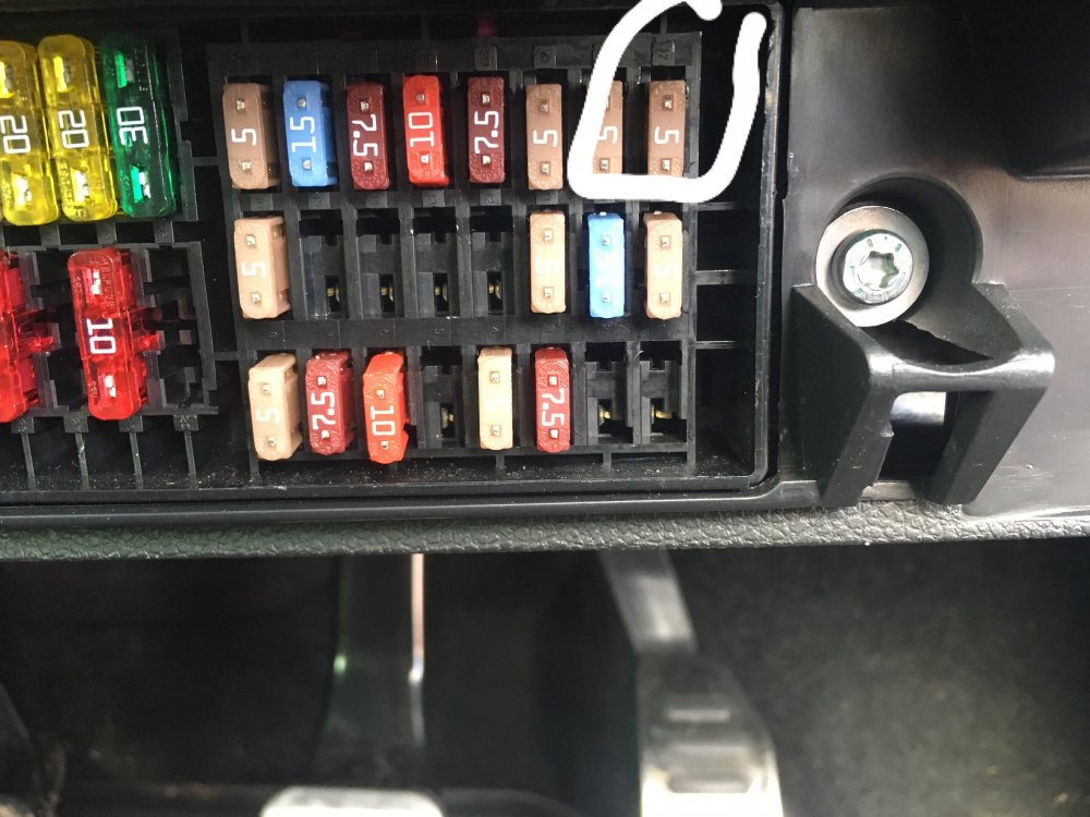

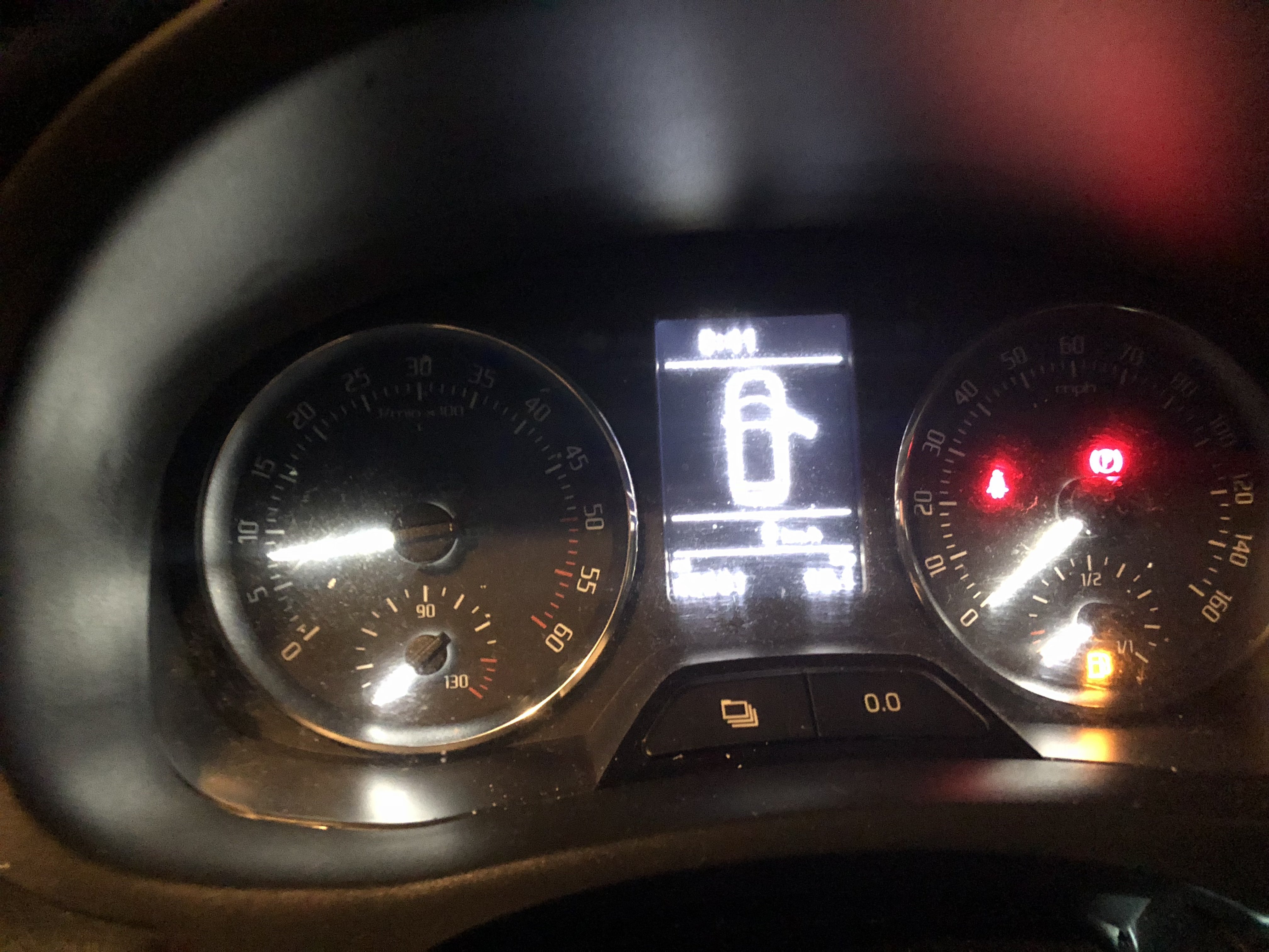

Clocks don’t illuminate if on park or rear bulbs unless low beaming E841AEAE-1695-4ED2-B18A-8AA0FB9B32CC.thumb.jpeg.63dcd2f76e7934c74a410aa946f0e442.jpegE841AEAE-1695-4ED2-B18A-8AA0FB9B32CC.thumb.jpeg.63dcd2f76e7934c74a410aa946f0e442.jpegate

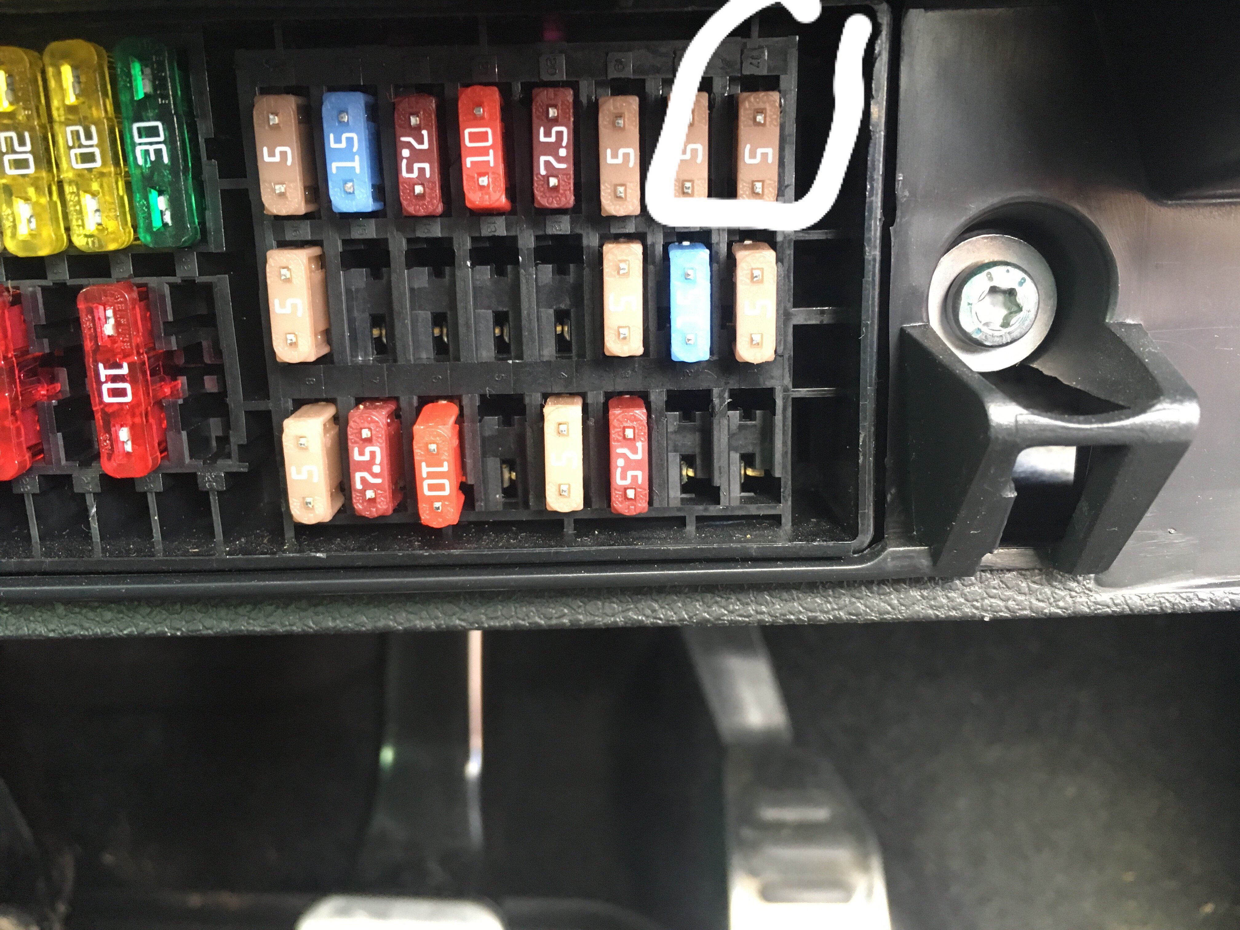

Ah ok that’s a fuse it’s the light switch power one that’s went.
Thanks buddycwhich number as I’m dhort sited bloody numbers ain’t easy to read as is. If I knew which wires were from sidelights to switch I would test but very gratefull of yr help
It’s 17
Thanks so much buddy hope it sorts it , I find it odd how sidelight ok when low beam is on, I used to work st F1makiny wiring looms but making a loom is different to being a electrician
Do you get on one front and one rear sidelight and the registration plate bulbs or one bulb when the Indicator is down to put on the 'Parking Lights' ?
Will update after 2pm cheers
Yr a star end 5amp blew, you pointing which one helped me so much less stressed now cheers
If you were close I’d buy u a beer
It’s ok I don’t drink anyway lol I upgraded mine to a 7.5
