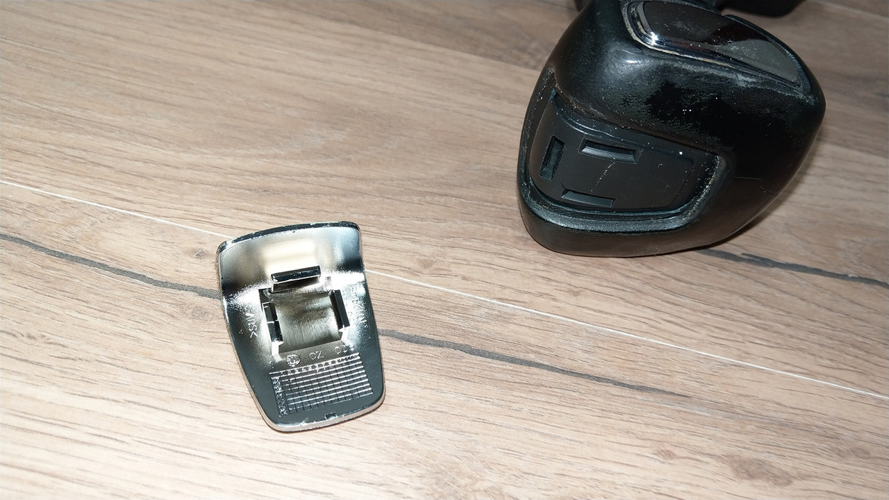

On my Superb 170bhp DSG TDi i have an annoying problem. The chrome of the DSG gearshift is a bit loose.
On the top it is fine, but in the front, right where the plastic chrome meets the leather it comes off.
I already removed a bit, because there were a few sharp pieces standing off.
Is it possible to remove the top and replace it? Is it screwed somewhere or glued?
How can I remove it safely?

Just pull gently on the top element until it unhooks, start from the front side (that is pointed towards the central console)
Thank you, it worked quite well.
I used my ifixit tools to pry it off.
That leaves me with a spare.
