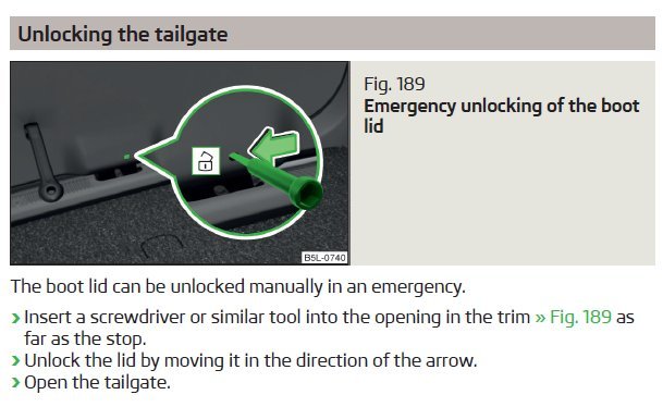

Do you mean the hole for the emergency boot opening near the catch or where the boot handle attaches?

Well my friend, you have sussed this! Thanks! Must have had something plastic crushed between the tailgate and the latch. That's a relief!! Thanks again!
