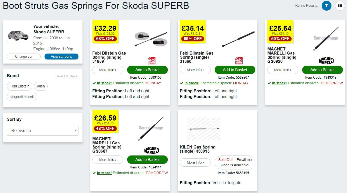

at those prices i'm tempted to replace ... but i cant actually see these; as you do on other cars..are they hidden deep down somewhere?.
what's that site please
Here you go...

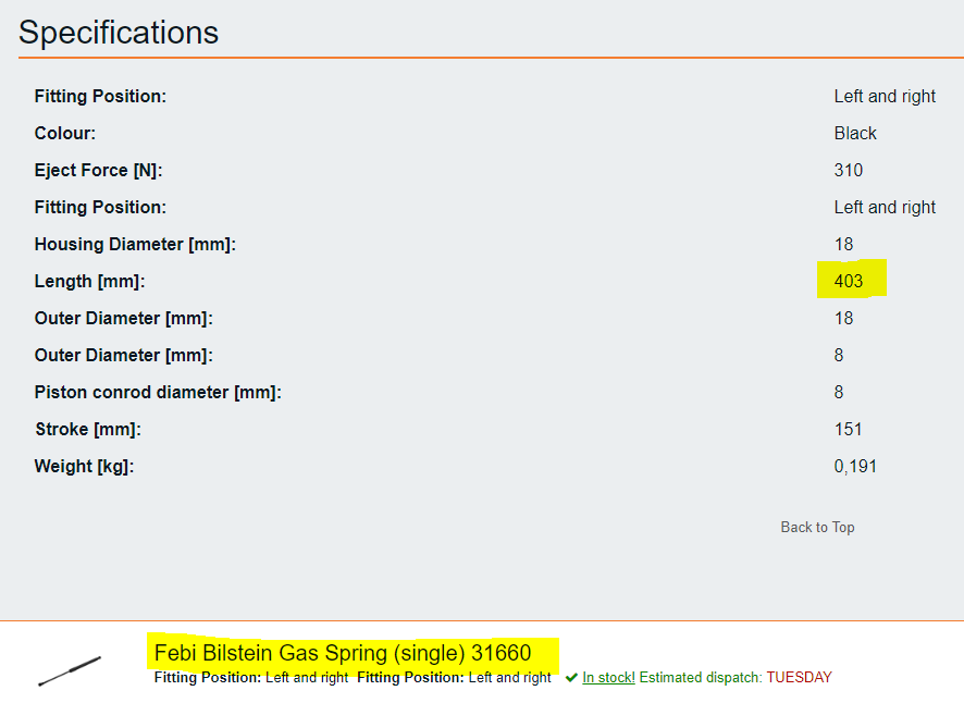

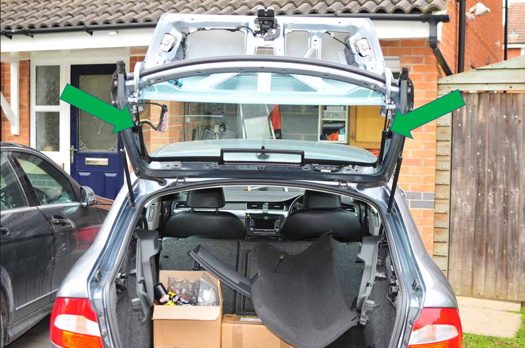

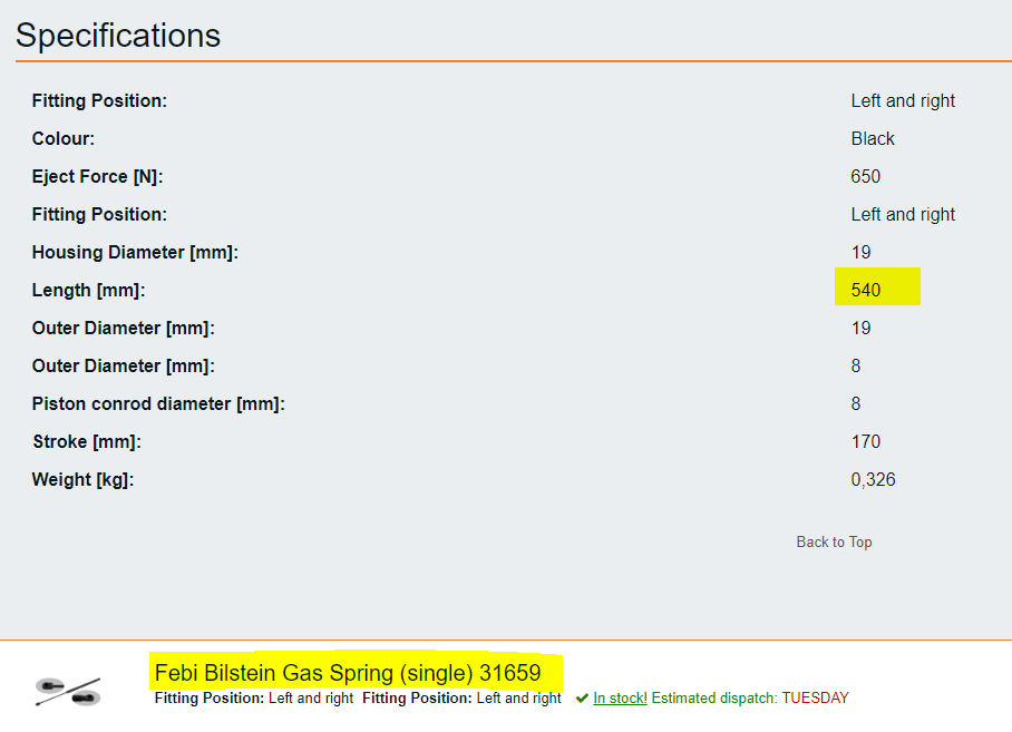

Notice, there are two struts per side, four in total, one shorter set for saloon mode, a longer set for hatchback mode. Unfortunately the ones you need to access are the short ones that are the hardest to get to.
https://www.micksgarage.com/d/boot-struts-gas-springs/skoda/skoda-superb

Yes, from my picture above you can see the shorter struts are for the saloon mode, the longer struts are for the hatchback mode.
The longer hatchback struts are exposed. Measure them and you'll be able to eliminate them from your search.
