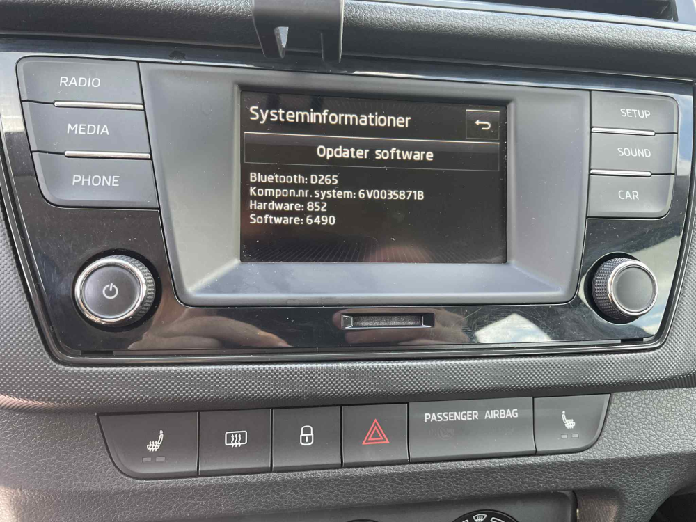

Hey, I recently bought a Skoda Fabia Mk3 and I want to upgrade the infotainment unit from the 6V0 035 871 B (i think?) to the larger screen (6V0 035 869 H maybe?).
I was thinking of buying a secondhand unit (preferably one with SmartLink activated) from another car, but I'm not quite sure if it is plug-and-play, or if it's even possible.
Anyone who knows if this works, and can share their knowledge? :)
The VIN is TMBJN6NJ8GZ021002

Possible but:
  1. New unit must be assigned online to your car (component protection removal) by Skoda dealer or someone with ODIS ONLINE account for Skoda.
  2. SmartLink will stop working after few hours (up to 8) and can NOT be officially activated. The only possibility is to have the new unit patched. Unfortunately I don't know anyone neither the way to have it patched. It's possible to patch Bolero or Amundsen unit but this requires more parts to be replaced (display unit, infotainment reader, harness to connect both units and, if you want to use CarPlay, then also USB, port).
