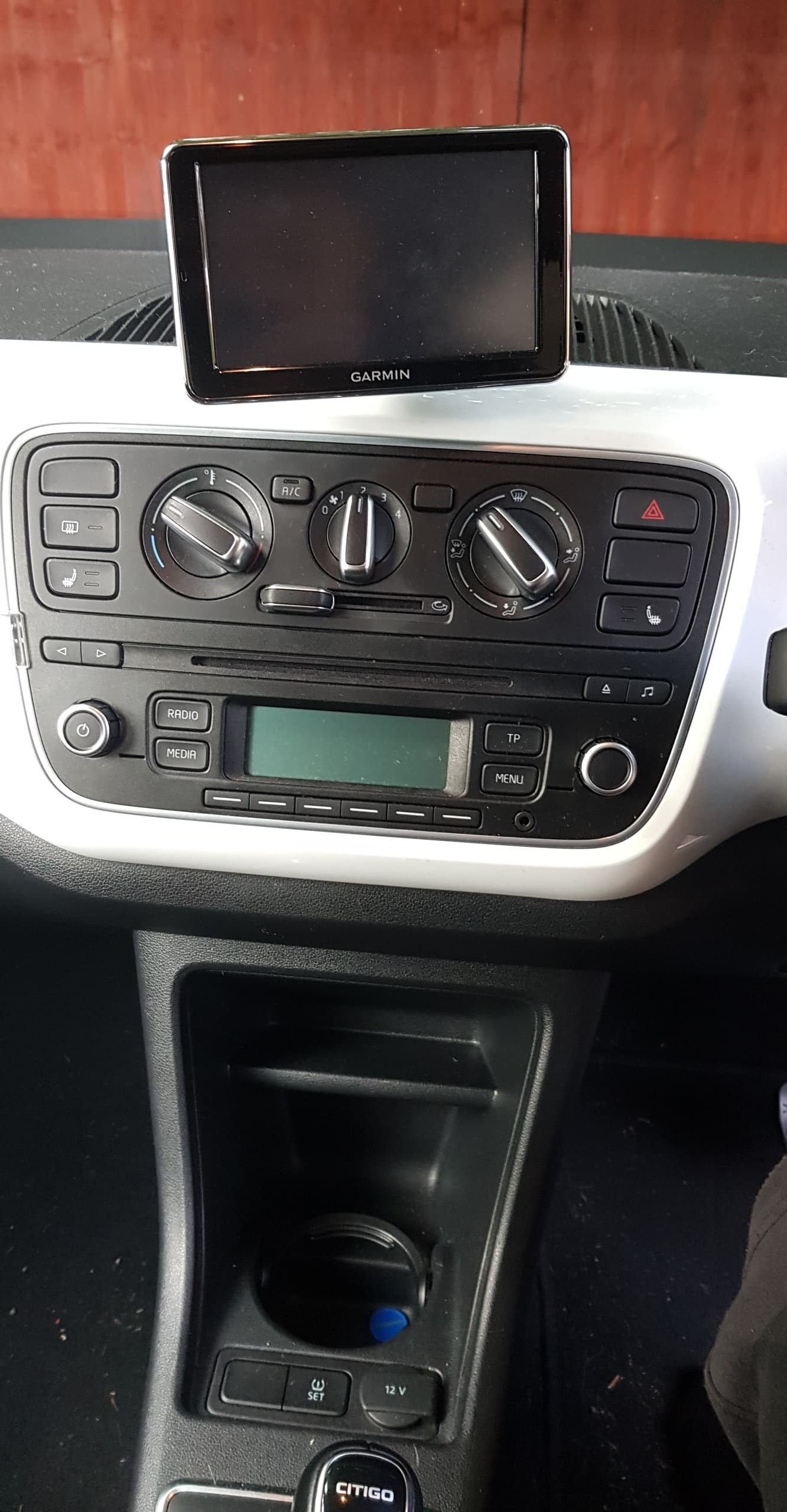

Hi Folks
Just looking for dab upgrade  ideas for my sons citigo Monte Carlo
Cheers
