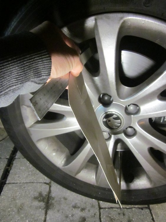

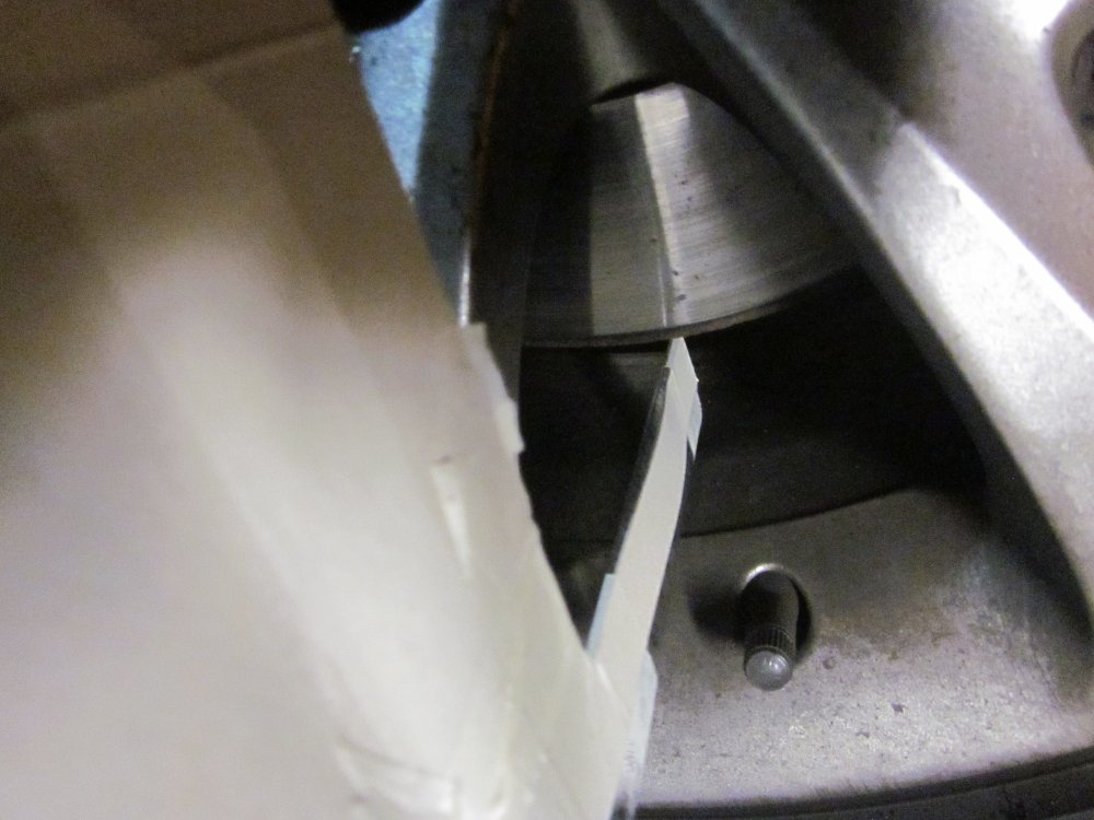

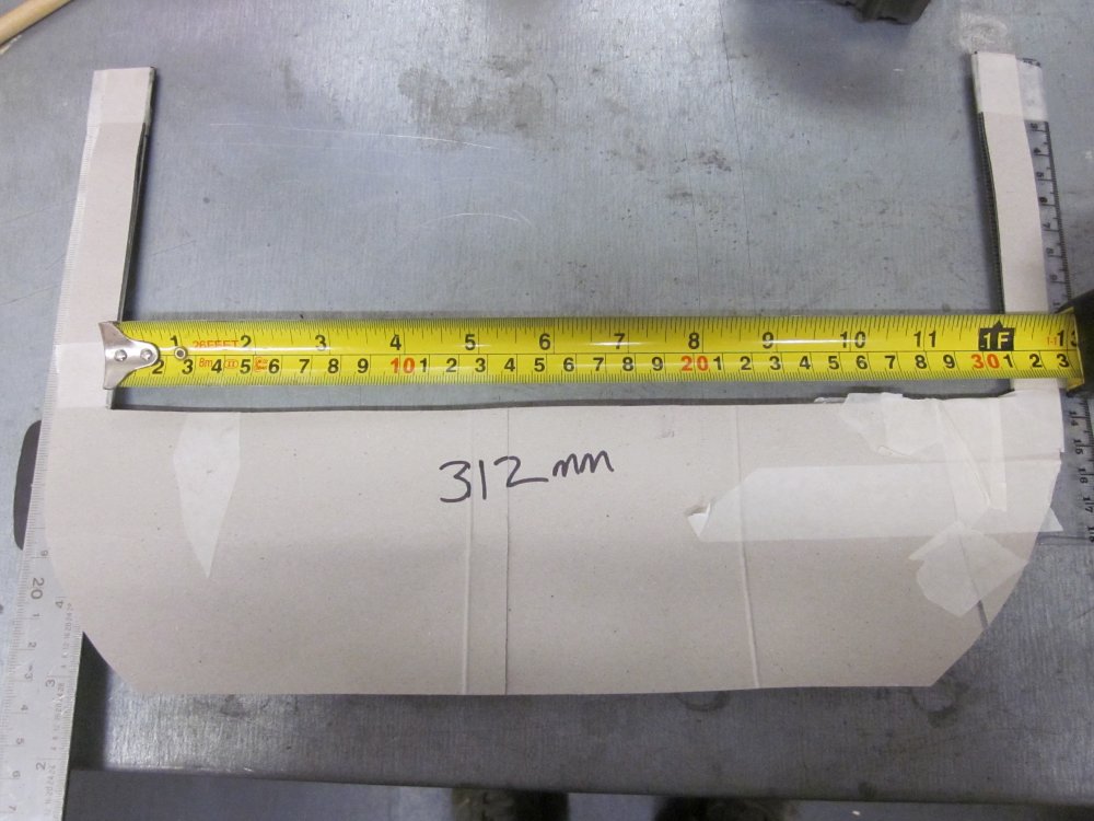

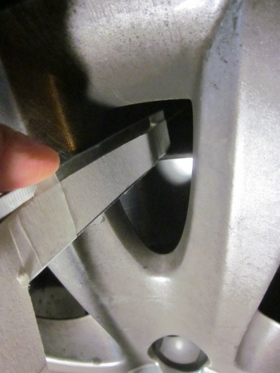

This was me in the dark on my drive :D
The front brake disc PR code was annoyingly absent on my Superb too..
  • Sponsor
Good skills with the measuring jig though! :thumbup:
