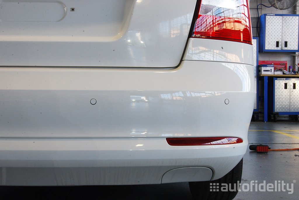

Can you post a picture of one of the undamaged sensors? From your existing picture the others look to sit slightly proud of the bumper, suggesting they're an aftermarket version, rather than factory fitted.
MkII Octavia and race blue paint suggests a vRS. Rear parking sensors weren't standard on the vRS and as a result there are an awful lot out there with non-genuine sensors fitted.
These are genuine, factory fitted versions...
Skoda-Park-Pilot-Front-Rear-Parking-Sensor-System-with-OPS-Optical-Display-for-Skoda-Octavia-1Z-3.thumb.jpg.9284bcae9df63b8645c47c3e1dbd233f.jpg

Highly likely to be aftermarket then. Well done on finding a version online with the same connection, they look to be plug-and-play too which should make it pretty easy to replace it!
Blowing over them with a rattle can should be OK, no doubt the instructions with the replacement will give guidance. Just don't get carried away and add too much paint, or it might affect the sensitivity.
