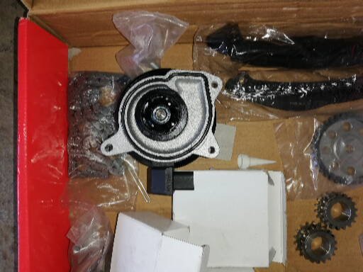

The link with parts and prices is in a post up the page.
Likely it will be the Water Pump / Supercharger Magnet Clutch, Belts, seal and coolant needing replaced.
