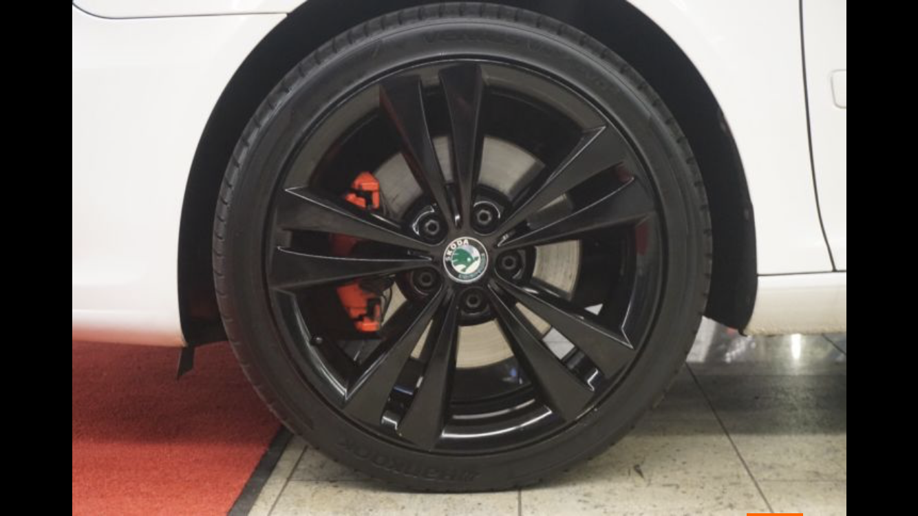

In the equipment list it says:
1KT Brake type in rear: Disc brakes in rear (Geomet D)
1ZB Brake type, front: Disc brake in front
Added a photo of them, maybe it helps?

Pretty sure a stock 16" tyre/alloy combo will be 205/55 R16 on a 6.5Jx16 ET50. It'll be a 5x112 PCD and 57mm centre bore.
Original alloy should fit over the 312mm brakes without issue, I'd suggest you check aftermarket ones to be sure.
