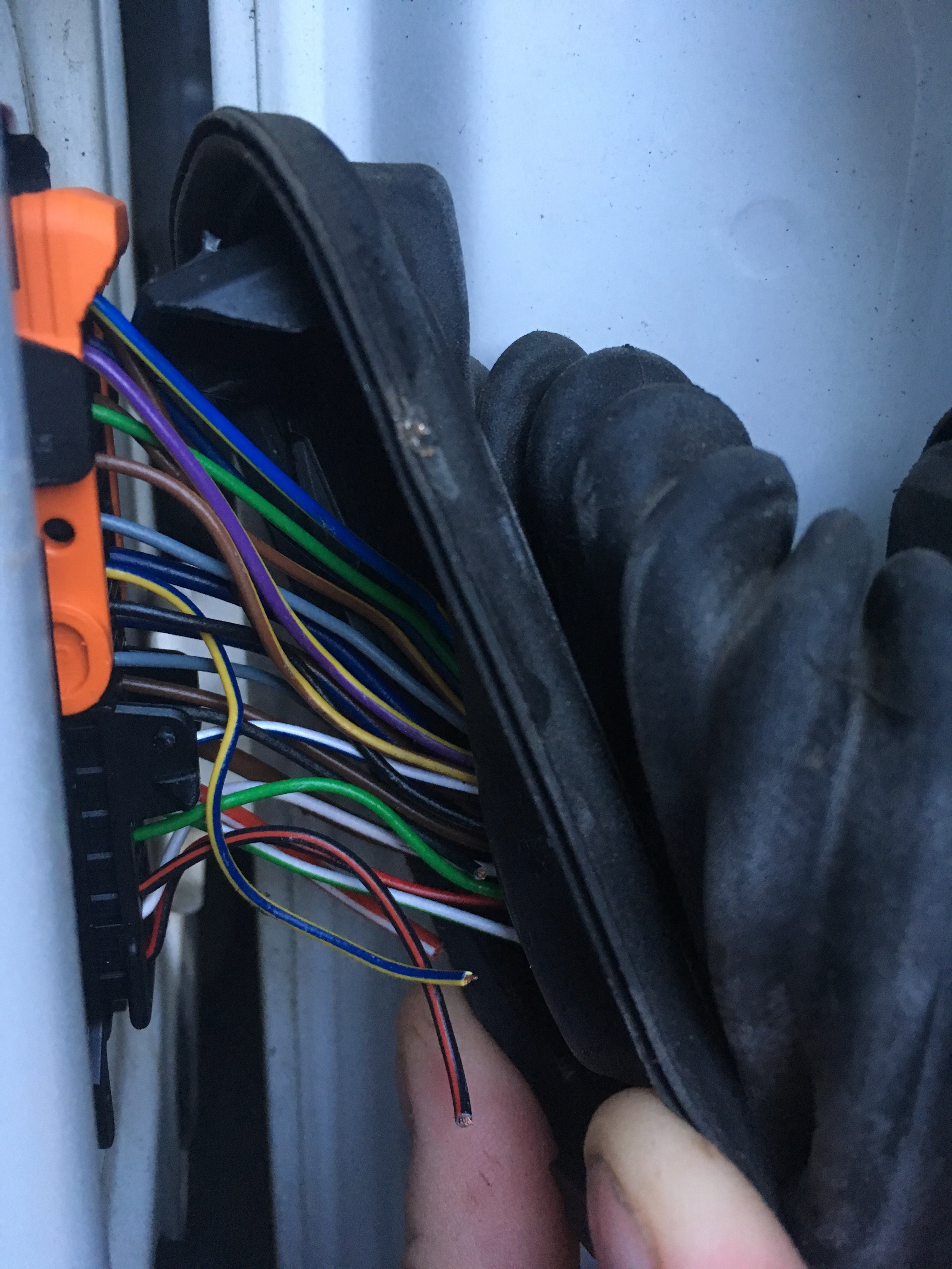

another gremlin with my 2014 Monte Carlo
the drivers side window switch will not put the windows down or up but the passenger window still goes down using the passenger side switch
the passenger side switch on the drivers side does not work either

Wiring in the door gap if you pull the rubber bit back you might find broken wires.

Check both sides. The wires snap inside the bellows. Common, well documented issue!
Thanks is that the black rubber bits between the door and the body in between the hinges
Six broken wires

There’s your problem, if it’s still under warranty take it into a dealer if not any decent local auto electrition could sort it out.

Fair play, A lot of other members have had bad issues with this. One member actually stood up fought against skoda and managed to get his fixed under warranty if you have any.
I had this, auto electrician charged me £20 to sort. Not major but still a ball ache of a problem
