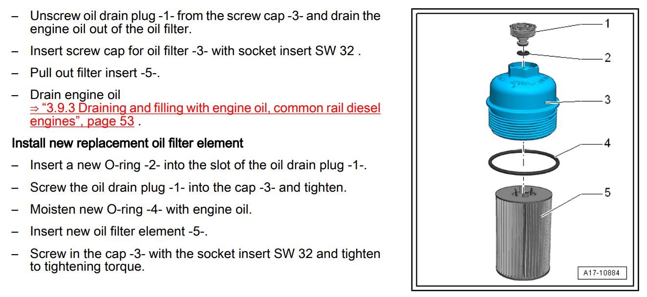

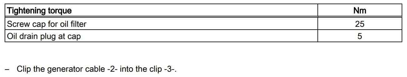

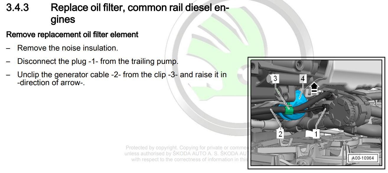

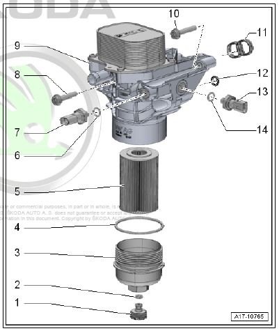

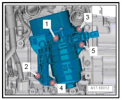

The oil filter housing is underneath the oil cooler...
Ah, that's brilliant silver. I'll have a look before it goes in for its service.
