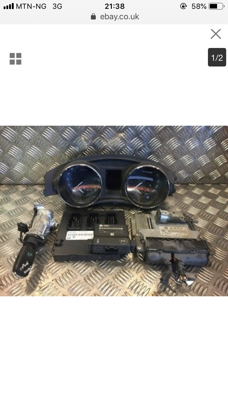

I found this on eBay but this is for a diesel engine and I drive a petrol engine

The ECU from a diesel will not work on your petrol engine.
You need to find exactly what ECU your car uses and find one that matches...
