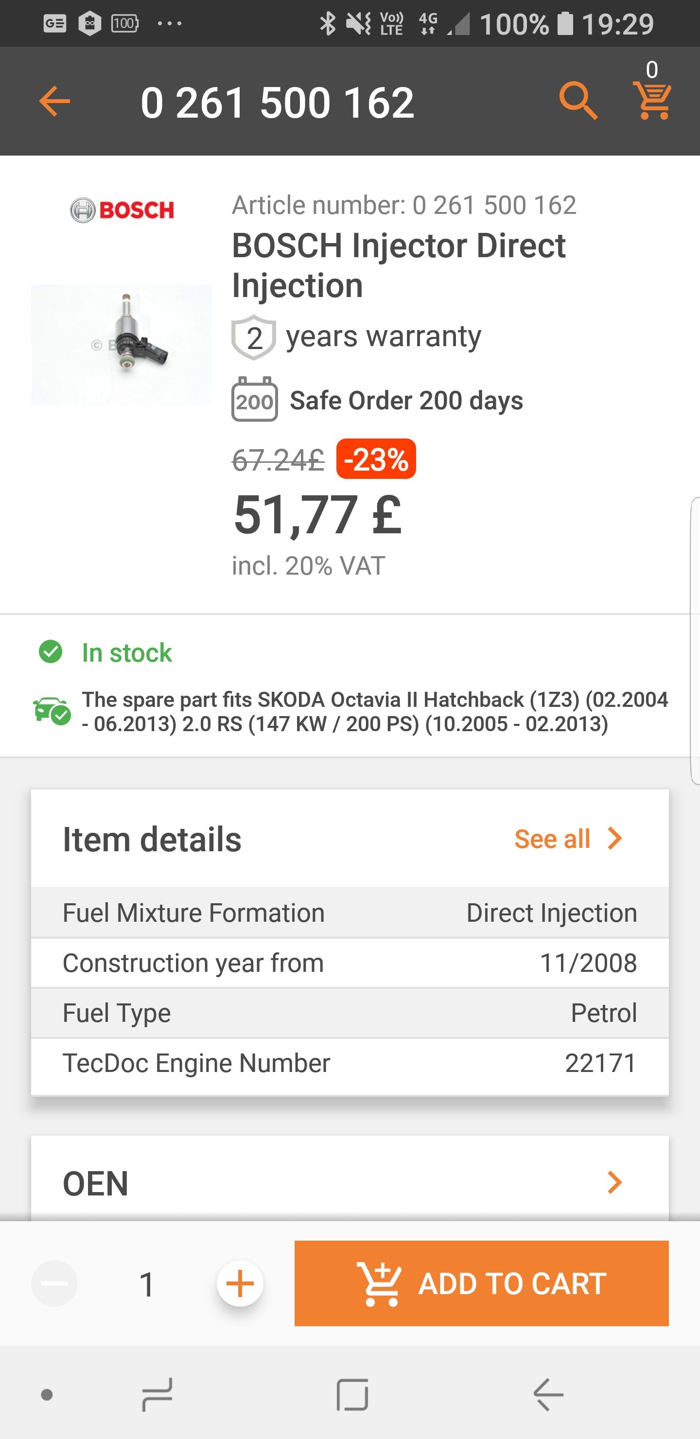

Ive purchased Bosch injector 0 261 500 162, is this deffo the correct one?

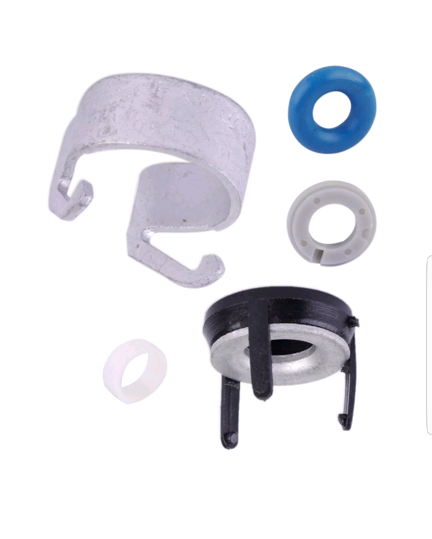

Also do you need a injector seal kit for the petrol vRS?
Many thanks
Just in case anyone searches and comes accross this in future the VAG OEM part for the seal kit is 06j 998 907
I believe the new injectors already have two of the washers and teflon sheath pre installed, but it will have the metal bracket and washer.
