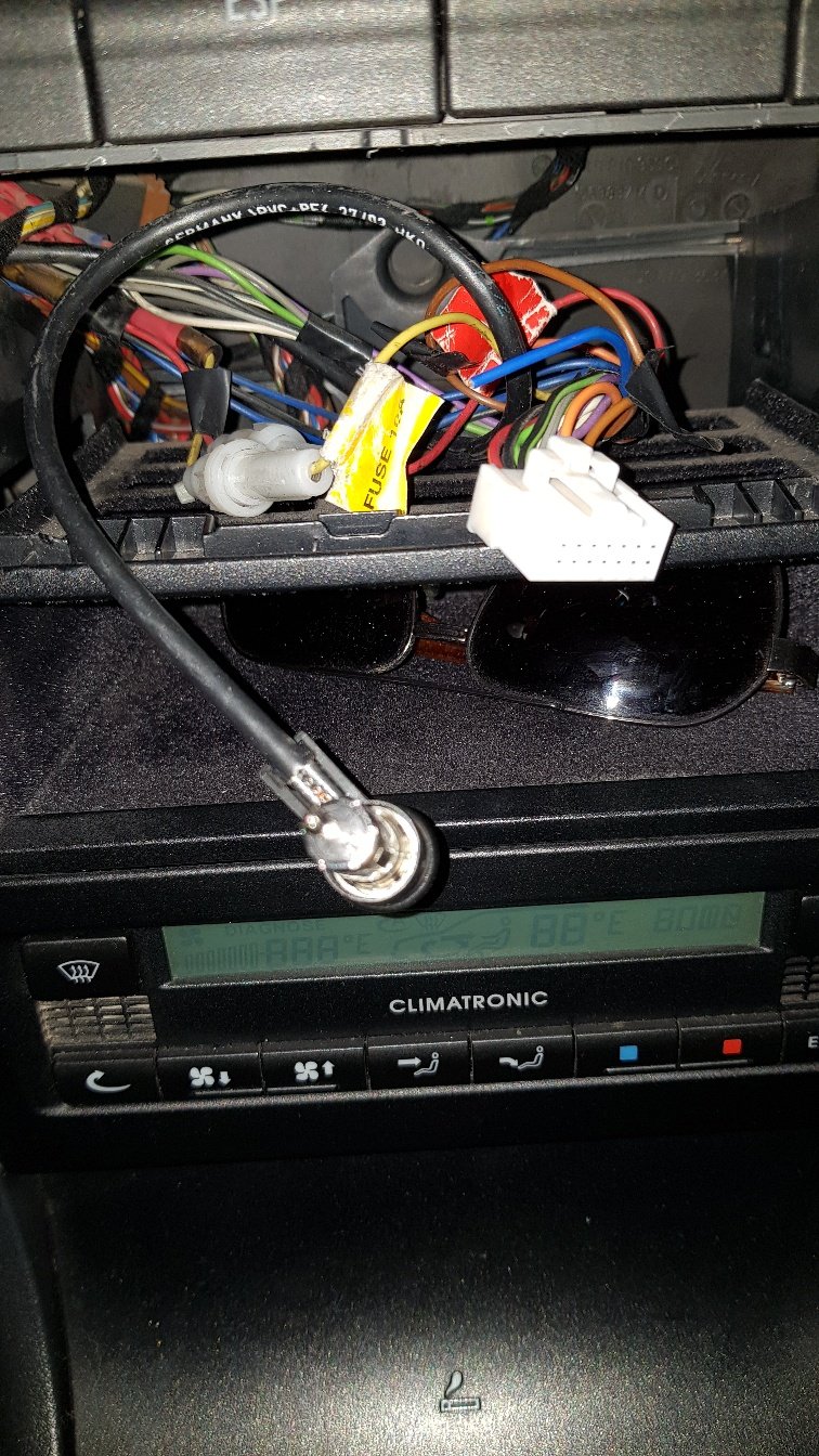

I am new to this but I am trying to replace the Pioneer radio from the car with an alpine one.
https://www.alpine.co.uk/p/Products/SingleView/CDE-104BTi

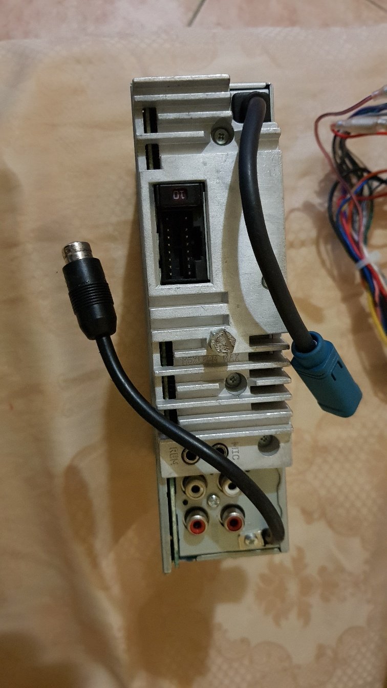

Is just the connections are totally different.wh at exactly do I need to do?from the car I can see it's only coming out the white block connector and the aerial.
Thanks

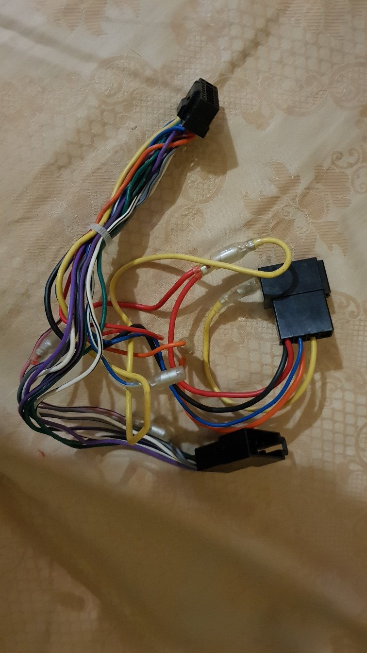

Did the white plug previously go into the back of the Pioneer unit?
If so, it should have two plugs on the end the same as the Alpine lead does, so unplug that and plug the Alpine in. Make sure they are connected to the correctly (check the Alpine unit's manual if you're not sure).
You will need an adaptor/booster for the FM aerial by the looks of it. Have a search in this section for more info.

Thank you!!!sorted!!!
