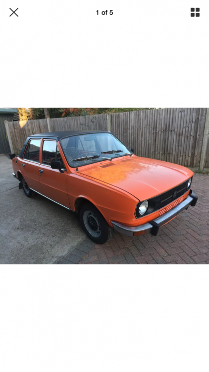

What reg plate is your car on? I assume it's a Super rather than a mk1 judging by the vinyl roof?
Edited by petergarforth
I emailed Webcon sales and they replied that a service kit was in stock which should fit my car. Skopartde will be my preference given the recommendation given. There are a couple of parts I'll probably order from Skopartde which should sort out my car without having to buy a full service kit. The main part needed is an accelerator pump diaphragm, the old one is shot and leaves the poor car gasping when flooring the throttle.
My car was originally imported from Hungary and is a left hooker. It's on an age related W plate. The vinyl roof has been added by the last seller, there's an interesting story behind it which I'll try and expand on shortly.
