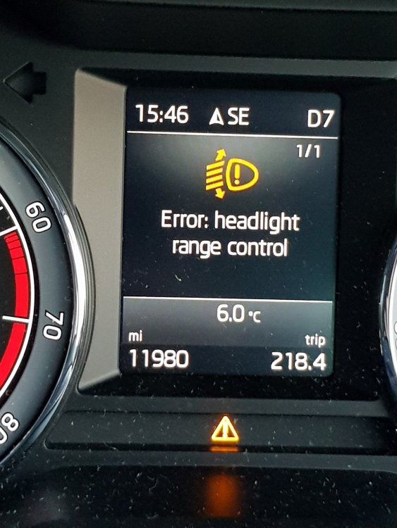

Good morning guys Merry Christmas to all of you. Yesterday i have started my car and suprise suprise this warrning has pop out and it hasn't gone away and my cornering lights stopped working so there is definitely some issues with lights. Going on 27th to check and see what is wrong.Now when i start up lights you can se both goes down but one comes up instantly while second comes up slowly but there is a plus in all this story now headlights throwing further now they look like proper led lights with proper range.
I guess there is no doubt now you have a problem.
Hi so according to technician for some reason there was no basic settings recorded(saved) in my car so they done that and light is gone but lets see tonight if they are working fine or not.
