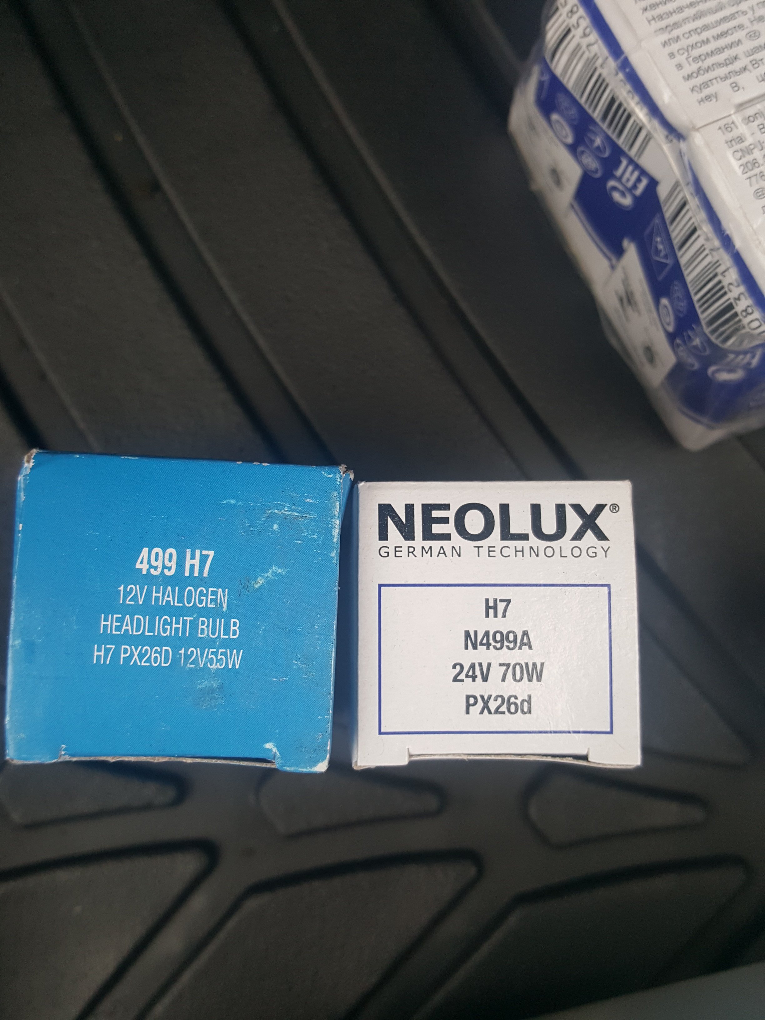

All fixed lads. Issue was bulbs i put in had not proper wattage.
in picture bulb box on right is incorrect one.
