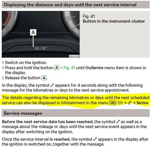

 Best look at the cars 'Service indicator' and see what it tells you.  Owners Manual tells you how to do that.

Check out the number of days / km's until your first service. If it's over 365 days or 10,000 miles (including those days / miles already covered) then you're on variable servicing....

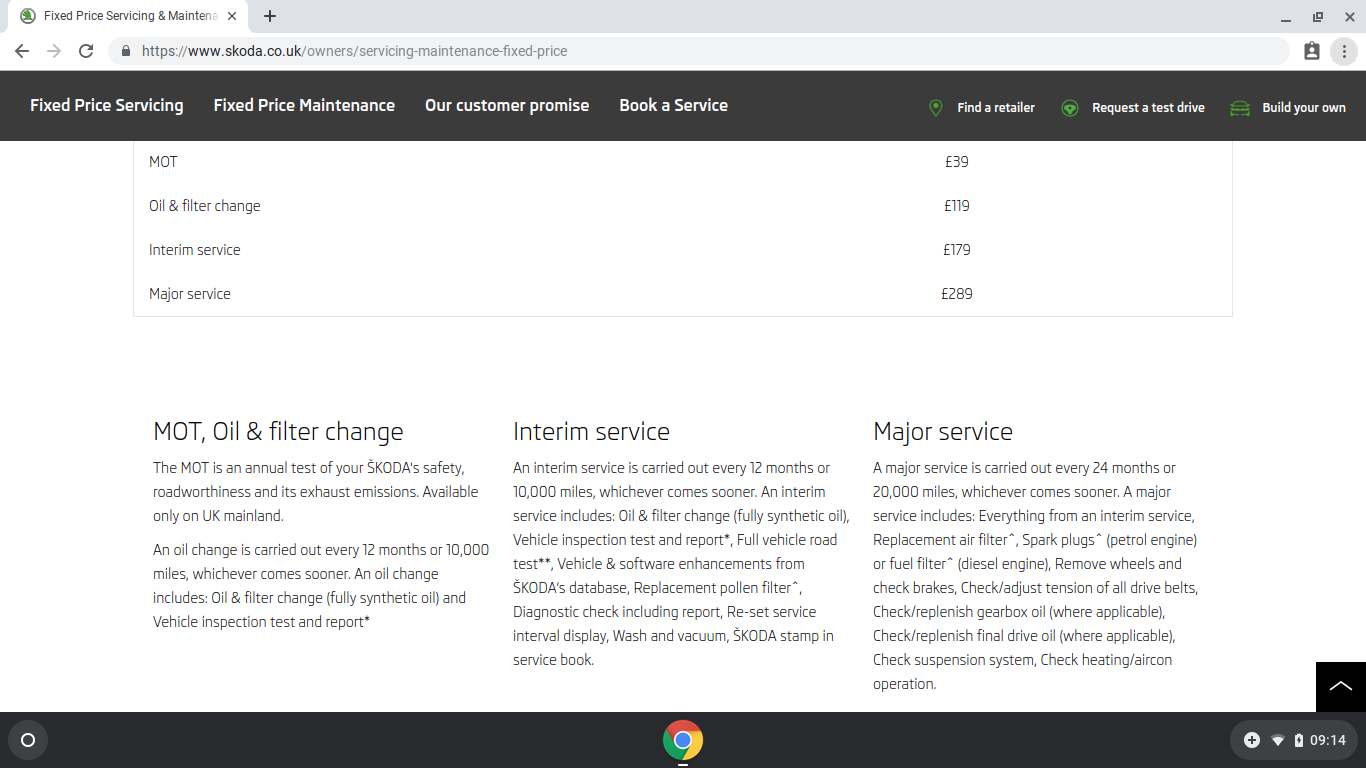

The next decision is whether or not I service it at a Skoda dealer. I don’t think I have to. Anyone else leading and care to share their service experiences?
Looking at Skoda’s fixed prices on their website it’s going to be £279.
Edited by Steve335
That price is for Major Services on cars 3-10 years old on fixed servicing.
  So £289 @ 4 years, ***  2nd Major Service & 3rd Major Service.**
at just 2  years old & 20,000 miles that is a rip off.
Your car is getting a 2nd Fixed Service at 2 years old, but calling it a Major Service is crap that Dealers like.
You are Getting an Oil & Filter change and the same as the 1st service and a Pollen Filter as an Extra.
You are not getting Spark Plugs Replaced, not even checked, not getting the Air Filter Replaced, not even inspected.
So you can get a Main Dealer Service, but do not pay the ridiculous price to not get parts, not get the labour, not need to pay VAT on Parts & Labour not provided
but yet they take the same £289 that would be charged if Plugs and Air Filter were supplied and fitted.
No wheels are being removed. So that is crap.
£289 makes that Free Wash & Vacuum very expensive.
**Be sure a body condition report is carried out and logged, and a road test. and you get the full report, play the Dealership if they want to get money for old rope for a Oil / Filter service, pollen filter and Health Check on a only 2 year old car.**

Thanks for the info - I’ll ring the dealer on Monday for alternatives. I didn’t realise that those costs were for older vehicles.
