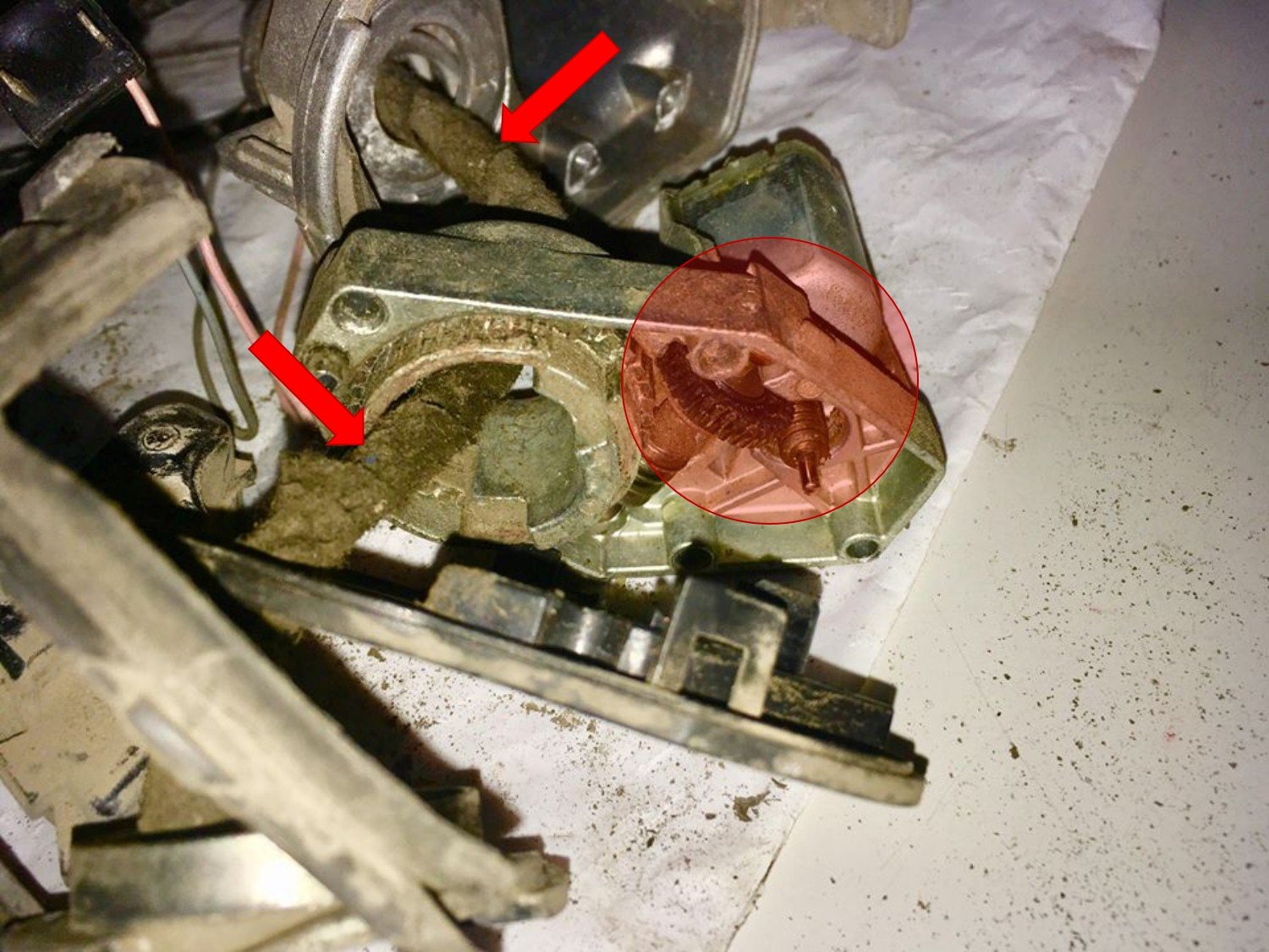

I brought everything (the two door modules, the mirror folding switch, and the folding motors). I unfortunately found out that I can't install the motor inside of my mirror as my harness (from non-folding mirror car) doesn't support it and the harness itself has to run through the motor housing circled base. So, I wonder if I have to purchase a complete folding mirror instead, or there is an alternative way to fix the folding motor inside my non-folding mirrors.
Thanks guys!
Edited by OsamaAtallah
Adding extra wires to the harness is easy.
The bigger problem is that folding and non-folding mirrors use different castings so you can't just move the motors. You need to buy complete new folding mirrors which should include the harness too.

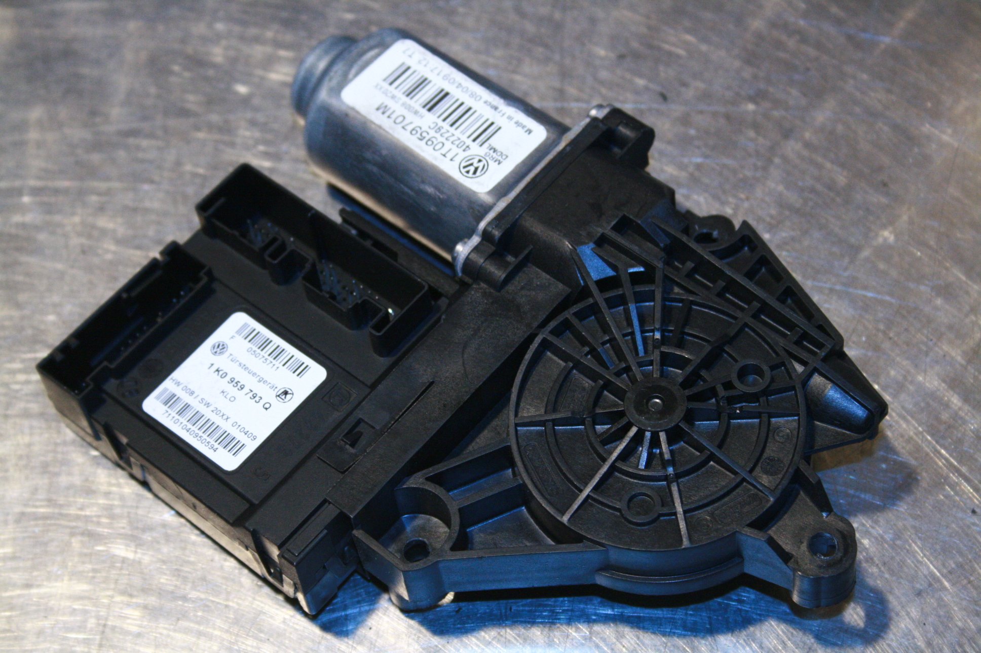

The motor presented in the attached photo is installed in my car, and I wonder if it is capable of folding mirrors or I need an upgrade.
Thanks!
That part number (1T0959701M) is mentioned in the first post and is not compatible with folding mirrors.
