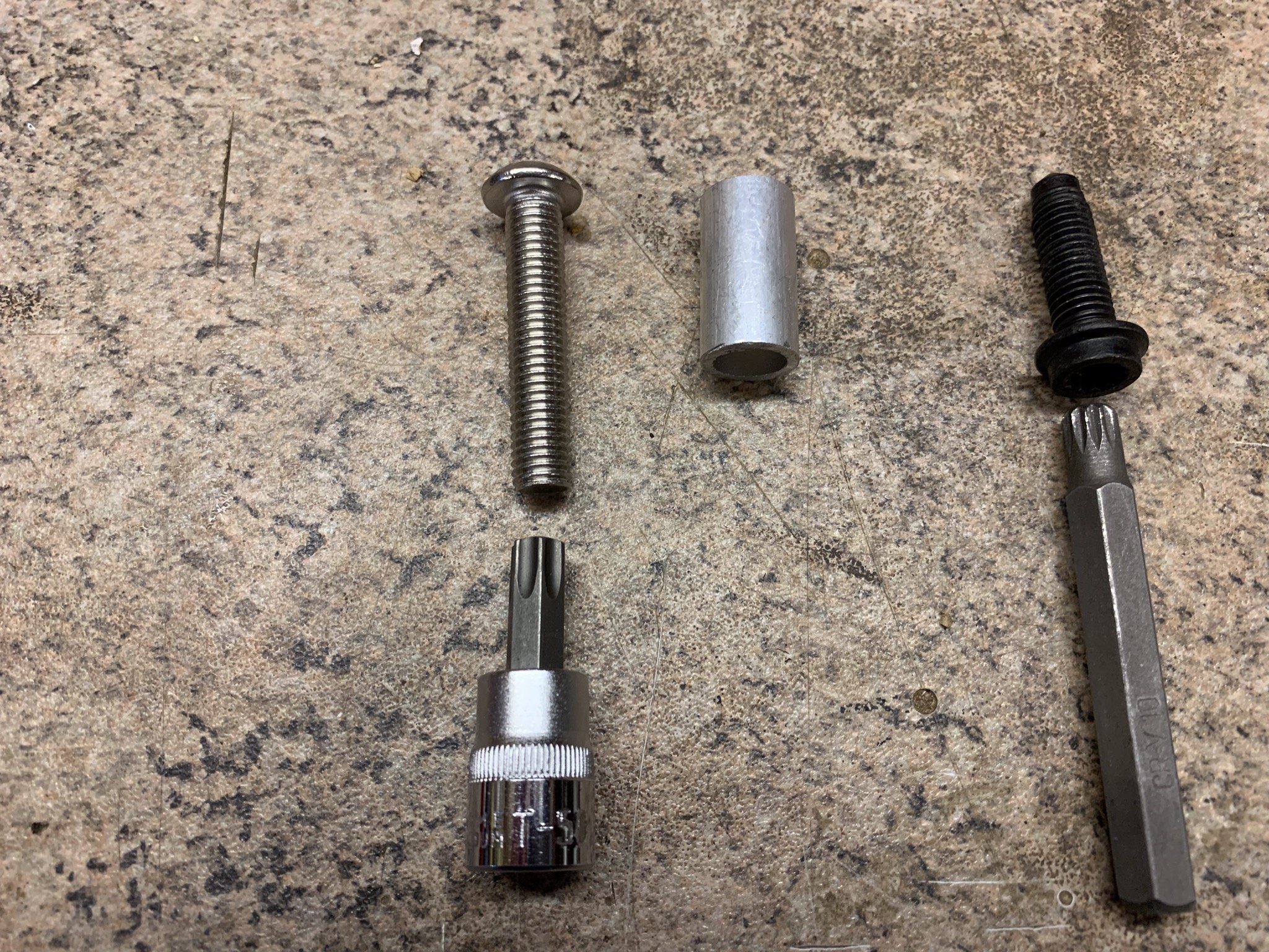

 It’s the one on the right. I did this photo for the Karoq forum but as an ex Yeti owner I know the bolts are the same 2A39373D-70D8-4A4A-A4CA-681F01EC0ADB.thumb.jpeg.69a9c8d5759d8b95df9ff69438f4b700.jpeg
Edited by 33q
Detail added
That's a great help! can you confirm it's a 10mm spline bit?
Confirmed
you can get away with a T50....the one on the left....but correctly you need the spline. Ebay is your friend
