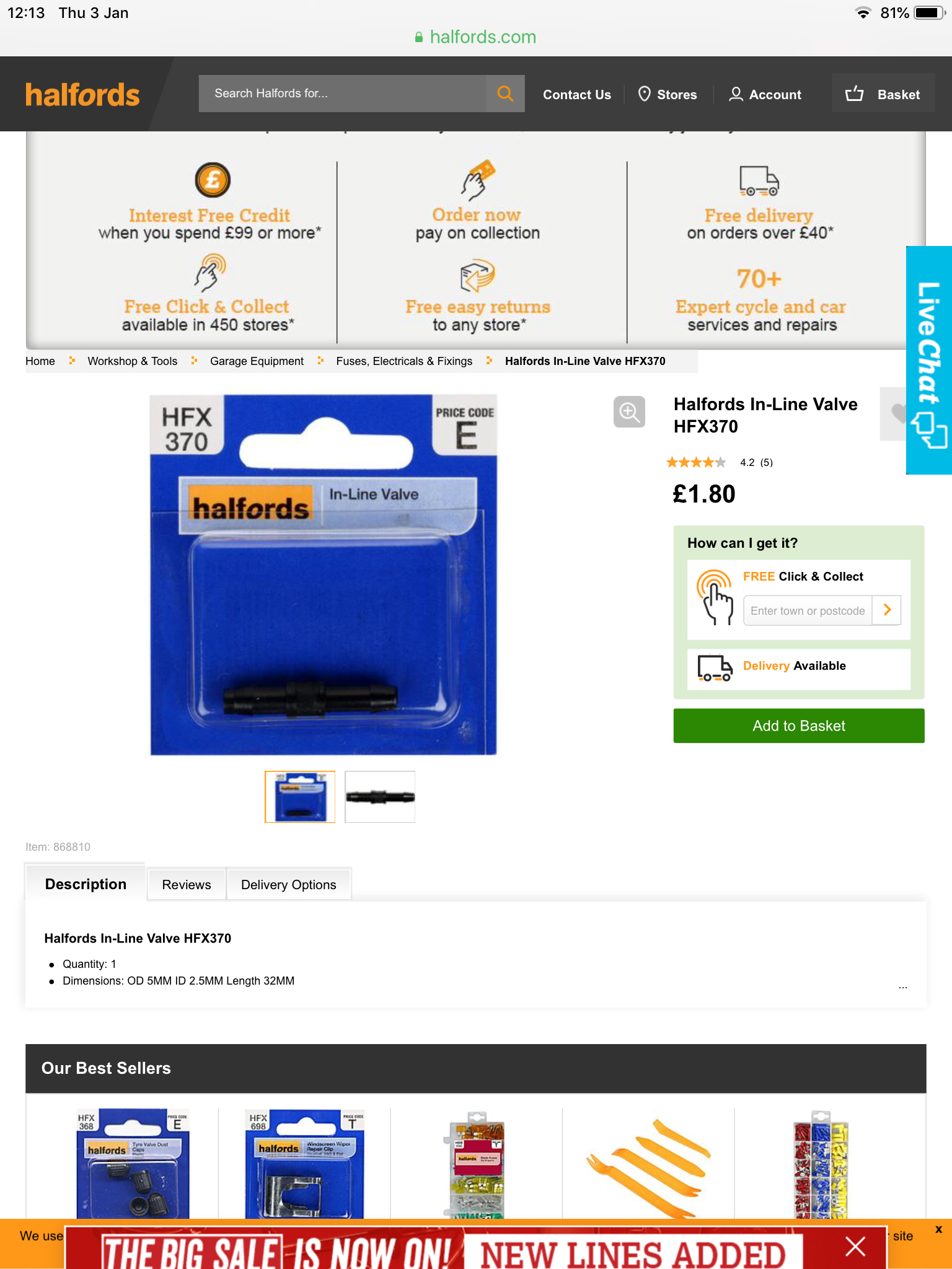

What does a £50 checker valve do?
Same as this I presume.. But why you would need one on a new car beats me.
Edited by Kenny R
But what does it do, over and above the current factory set-up?
