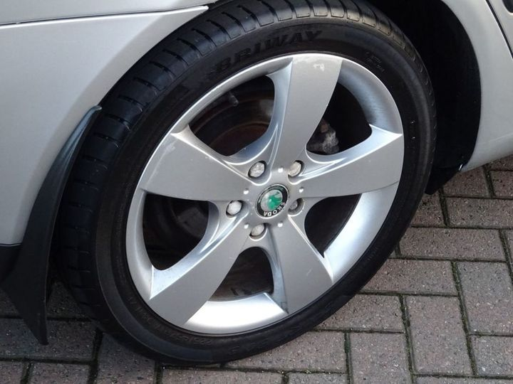

I'm in the market for a new (used) car, and one of the MK2 Octavias I'm looking at is on 17" Alloys - see photo below. I'm really not a fan of these though, and I'd prefer 15" or 16" wheels for a better ride and to save money on tyres.

The alloys on the photo is original Skoda, delivered on Octavia Mk2. They are called Pegasus. This is good, suitable alloys for this car. Be aware if you buy aftermarket alloys, they may have different hub center diameter, different nut contact face and deviating offset, so you really need to know what you are doing to get suitable alloys. On the other hand, original Skoda alloys from Octavia Mk2 (obviously) + Mk3, Yeti, Superb Mk1 + Mk2 will fit without issues.
The original variants of tyre dimensions for Octavia Mk2 are:
195/65-15, 205/55-16 and 225/45-17. If you fit one of these on appropriate alloys you are good to go without any further issues. No need for recalibration or garage visit. If you go for different tyre dimension the overall tyre circumference deviate from original setup of the car. It may not be critical, but again you must know what you are doing to avoid issues and legal/insurance complications.
