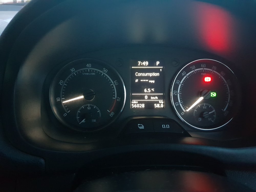

Hi and thank you for your time reading this. We have a skoda fabia vrs 2011. In the UK the car sat for over a week over Christmas then on getting back in to it we noticed the fuel and temp gauges indicator pins don't light. This wouldn't be an issue in daylight but at the moment early starts and late homes you cant see them in the dark. Contacted our garage who said the can't do anything. Contacted skoda who said £50 to look at it and then said without looking at it it will prob need whole new instrument panel at a cost of over £1000! Our garage said if we get a second hand one they can fit it but what happens with the mileage etc with a second hand one and is it really a whole new panel because two indicator pins aren't working? Is there any way to get into it to replace bulbs or something?

It'll probably need a couple of SMD LED's soldering or replacing.
 Thanks guys we will try the battery thing at the weekend and go from there. Finally managed to get a picture. The two small dials needles should be lit like the big ones.

Totally different dash to mine, which are the LCD type, with a thermometer glowing blue when cold, red if overheating and nothing for normal but still, don't rule out removing the battery terminal. At worst, you will have to re-set the windows, at best, they might just come on again!
