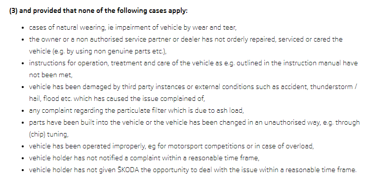

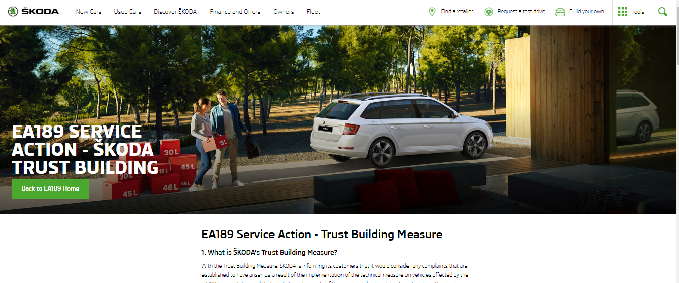

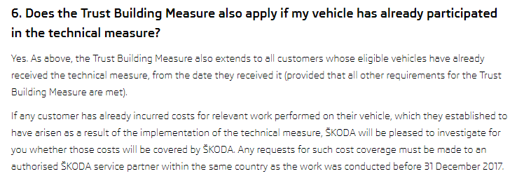

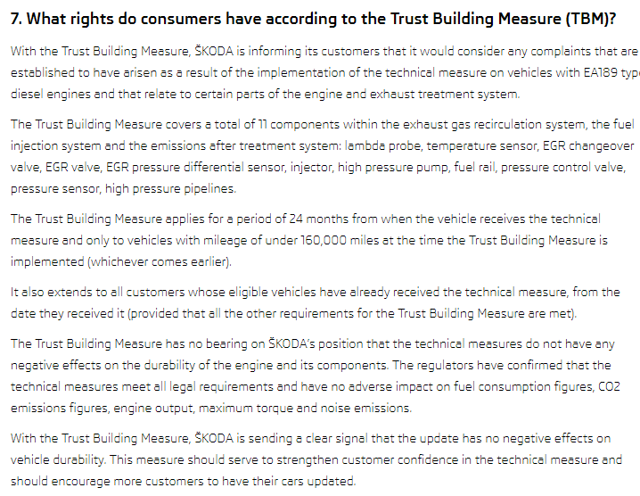

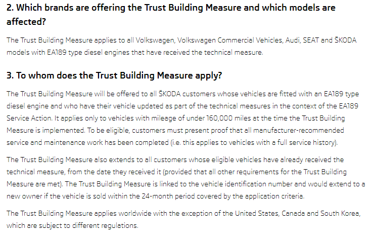

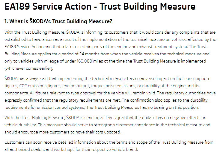

Your car has been subject the EA189 emissions fix - the big 'dieselgate' scandal that has tarnished Skoda's reputation for years to come.
But, for you this is good news. Skoda has since set up their 'Trust Building Measure', basically a warranty on all fuel and emissions system related components, including the injectors.
As long as the car has covered less than 160,000 miles then all of this hassle is covered under warranty. Take a read here...
https://www.skoda.co.uk/owners/ea198-trust-building-measure
Perfect, will read in a bit.
Yes, that's what they said under that warranty,
It's only done less than 40000 miles

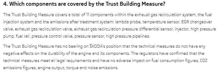

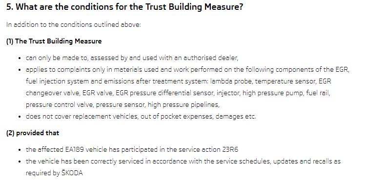

Indeed :- "The Trust Building Measure covers a total of 11 components within the exhaust gas recirculation system, the fuel injection system and the emissions after treatment system: lambda probe, temperature sensor, EGR changeover valve, exhaust gas recirculation valve, exhaust gas recirculation pressure differential sensor, injector, high pressure pump, fuel rail, pressure control valve, pressure sensor, high pressure pipelines"
Trouble is not sure it wil cover engine or turbo - you might get goodwill though under the circumstances.
