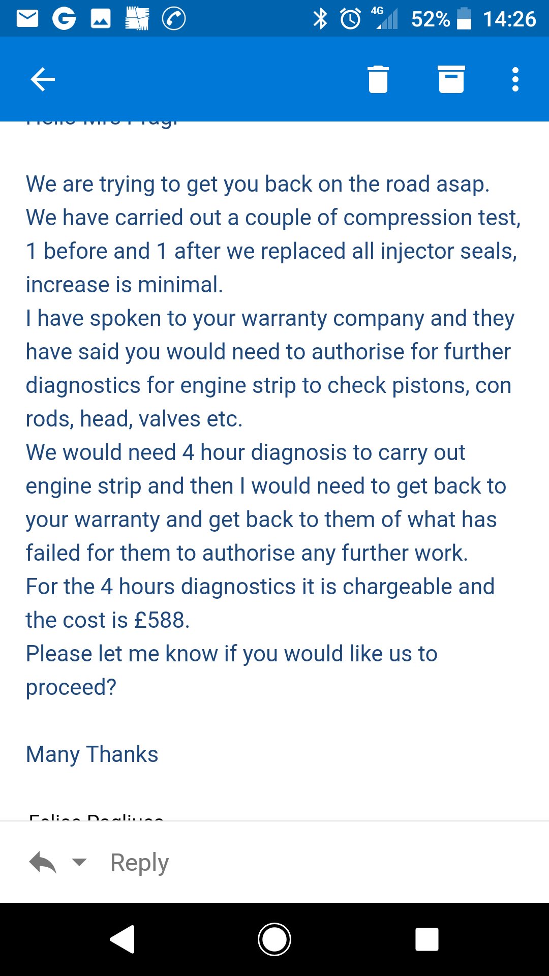

Hi
Thats they reply I get today
So they have done all that under my warranty, nothing is mentioned about trust warranty
I am confused..
17 hours ago, bigjohn said:
Hi
I am confused..
