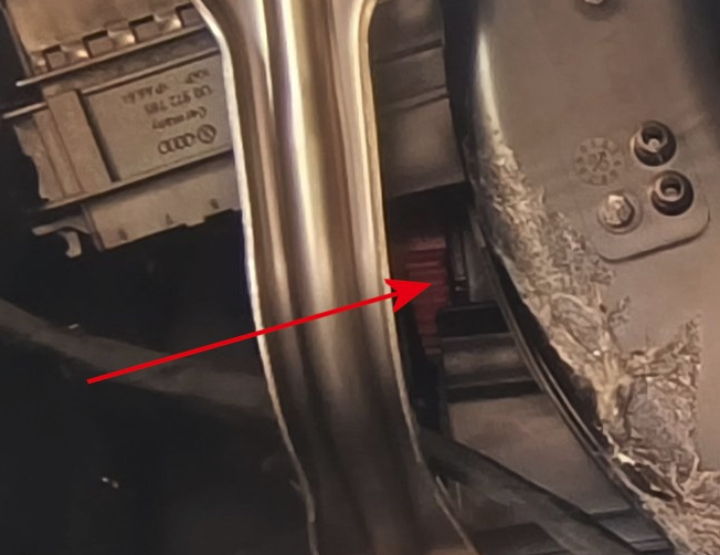

  1. No reservoir is a good clue. Here's a pic of the hydraulic installation; the pipe connections to the steering unit should be obvious, too.

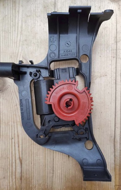

  8. Near the edge somewhere as I recall. This is from a Kodiaq. Wouldn't have thought there was much of a pattern part market for windscreens but what do I know.
