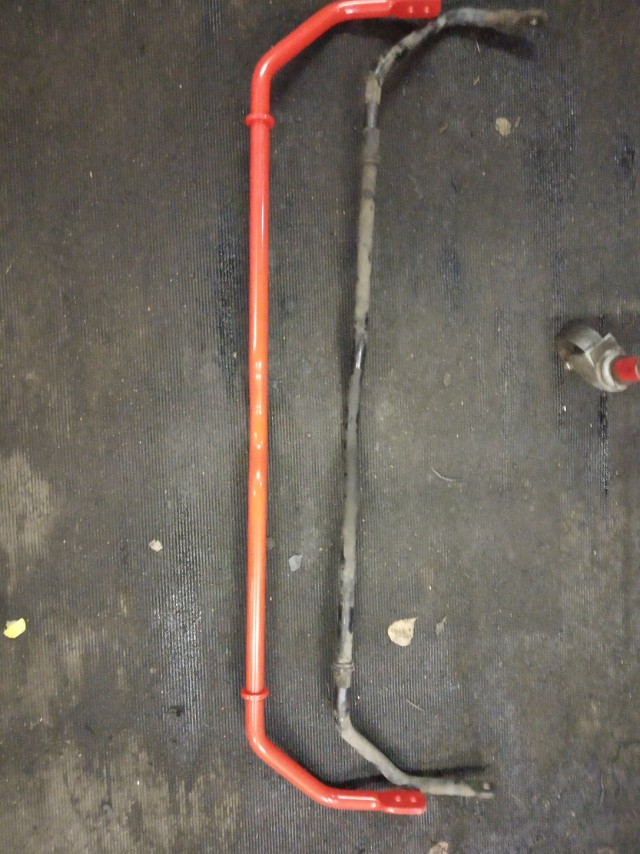

Here is the difference between front ARB.

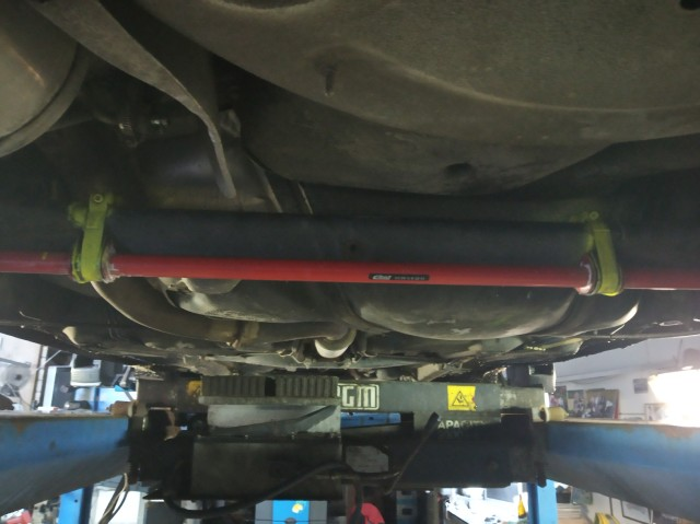

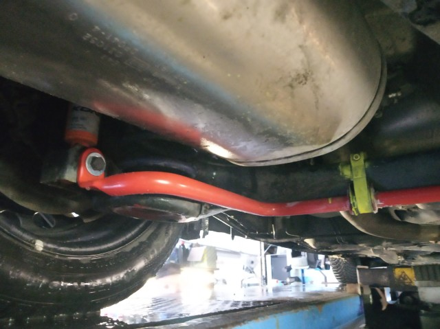

Here is the back ARB fitted.
