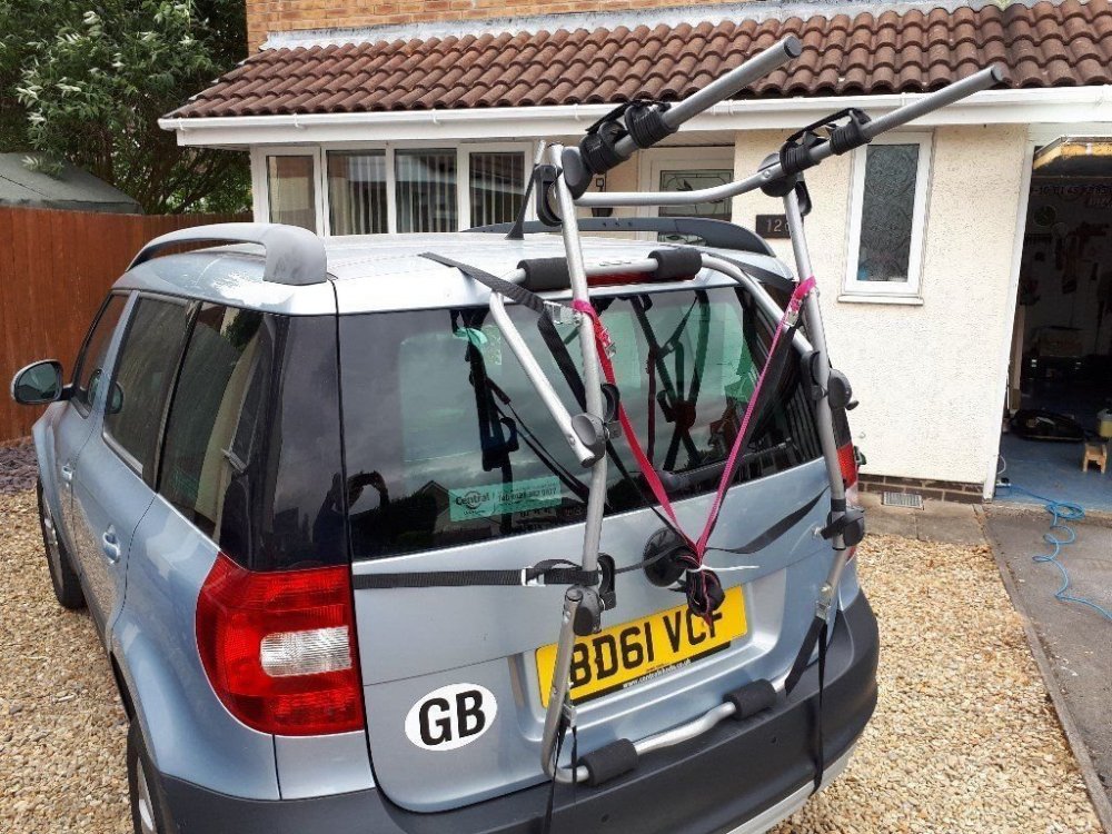

Yes 2 adults and two children's. I am thinking a tow bar will be far too expensive. Maybe a high rear mount but not sure if I can find one that does not block the lights and number plate.
You need electrics & a Light Board then..
4 bikes on a rear rack is a bit much even with the foot on the bumper.
As to the Tow ball / bar nose weight it is 80kg so that is not really a problem.
Yeti picture pinched from another thread.

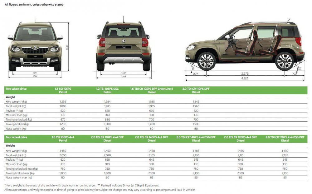

Except that is more than the recommended tow hitch/nose weight for a Yeti!
Edited by Llanigraham
Just as well it is the Recommended weight then.
I know you do a lot of towing Graham.
This is indeed a bit of a grey area, I enquired and was advised by wittter, the  towbracket (not the ball) can safely carry a straight load greater than this and that the load I intend to carry is well within limits and I could have 10kg more. Though this info is not published as the different applications are so variable  and I have some evidence to cover my a*$e.
The nose weight is a weight fixed by the car manufacturer and will always be less than the maximum weight limit of the towbar. I note that Westphalia state that the weight limit for their fixed tow bar is 150kg and 100kg for the removeable one. As stated the nose weight for the Yeti is 80kg  and certainly in the caravanning world is one you try not to exceed, and you are doing so, and by 5%. Your "evidence" would only show that you are not exceeding the towbar manufacturers limits, not the car manufacturers.
Now whether that is illegal or not, I do not know, but I do know that the Police and DVSA Inspectors have tested vehicles at spot checks and have impounded vehicles and trailers because of it, and have made caravanners reload their caravans to attempt to bring the nose weight down. There are also insurance implications. The car nose weight limits are based on the maximum weight that they consider make it "safe" and exceeding that limit could be considered making your car "unsafe".
