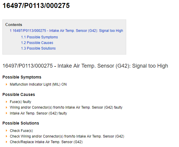

Both codes refer to out of range voltages coming from the boost air temp sensor & boost air pressure sensor that I belive are located in the same sensor that you have already changed.
So would appear to be either a bad conexion on the plug, or the wiring back to the ECU is defective or has rubbed through against some earthed metal somewhere.
Seems there are two sensors, G31 and G42...

Your code is usually the turbocharger boost sensor
Usually a faulty MAP sensor on the PD engines but as you have changed this already rules it out or the wiring is still not correct
i have seen the wiring going hard further up loom and when engine is moving losing signal
